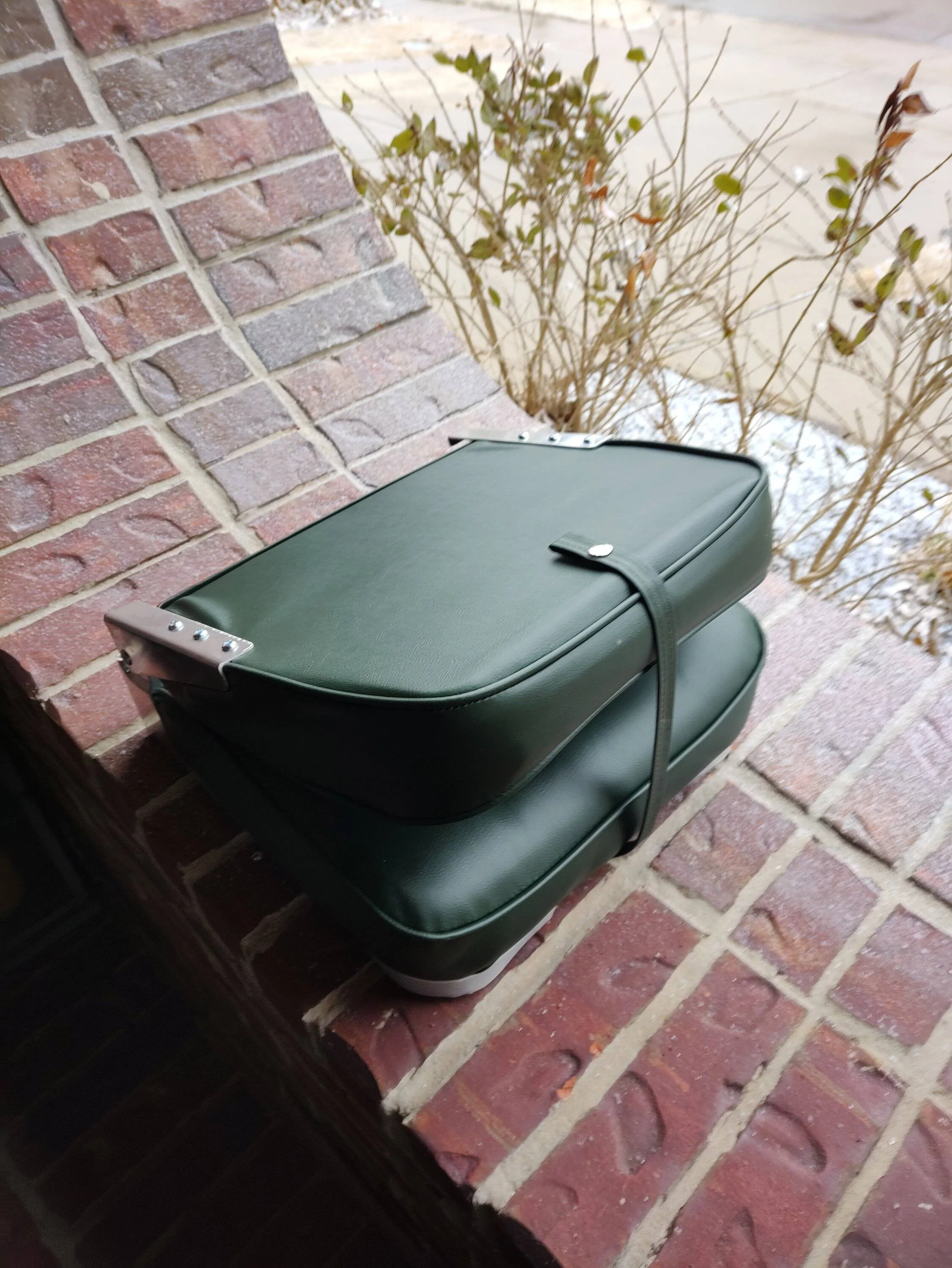

Finally got enough Amazon gift cards from my work to order one of my two rear seats. They're temporary seats until I put forth the money to buy proper Captain's chairs.
I primarily bought this one because it was one of the only ones I could find in as close to an army green as I could get. If it wasn't already obvious they are marine boat seats. Not sure it's going to pass DOT standards, but it's really not going to be used very often either.
My next steps will be to make my own aluminum bracket for it and to buy the lap belts I will be adding to it. I might not start that for a while though because I'm trying to save up for a $1,000 purchase. Not that I don't have the money, just that you try convincing your wife why you need to do something that will void your engine warranty before you even hit 20,000 mi. The end result for me was that I can only put $50 a week towards my thousand. And that got me a blessing. :LOL: ?

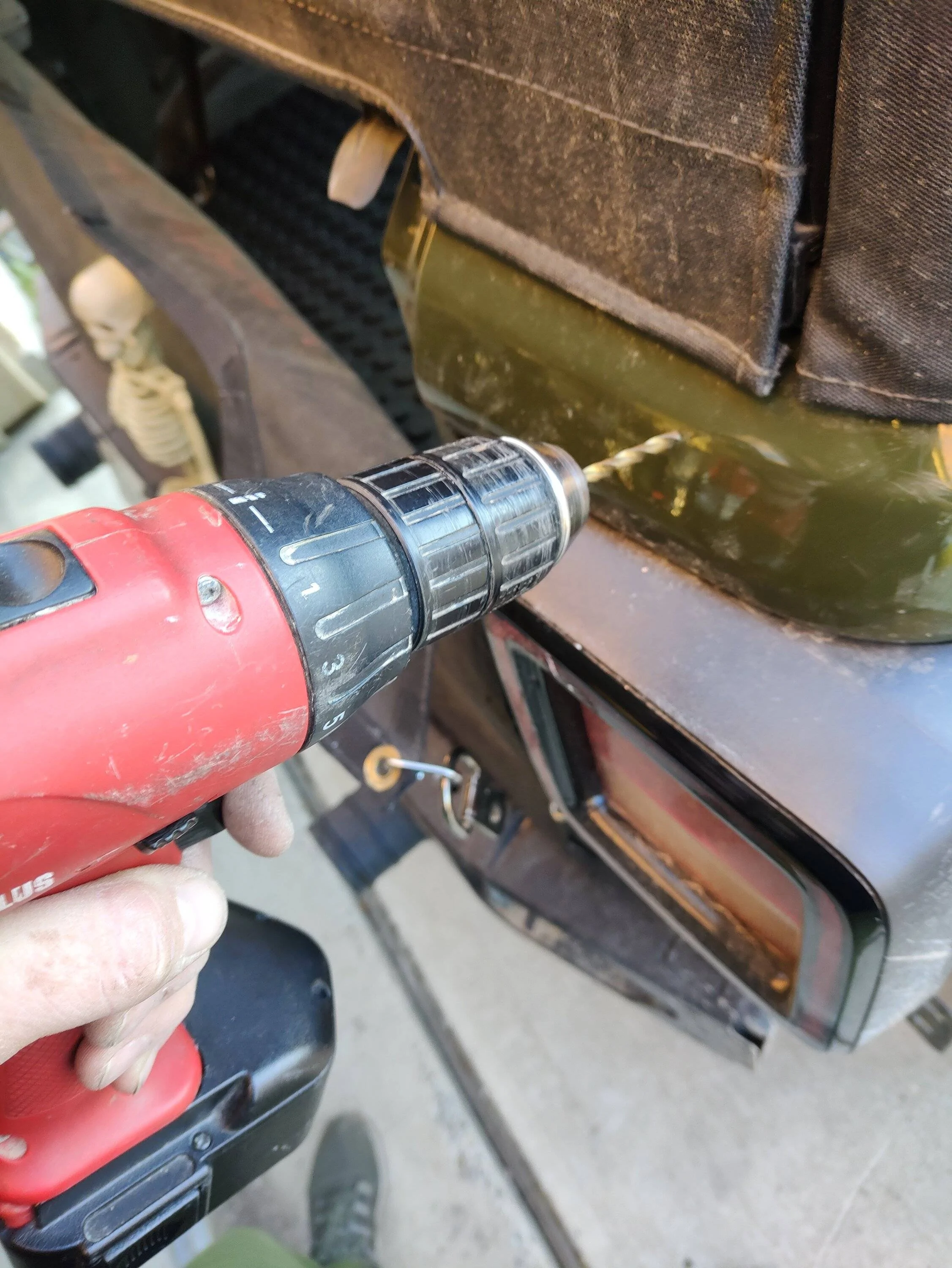

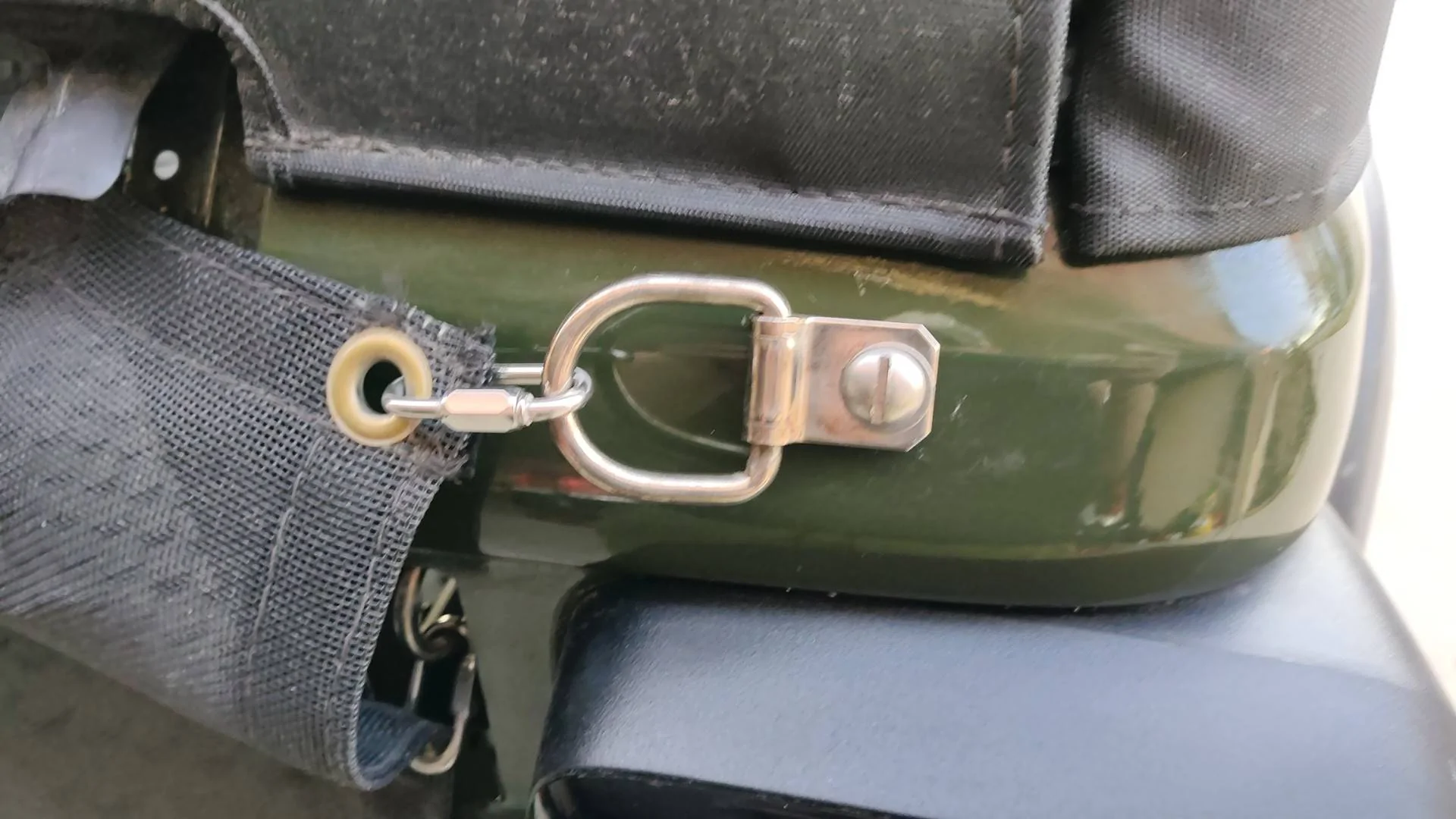

I've been trying to figure it away to make the tailgate netting look good without being wrinkly. Ever since I put the soft top back on (which I plan on keeping on for a while, Maybe even throughout summer) I've been trying to figure out a way to rig up the top loop so that it's more taut.
I was messing around with it yesterday and figured out a way to do so.
You don't know me by yet, you should know...

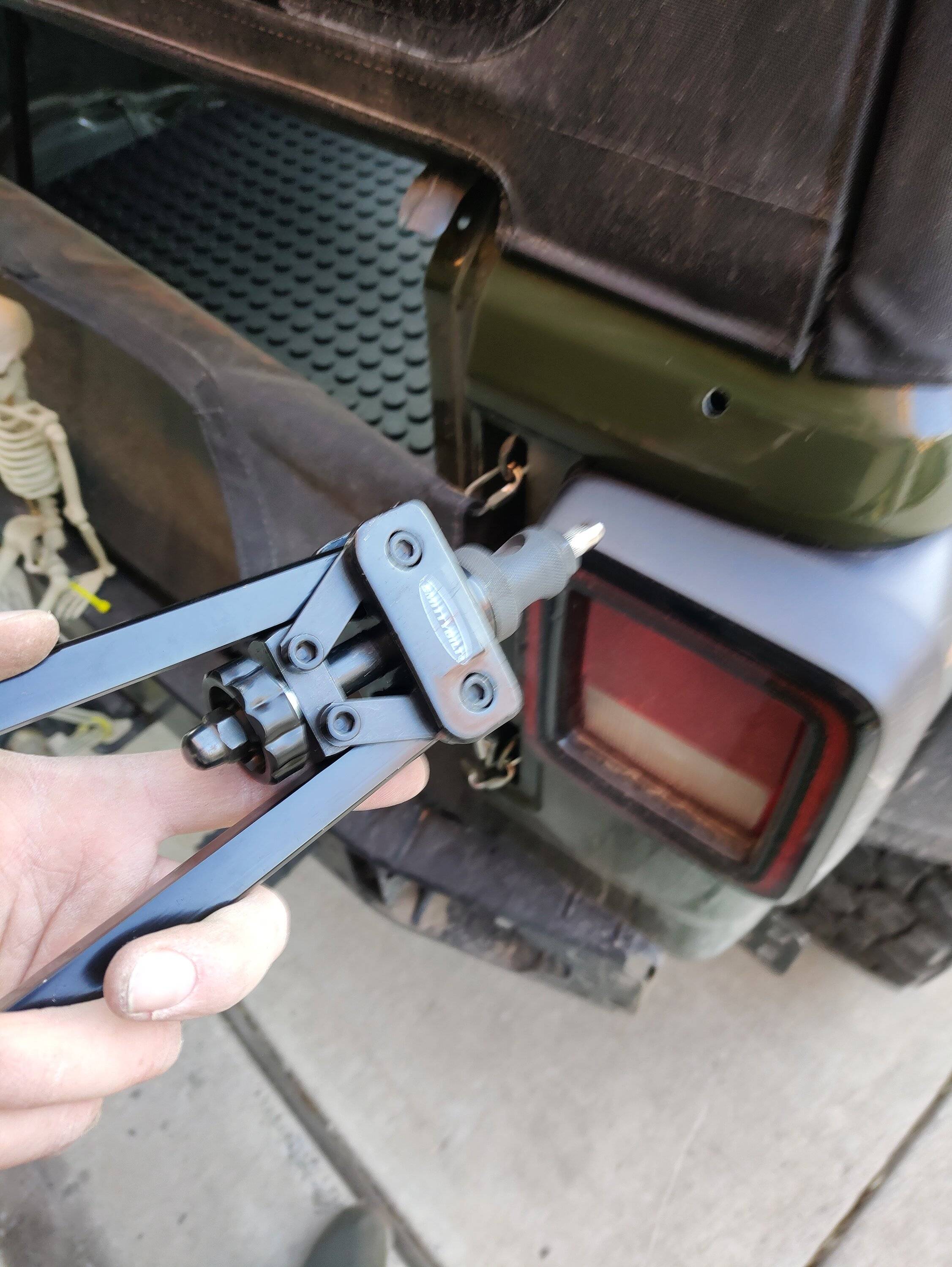

This is how it had to be, ANOTHER HOLE BABY!!!!
I should probably note that I have this Walmart bit set then I got for $20, came with I believe like 20 drill bits and 50 other screwdriver style bits and 30 other things that I don't use. I've gotten more use out of this drill set than anything else. Strangely enough I'd much rather go and buy another one of these sets and just keep breaking these drill bits than spending $50 on a good drill set.
Finding new mandrels for this Smittybilt Nutsert Tool nigh impossible. They say it accepts most mandrels, but I find that to be bullshit. Though not this 1/4-20 mandrel which came with the set, I had to make my own 6 mm mandrel last summer with my dad. Technically all we had to do was drill a hole in it which was difficult enough and pray for the best.
That being said I've probably gotten more use out of this one tool for the Jeep then any other tool I've purchased recently.
At this point I probably say I'm a pro at putting these nutserts in. These ones happen to be stainless steel, for all of my exterior holes.
I need to get different screw in there. I'm not normally a fan of flat blade screws, they can be a real b**** to take in and out. I would like to get something with a torx bit center. Probably hit up the local hardware store a little later today.
The outcome is nice though, there is some sag, but there's always going to be some sag, the world isn't perfect you know. ?
If the sag bugs you… I might have an idea for you: how about using a cut curtain rod or similar and attach to the length/across of the top of the net? Could mock it up with zip ties and of you liked it/it worked you can come up with sth more permanent.
