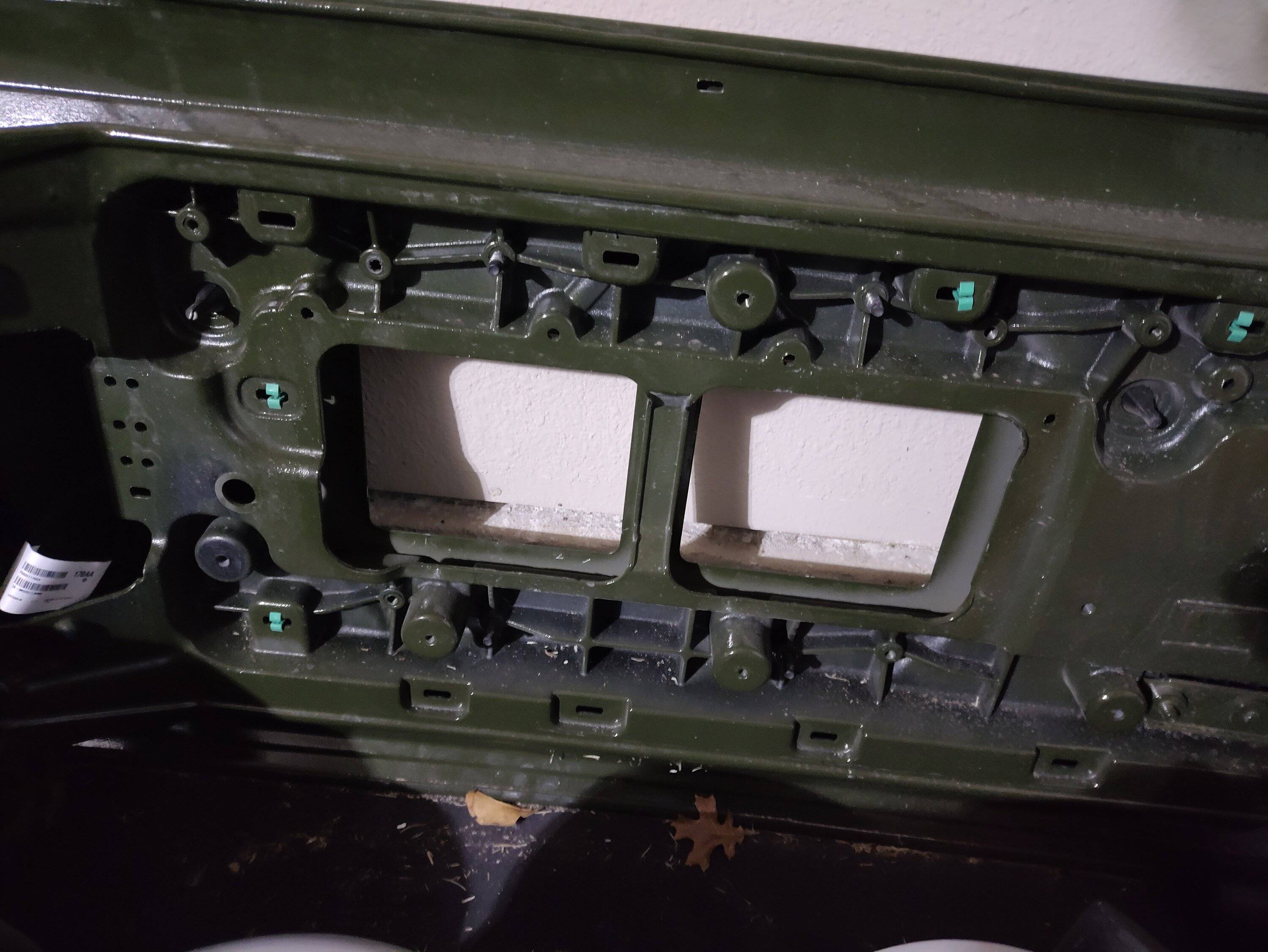

While I do enjoy having no tailgate, it makes seeing behind the Wrangler extremely simple. I have a thought as to how I can obtain a similar level of visibility. The question becomes how much do you really need to see behind you to know where your vehicle is?
Will two holes this size suffice?
Time will tell. My plan is to put a piece of either polycarbonate or another type of transparent plastic sheeting over these holes acting as a window to the past!
I have a couple of projects that I never quite finished on my tailgate. Also this being said, I have a project that I haven't finished on the mesh tailgate netting either. To do the project on the tailgate netting I'm going to need to remove it as well. So in the meantime, I think I'm going to get the plastic covering, put some fancy holes in it so I still have the airflow needed for these vents, and then mess with the mesh tailgate at a later date
Are you cutting view holes into the tailgate?

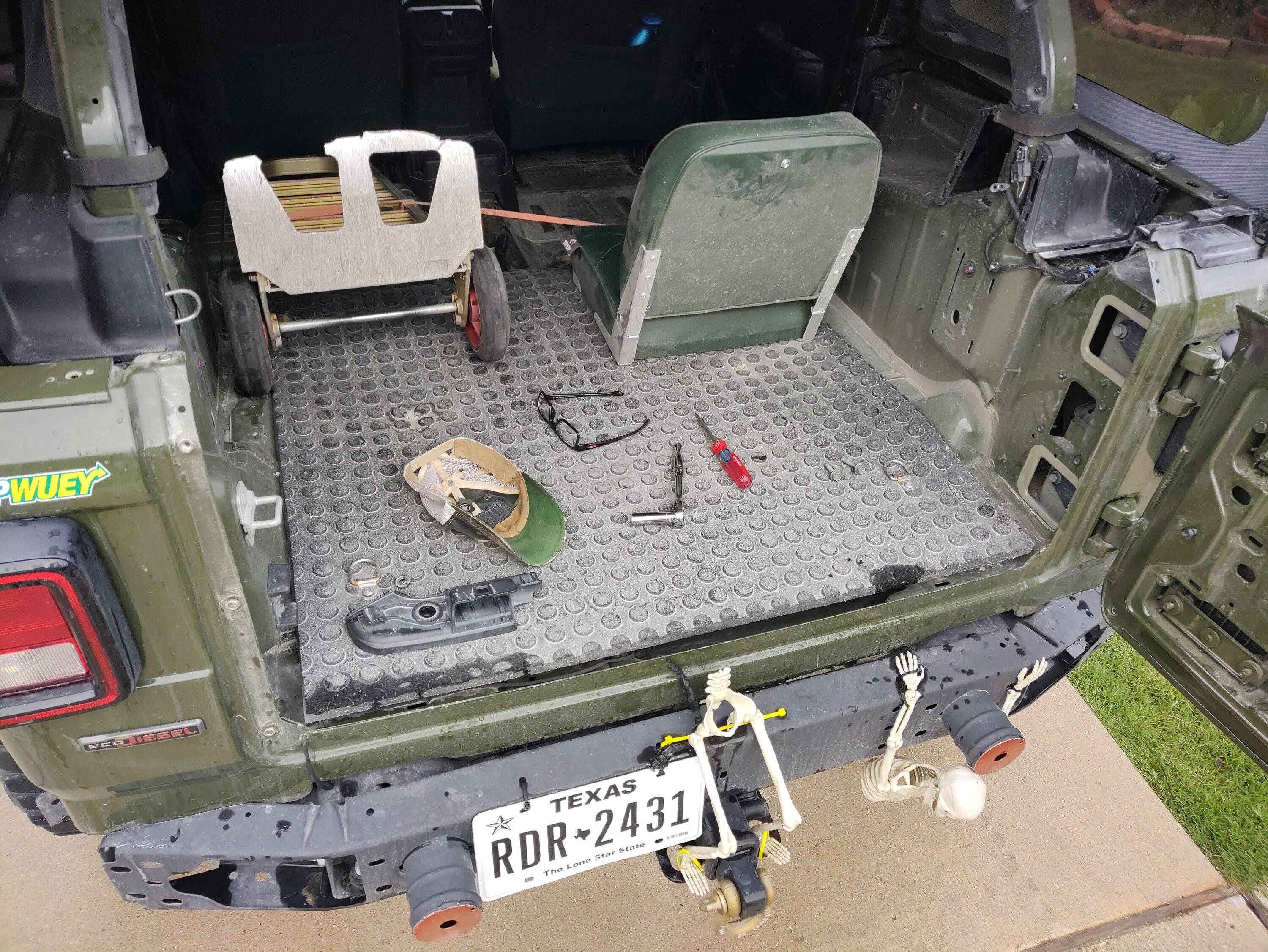

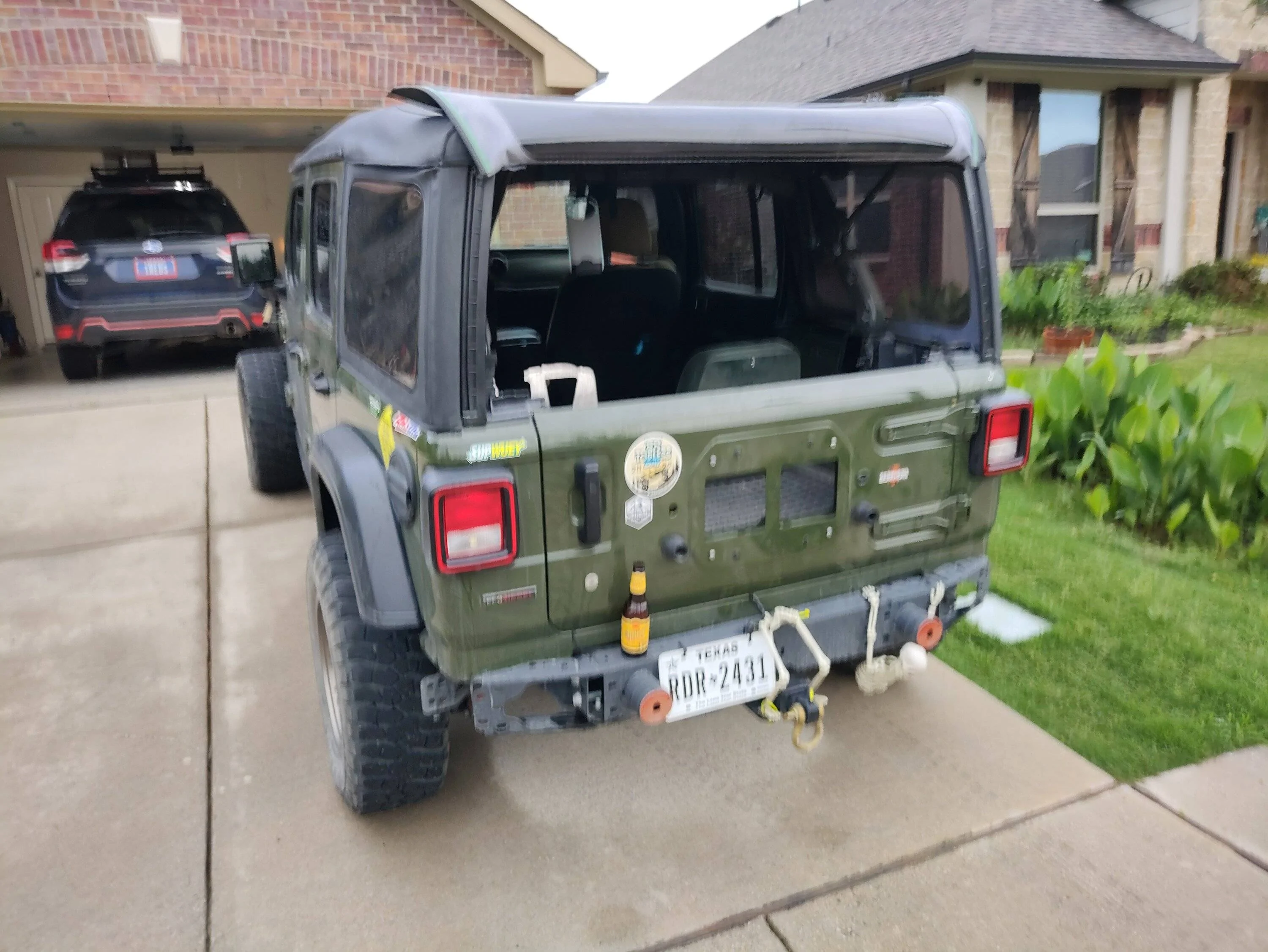

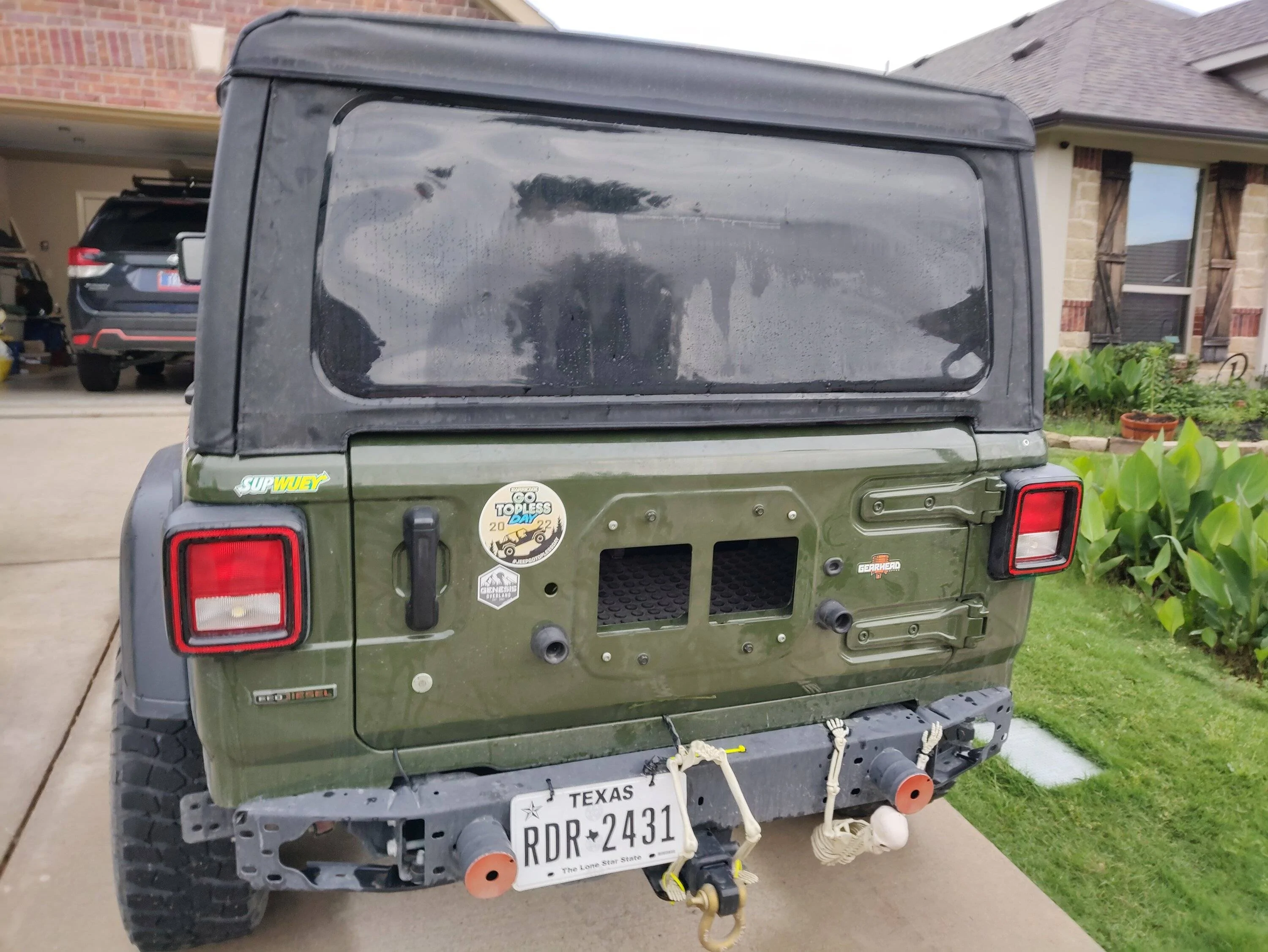

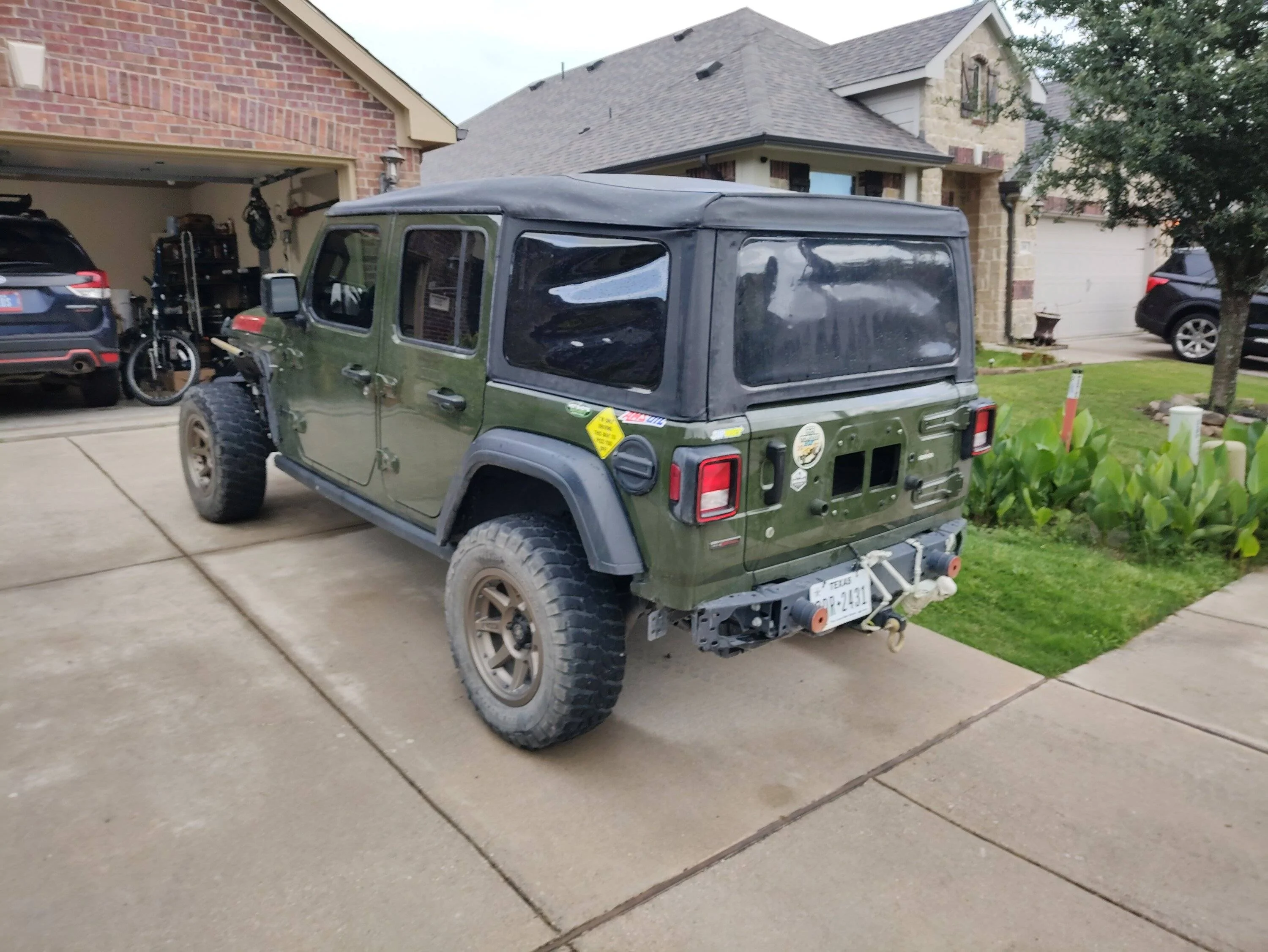

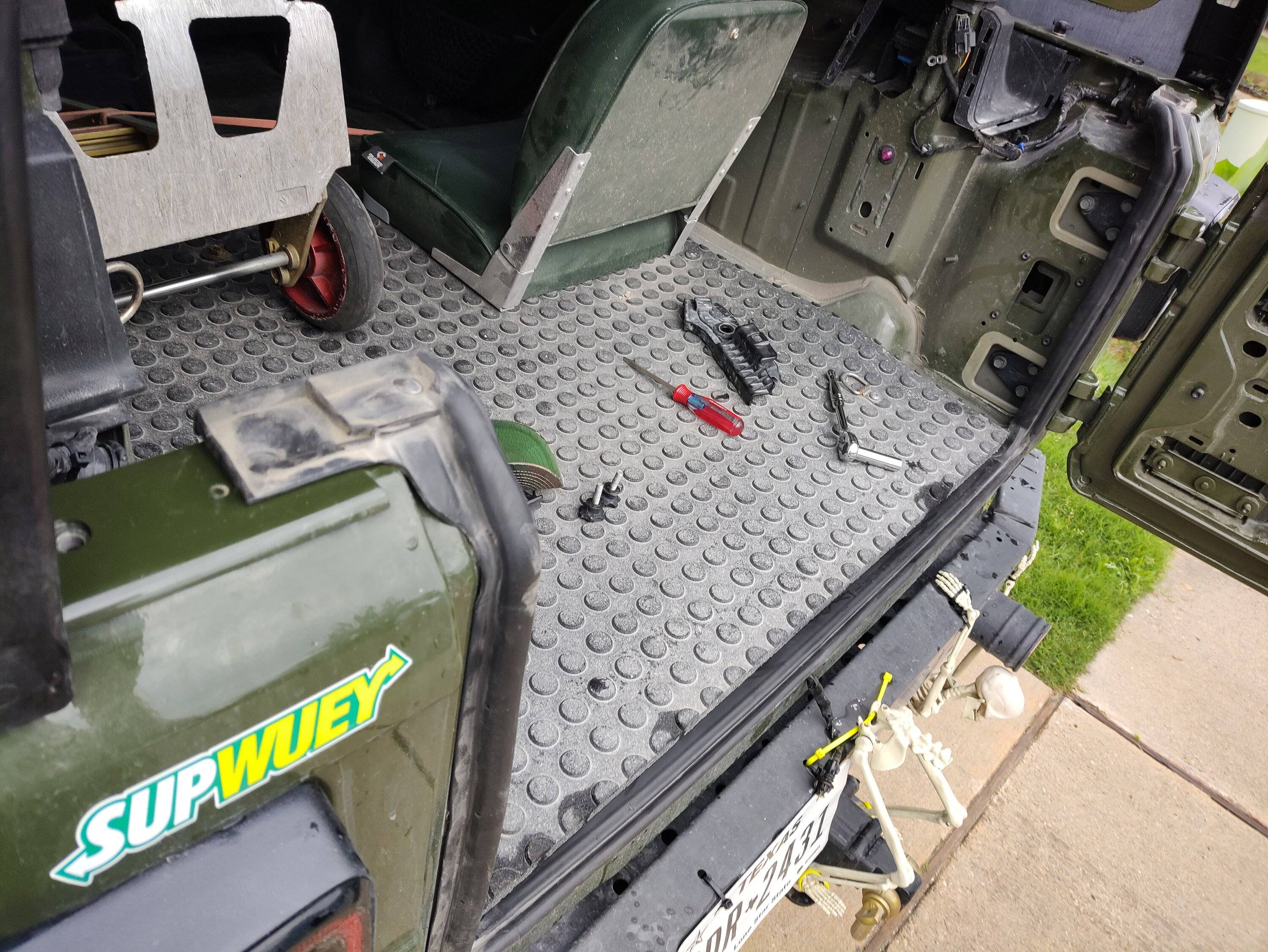

Tailgates back on. Honestly I remember being a lot more heavy than it was. ?‍♂
Thankfully I keep a lot of the important parts like weather stripping.
The weather stripping actually closed up the gap from the horse stall mat pretty well.
It's been a while, so I forgot that the soft top rear window goes down before the tailgate closes. ??
Honestly it looks a little too proper if you ask me. I'm going to have to invest in a big obnoxious sticker for the back window. Any recommendations?
(Definitely going to have to keep it on the non-profane side of things, as much as I'd like to have a big purple cock on my back window, I don't think that would work out too well for me)
@Jeepeto 31 holes. This one is for a drink holder project I'm going to finish now that the tailgates back on.

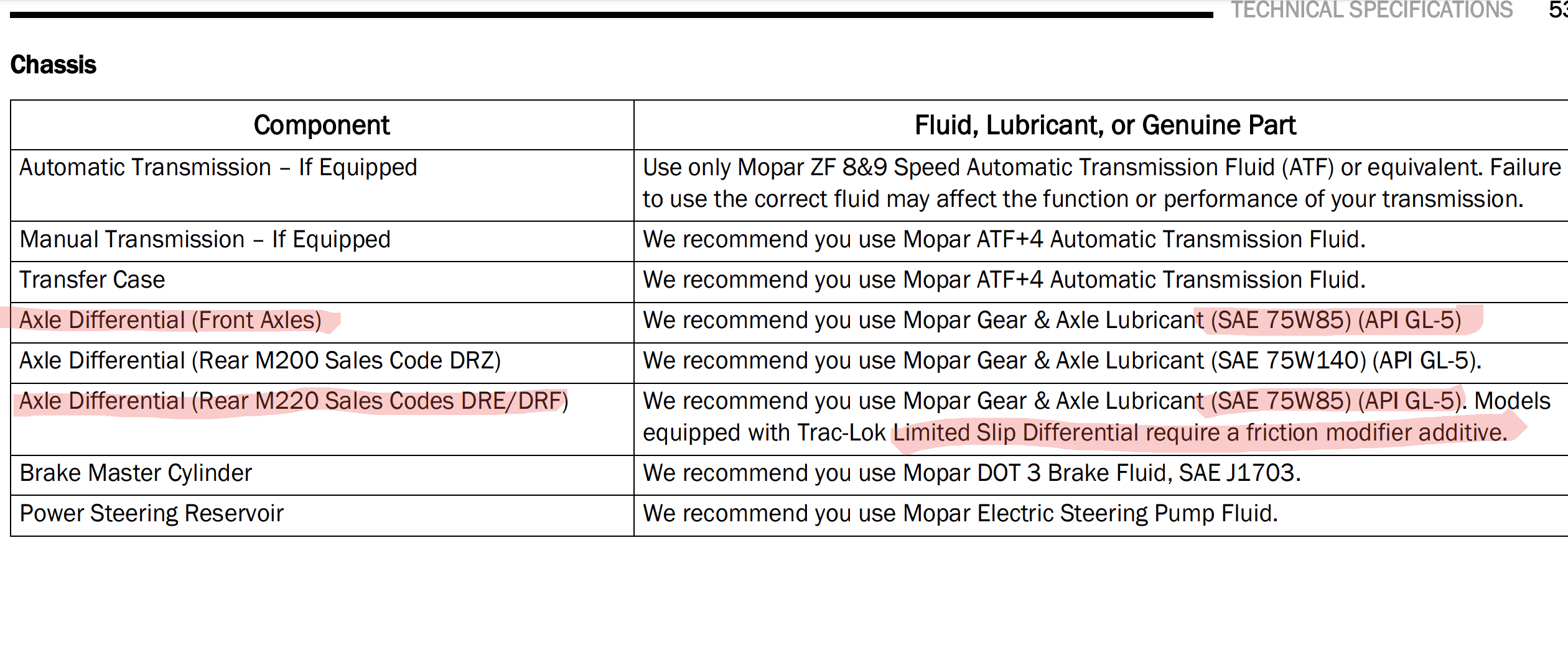

Really was only ordering the 75W-90 differential fluid for the m210 front and m220 rear. But as with Amsoil, that free shipping sure is nice. Been meaning to get some more fuel additives for the wife's Subaru Forester, so got it up $100 got that free shipping.

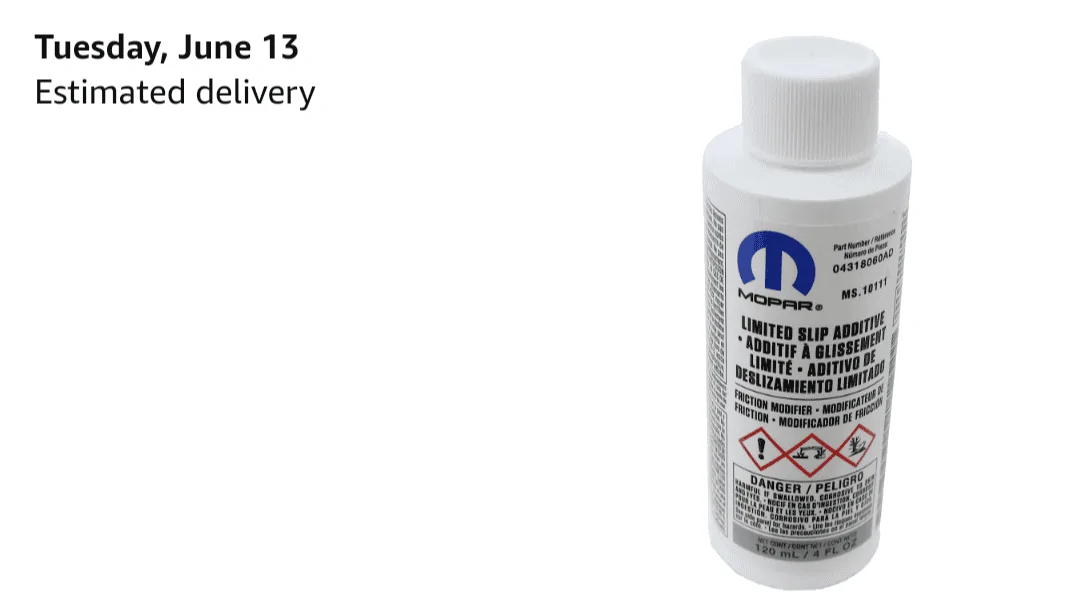

Ordered this guy too, for the rear limited slip.
Probably won't do the procedure until we get back from our vacation near the end of July. Honestly this will be my first ever DIY differential fluid change, so the whole process, even just looking up what I need to use is kind of nerve-wracking.
Did a little bit of research before I put in my order:
Got to love this forum, so such a wealth of information.
Just for info...not saying you need to do anything:
DS Front - https://d3qx1uccksbb2n.cloudfront.net/docs/SPECSHEET-JL-FRONT-UD44A-42019.pdf
DS Rear - https://d3qx1uccksbb2n.cloudfront.net/docs/SPECSHEET-JL-REAR-UD44A-D44A-42019.pdf

Those may be true for the normal Dana 44s, but this one is specific to the diesel Dana 44s:
The "normal" D44 axles specify the same--there is nothing unique to the diesel. My point is that Dana states 75W-140 and FCA reduced the viscosity from that in the quest for more MPG.
Just for information...

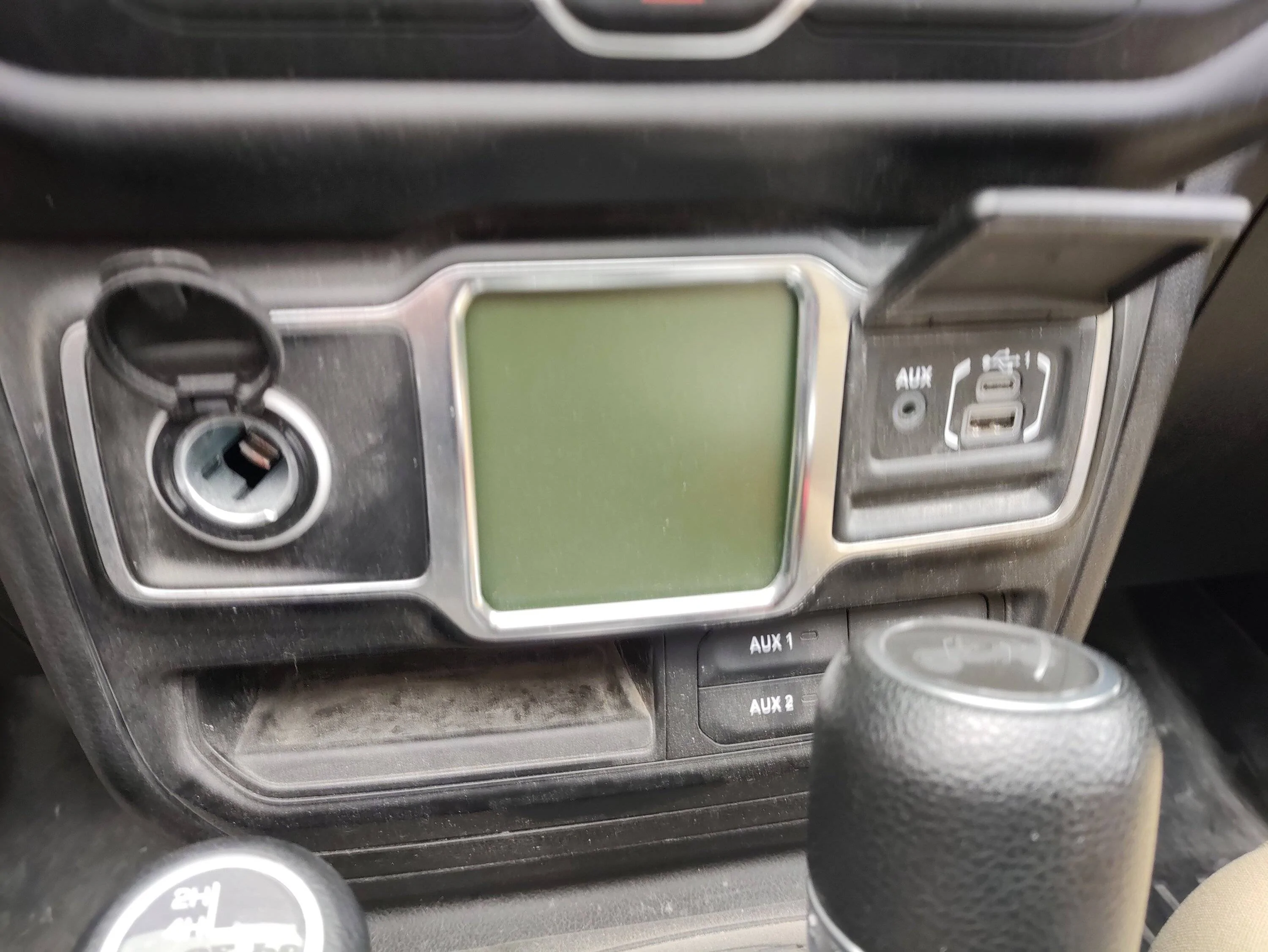

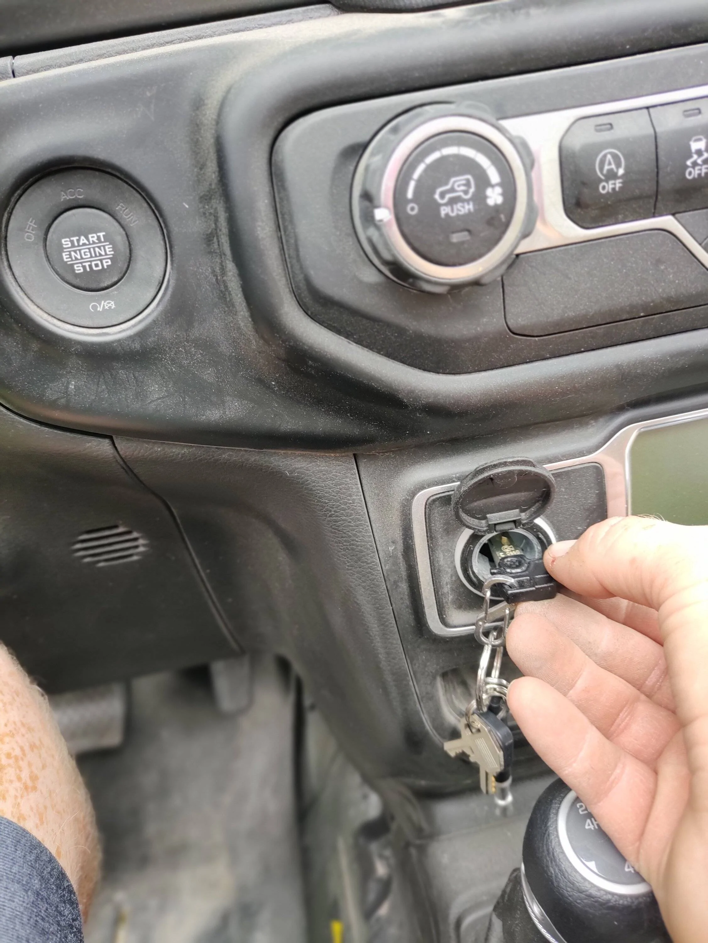

So y'all probably know at this point that I've been wanting to do a ignition switch, or a fuel pump switch to make my Wrangler even harder to steal. I've even thought about putting a keyed point in the steering column, which as an added bonus would give my keys somewhere to hang so that they're not in my pocket.
While I was poking around on the internet yesterday, I found this guy:
It's a 12 volt surface mounted keyed battery kill switch. It made me think about where I could install it?
I don't know about you guys, but I only ever plug into the media ports to either charge my phone or my wife's phone. Because I have the media ports now, I never used the 12 volt adapter. So what if I removed the backing of the 12 volt adapter, kept the cover on it and turn that into my keyed ignition switch?
I'm not sure if I can replace the cylinder head on the ignition switch, and be able to install a new head on there so that I can slip in my door lock key. However I will be purchasing two of these ignition switches that way I can mutilate one of them and see if maybe I can't just bang out a bigger hole where the key is so that really even a screwdriver could start it but I will have a hidden place that allows me to hide a kill switch and have somewhere to put my keys while I'm driving. I'm not really fan of having my keys in my pocket. I guess I'm just old school enough that I feel like the key should be in the vehicle somehow.
Can't remember if I said it earlier in this post, but I would wire this ignition switch into my starter button. So that it would only get power to to start the vehicle if the switch was turned on. Basically you can step on the brake and press the button all day, shit won't start until you turn that key!
Pop the trim off where start button is. You'll be able to disconnect climate control and push start module. Peel back wire tape and you'll find 4 wires. Red one is the one you want.
