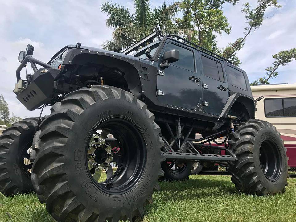

Funny you say that, I was just talking to some people telling them how I'll probably start off with a lift in a few years, and then I'll start working on all of these upgrades y'all listed, and then at that point kind of like you, I'll just hop up to 40s, why waste time with 37s, ya know!?
I got to focus on getting a house, and then once we get the house I'm probably going to end up spending a year or two fixing it up and doing a bunch of upgrades and projects I've been thinking about for a couple years now.
My wranglers plenty capable, I'll just upkeep it and keep it moving forward, and put my money elsewhere... For now. ;)
I'll probably need new skid plates here in a short while. In just four trips, I've done enough damage for a year to those skid plates. :swear::facepalm:
GO BIG!
