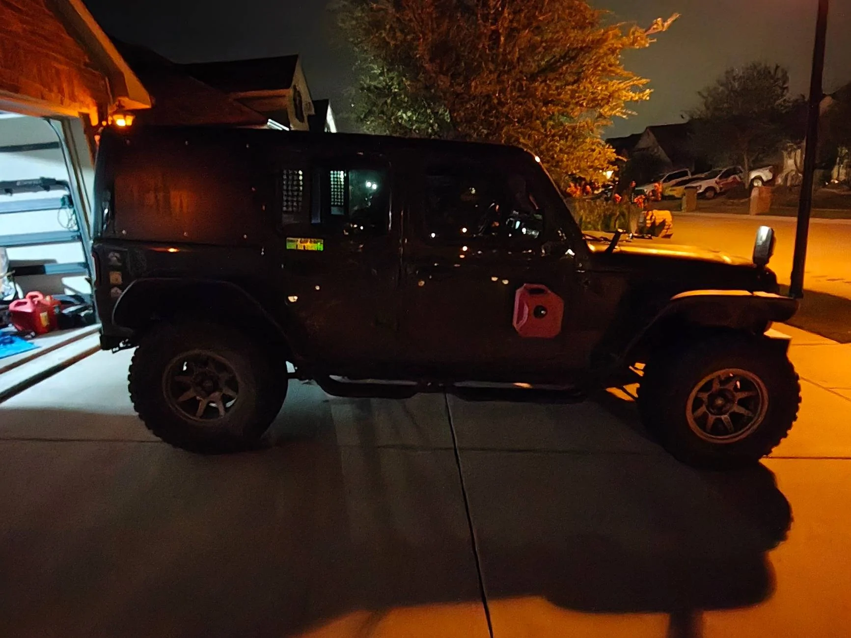

The aluminum panel, painted black, at least at night gives it a whole new vibe!
I feel like, in daylight it won't look as badass as it does at night! 🤷‍♂️
Got some bigger fender washers keep the grating in place.
And there you have it, roof rack goes back on the Jeep tomorrow afternoon!!! :like:

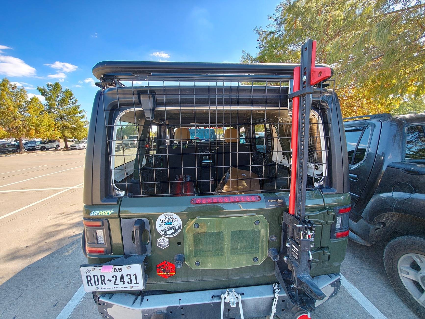

Purchased my new rear window for the hardtop today. At least one piece of it. I'm kicking around some ideas.
It's a 48" x 24" steel shelf rack. $14 at Lowes!
I'm having flashbacks to massive fumes coming in the rear window of Dad's station wagon when we had the rear window open like that. I guess that doesn't happen with Wranglers?

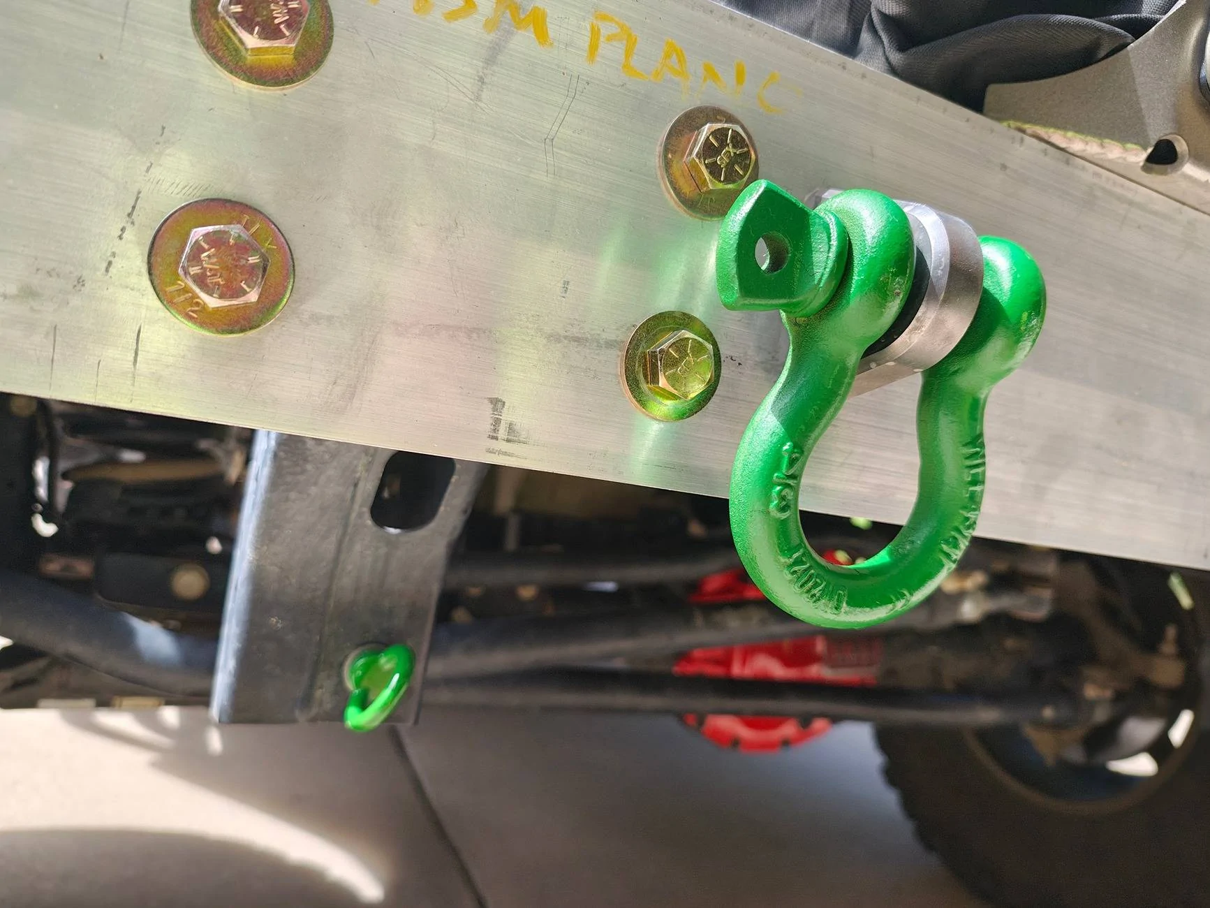

I wanted a more metallic green, kind of shiny and transparent, but the auto store didn't have that color so, John Deere Green will have to work.

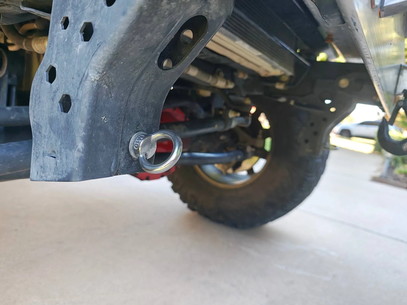

Put some m10 by 1.5 stainless steel eye hooks where the brush guard bolts go.
And painted them...
Figured I'd do the d-ring shackles on the front bumper as well...
According to the can it's in enamel paint, so I guess that means it holds up a little better to the thrashing I'll probably end up giving them. 🤷‍♂️
It actually looks pretty good too!
I looked it up a while back, like a week or two ago, the m10 bolt has a thread stripping strength of about 13,000 lb I think it was if you pull straight out. You have to put about 13,000 pounds of pressure on those bolts before they strip themselves and come out.
The stainless steel that the eye bolts are made of has a tensile strength of about 150,000 KSI, and I know the threading on the frame of the Jeep is hardened steel which has a tensile strength of like 180,000 KSI.
So even more than just for looks, these can hold up to some pretty hefty pulling.
The realistically I'll probably put all the weight on the d-ring shackles, but these are an option as well. But realistically they are mostly just for looks! :LOL: :facepalm: 😁 :fingerscrossed:
The threads will theoretically hold until 13k pounds if everything is perfectly straight. I've never experienced perfectly straight when doing a recovery, but maybe that's possible?
They're connected near the end of that chunk of metal, quite a ways away from the frame. Remember that torque equals force times distance.
I personally wouldn't pull much with them, but I might be slightly more risk-averse than you.

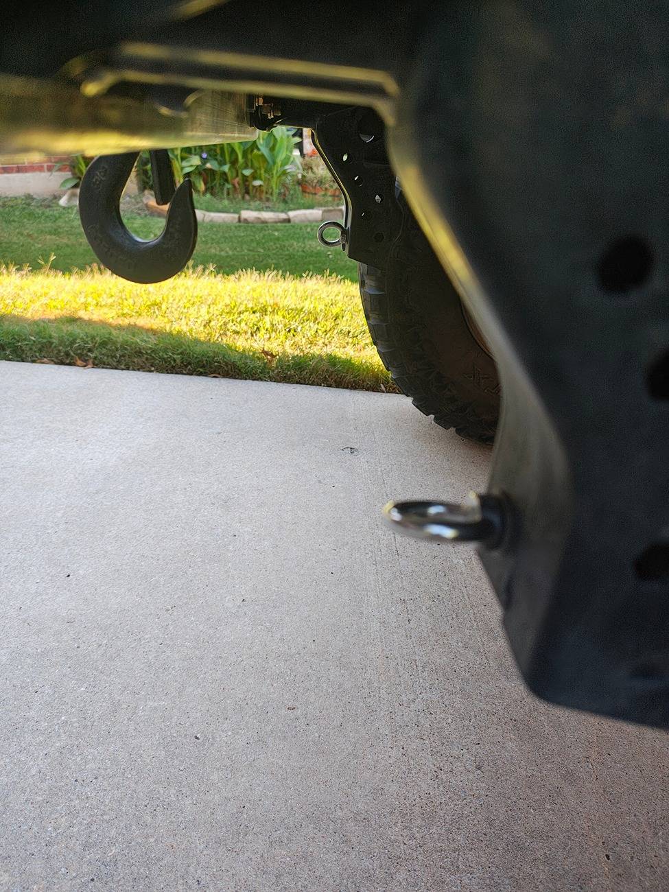

Here's the finished product. 😎
I'll probably take off the fairlead and paint that tomorrow evening. :rock: :like:
In a couple of months you hang these from those eye bolts. Wait, hear me out. They're seasonally relevant, they match, your diff covers, and people Will no doubt say, "Damn, that Jeep has balls!"
