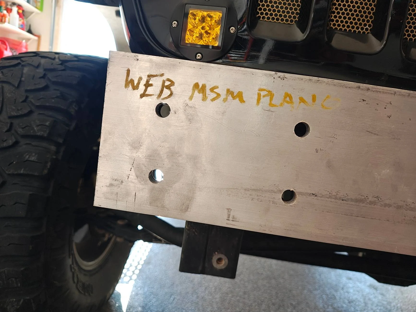

I might do underneath at some point in the future, but because of the restrictions from that portion of the frame, I'd either have to cut up some of the aluminum which I don't really want to do, or I'll have to cut up the frame which I already plan on doing in the future. So at least for now, the winch will sit on the top.
Gotta love how easy it is to drill into aluminum.
It's going to be hard to explain with words how we're doing the winch mounting, so I'll just show you guys when it gets completed.
Four of eight bolts for now, I'll get the rest of them when the hardware shop has the rest of available.

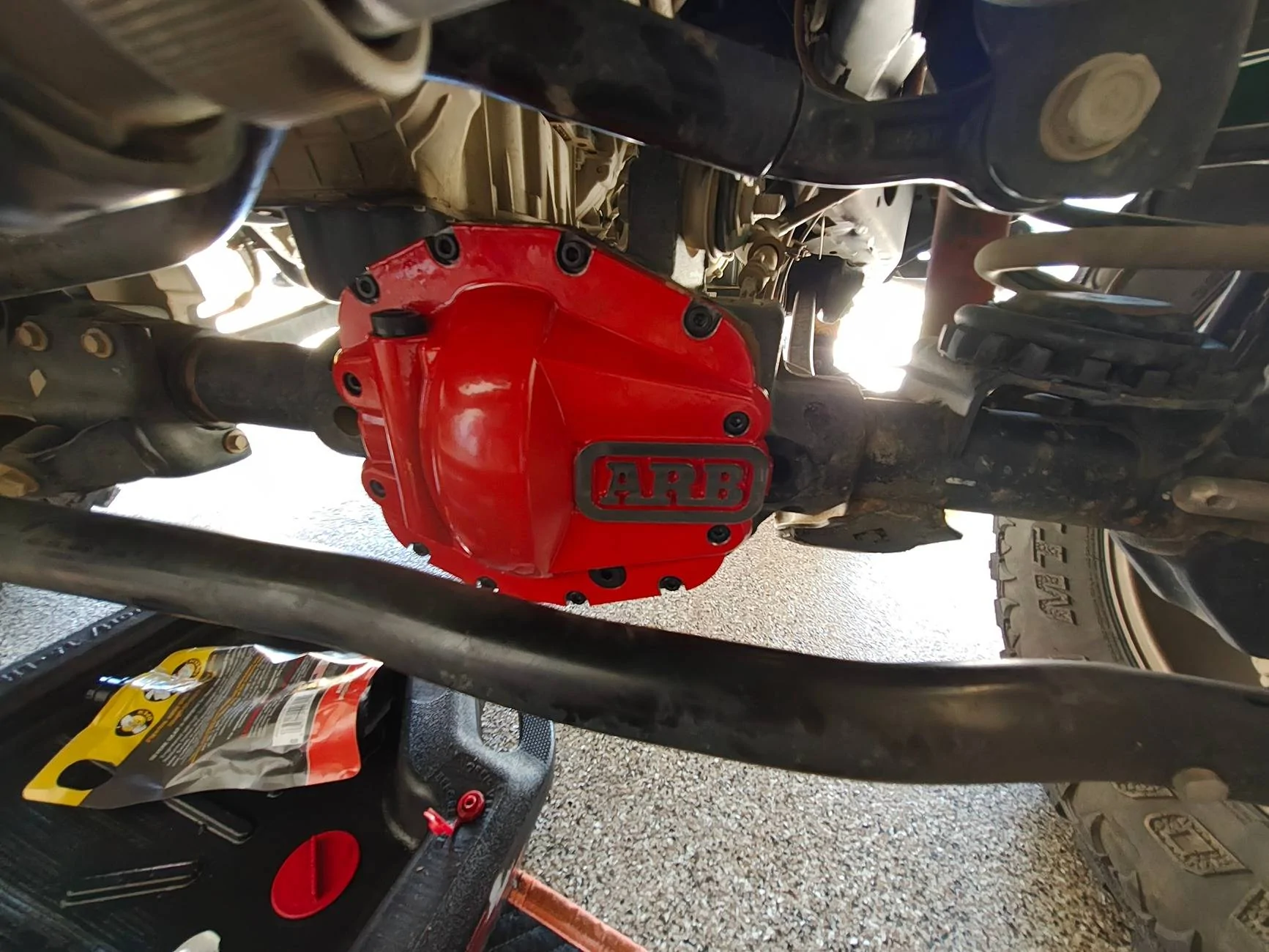

Gears look good on the front differential, and the old oil was actually pretty clean. Realistically I probably didn't need to change it, but I plan on doing more off-roading which will put more strain on the front differential so why not keep it up!?
New ARB front diff cover is holding up nicely, looks good and I love that I can now drain my differential in the front without having to yank off the whole plate!

Indications of measuring AND perpendicular holes? What has gotten into you? I know, the big reveal will be the winch mounted on Amazon Basics velcro!
Kidding, looks good so far!

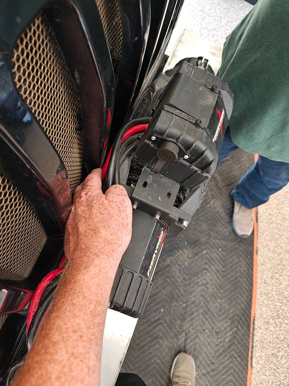

We actually got the holes for the winch started. And I bought the bolts for it as well.
All the bolts on the bumper mount are grade 8 steel, but I needed a special type of bolt for the winch because of where the front bolts sit in reference to the 90° angle. The inside of the angle is a rounded edge, not a straight edge, so I needed to get a smaller head than normal. Couple that with the steel flat bar I'm going to put underneath it to reinforce it, I'm going to have to do a little bit of grinding on the bottom side of the inside edge at a later date.. eh, problems for another day, you know?
This really is that example I was telling you where trying to explain something that I could probably show in a video in about 20 seconds, pretty hard to do. Maybe I'll do a video about it later in the week or next weekend possibly. 🤷‍♂️
Makes perfect sense. I've wondered a couple of time why a guy could notch out the nut housings on the winch, slide in a bolt, drop in through the bumper and put the nut underneath.
