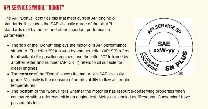

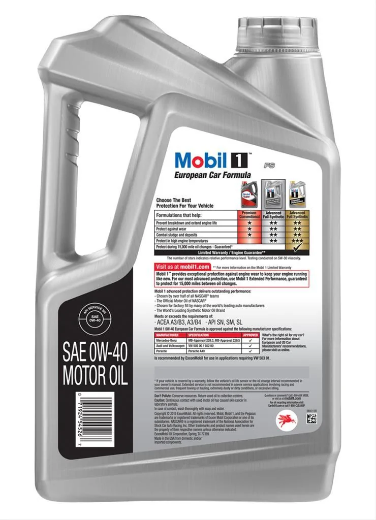

Mobil 1 FS 0w-40 and Mobil 1 FS 5w50 that lists API but not certified.
Show me where Mobil 1 FS 0W-40 is not API certified.
Sure has the API donut on it plain as day with an SN designation:

Yep, I've got that oil sitting in my garage waiting to go into a Mercedes. Has the certification.
The fact is, most oils, other than maybe a few niche weights or specialized oils, are API certified. That's not a great defense for Amsoil not certifiying the weights that most cars use in their top tier oil and then charging a premium for it.
You gotta look very hard under some rocks to find oils by major brands sold for the US automobile market that are not API certified.
