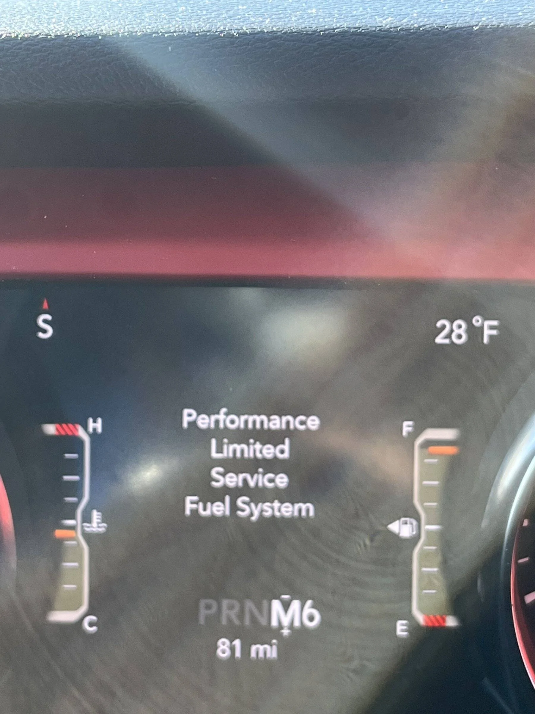

here’s a picture of it. I sent it to my sales guy who talked with his service department who told him to tell me, ā€œwe’ve never seen that before. drive it today and let us know if it happens again.ā€ He filled up my tank with 85 in CO which should be equivalent to 87 elsewhere which is okay by the manual. I put my first tank in today from Costco and used 91. I’m at 320 miles. I noticed it when I went into manual mode and was shifting, I saw it three times. I also noticed today after filling up that while coasting in the Costco parking lot, it was acting like a manual trans car where you just accelerate and then let off the gas and the vehicle jerks forward and back. Junk jeep.

I’ll be doing some winter wheeling trails tomorrow, see what breaks. ? I’m under full bumper to bumper and the dealer didn’t say, ā€œomg! Bring it in immediately!!ā€ So I’m going to run it like JEEPS are intended to be ran, on trails, use it for everything it can do and if it blows up, NMP. Interesting the folks seeing this though all with the 2.0.

Did my 2nd winter wheeling trip today. I’m at 400miles now. It popped up a couple more times on the drive home, this time it popped up and disappeared too fast to snap a picture. Luckily I was able to get it previously so the dealer knows I’m not crazy. I might contact the dealer this week. I’m now running 91 instead of the 85 the dealer put in. It did certainly seem that my performance n the trails was degraded today. Trying to rev up and spin the wheels to get through deep snow and it almost seemed bogged down. I wonder if @JeepCares could monitor this. Seems to be more than a one off, although not really a HUGE number of folks reporting it compared to how many Jeeps were actually delivered.
