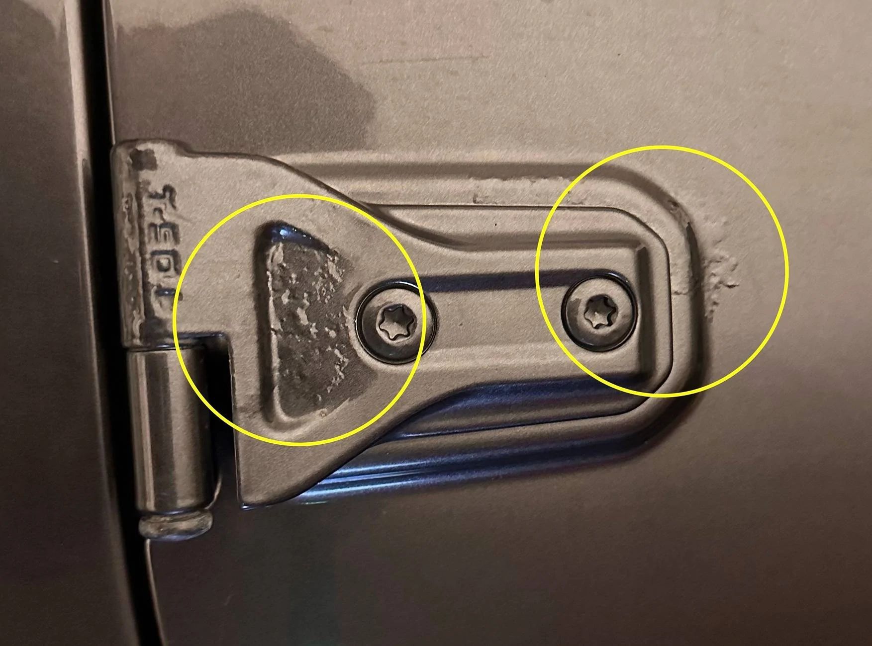

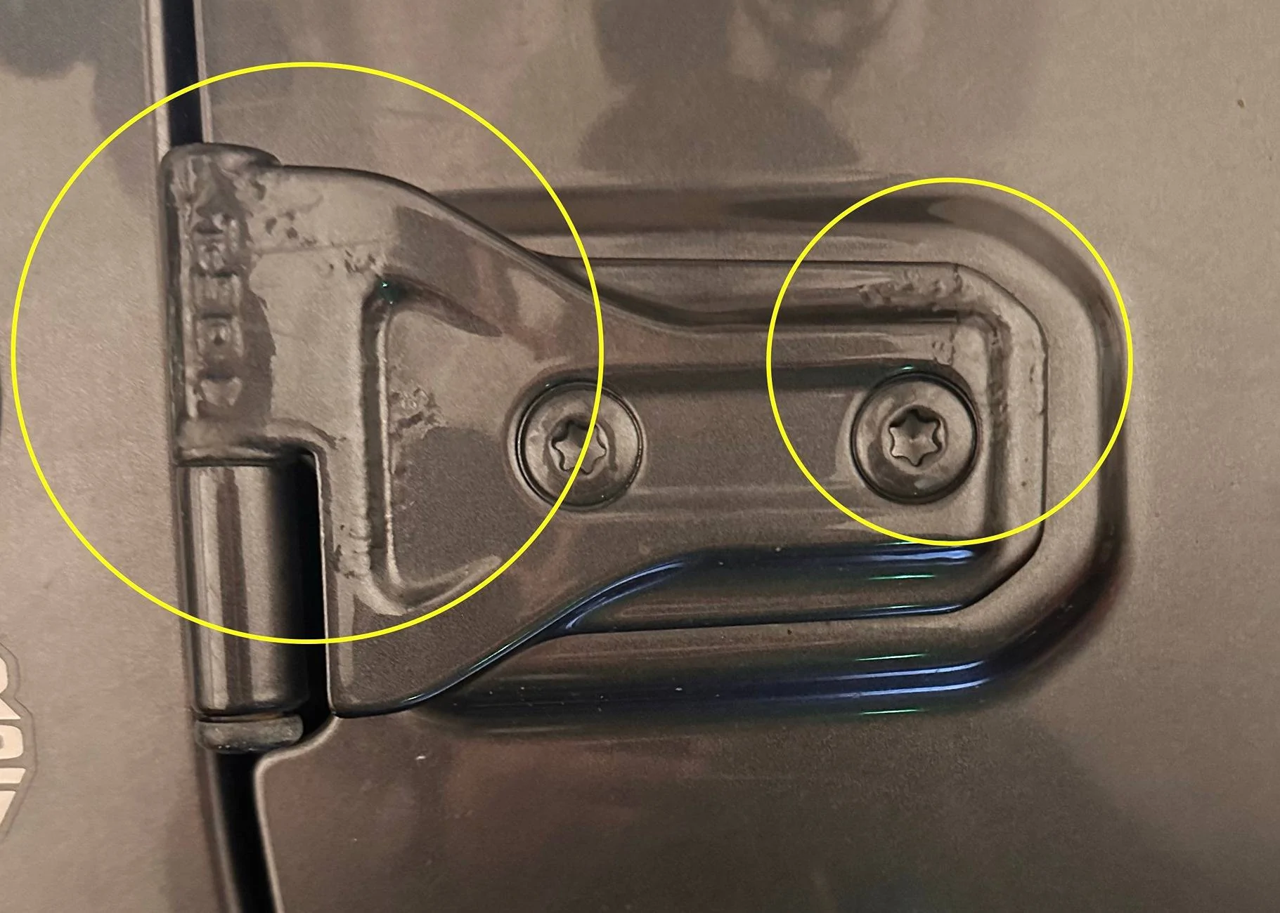

New to me 2019 JLU. Just noticed this on the two bottom, left-side driver / passenger door hinges. All the others are perfectly smooth. I don't see any rust in the area. What's going on here and what can I do about this?

Corrosion, every Jeep JL has it sooner or later... 5yr. corrosion warranty.

It’s called galvanic corrosion, and is most prevalent on JLs from 2018-2018. It is caused by an electro-chemical reaction that happens between two unlike pieces of metal, in this case the aluminum doors and steel hinges. It is NOT a rust or paint problem, but is a manufacturing problem that is being addressed by Chrysler as long as your car is within the 5 year warranty period and mileage is within certain parameters. There is reportedly a long waiting list of people waiting to get their vehicles fixed and repainted, so it is important to go through a dealer to get on that list. Do not ignore it since the damage (in my case with a 2020) will spread to doors and even the hood, since it is an electrochemical reaction. Also, I am told the problem accelerates if you are near salt water.

Yes, every automobile is prone to rust, but not at this level, speed, or pace. The problem stems from the aluminum material used in JLs since 2018 to lighten the car and increase MPG ratings. It has been identified as galvanic corrosion in published technical bulletins and can possibly be corrected through very exacting repair and repainting processes. Chrysler is ‘graciously’ acknowledged paint warranties for those who qualify. For those who do not, there may be serious safety issues down the road and at the very least a car with plummeting resale value.
Here is a link to an enlightening article. I have also attached a copy of the technical bulletin detailing the repair and paint process.
