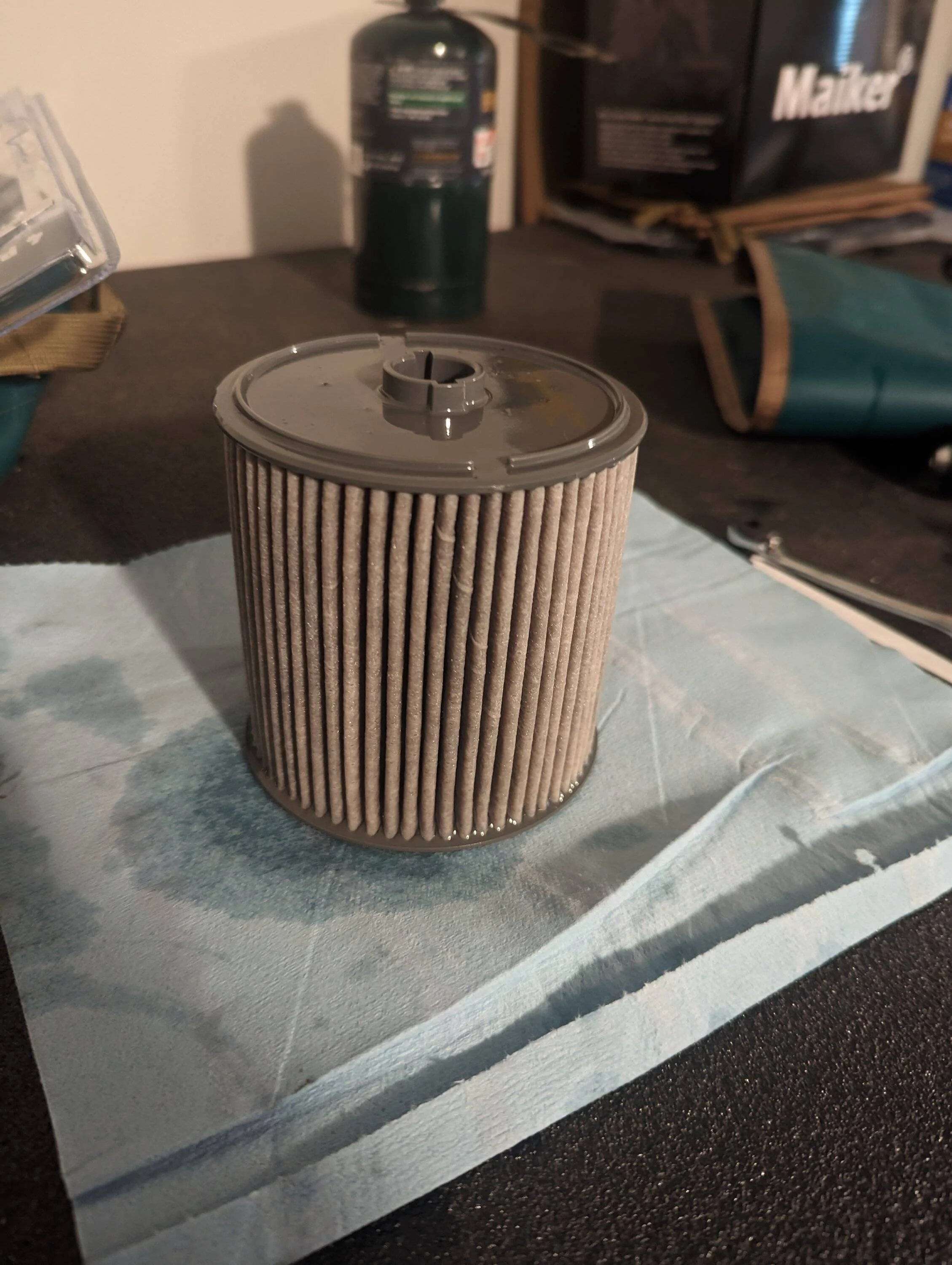

Update -- Fuel Filter looked surprising good for some of the places I've had to buy diesel. Next step is uninstalling the Derringer unfortunately.
