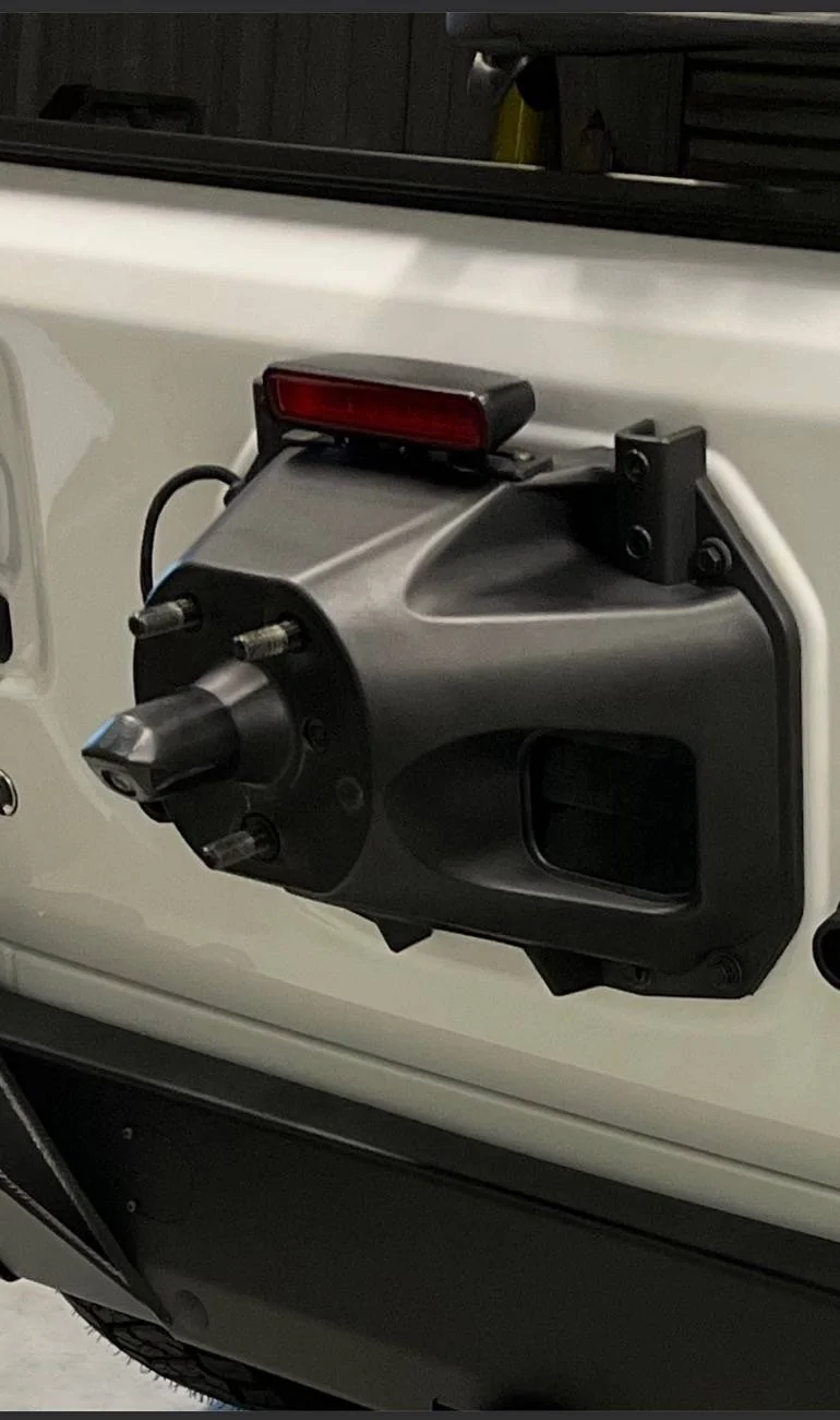

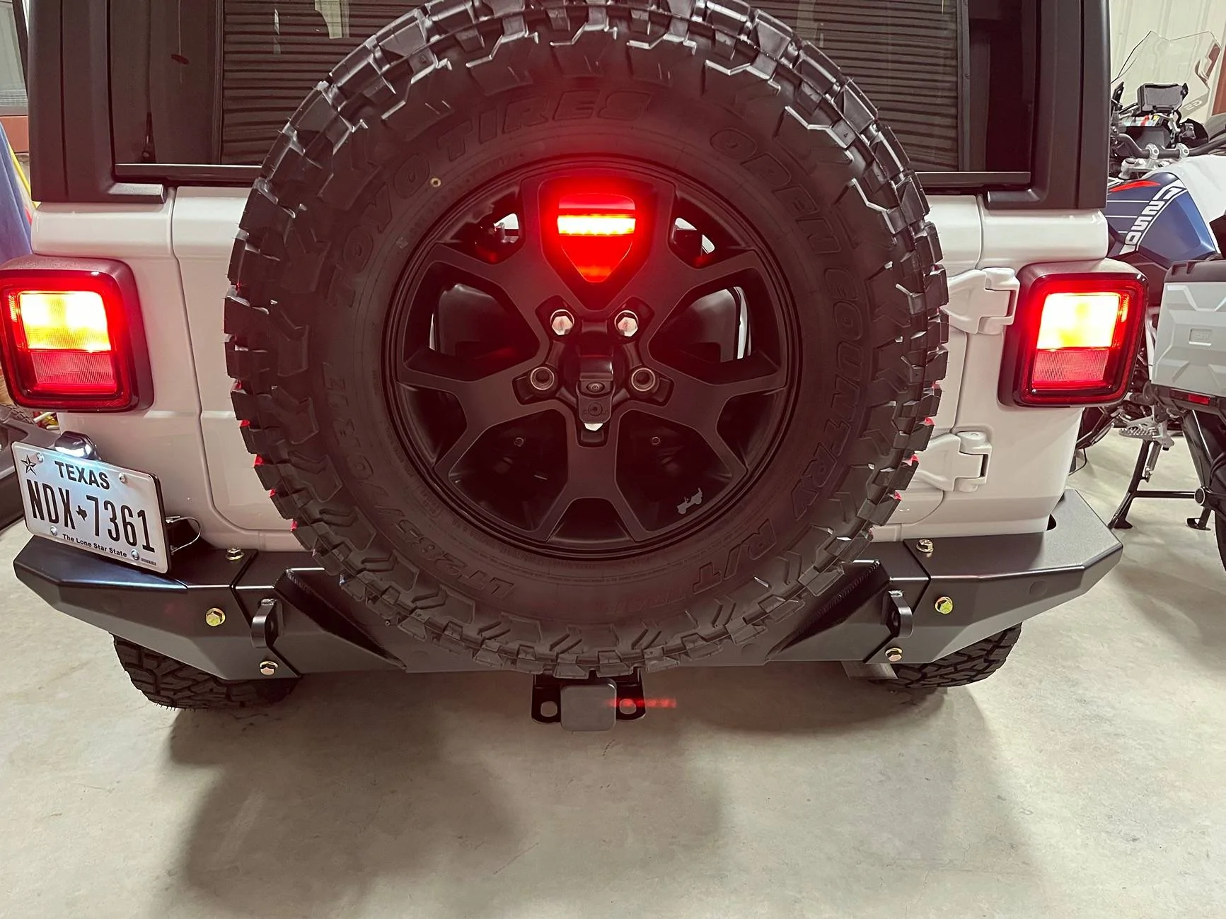

I removed the 3rd brake light bracket and mounted the light directly to the spare tire mount.

If you need a little more space, stack some thick 1/2” grade 8 washers on the mount lugs. I have 2 on each lug, for 3/8” of an inch more space. I also have the Metalcloak spare tire relocation bracket linked to above.

Easy test you can do. Remove the brake light mount from the carrier and
Mounting the brake light like that is a genius idea. Super simple fix.
Thanks. I always hated the look that 3rd brake light bracket and the light sticking up over the tire. Plus it ways made creaking noises.
I made the bracket from a thick piece of rigid plastic. In this case, part of a Harley license plate mount that I had laying around. The piece has to be long enough to bridge the gap on top of the spare tire mount. I drilled a hole on each end, then into the tire mount. The mount is plastic covered aluminum, so I tapped holes it for some M6 screws. Then, on the plastic part I made, I drilled 2 holes in it to match the mounting holes in the brake light, then a 1/2" hole to allow the harness to plug in from the bottom. The excess wire from the bracket is bundled up and zip tied, then zip tied under the tire mount. So no wiring was cut.

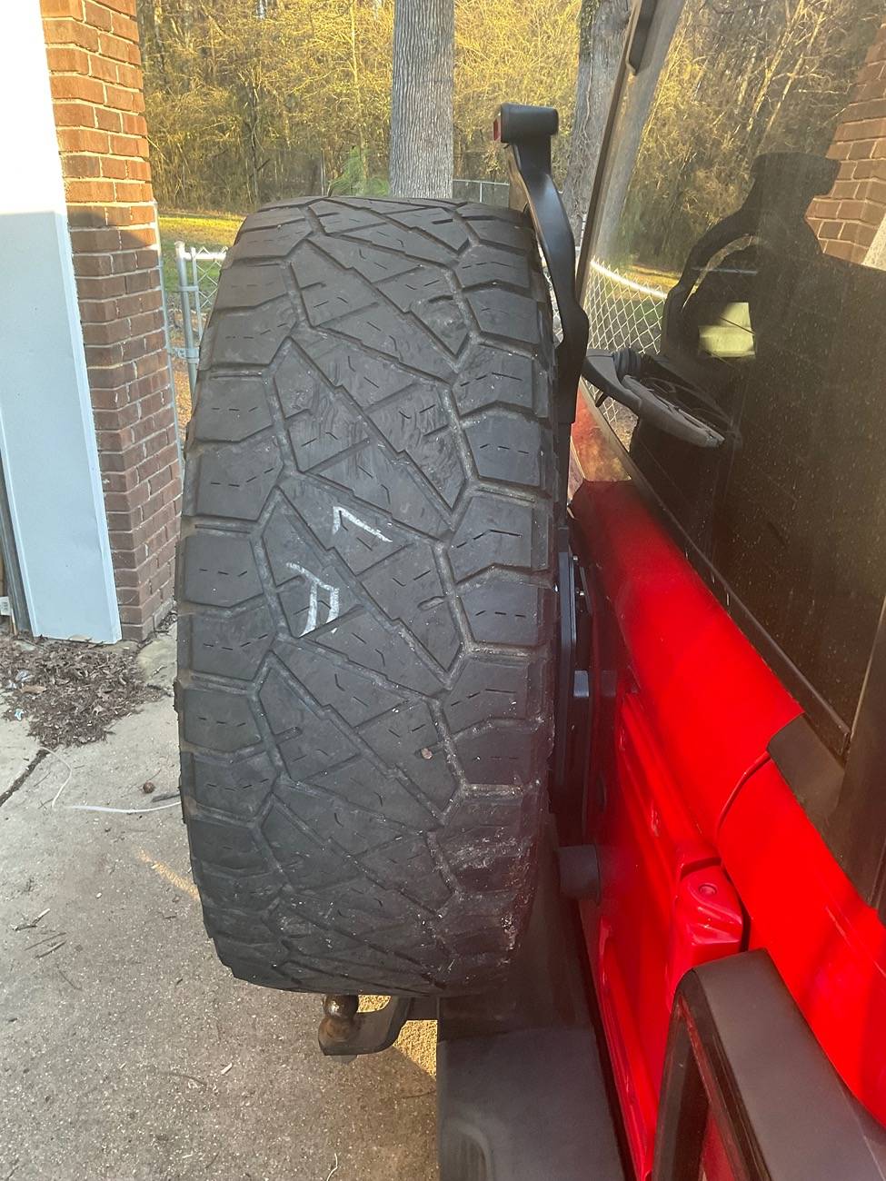

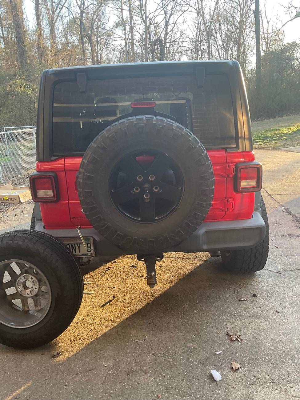

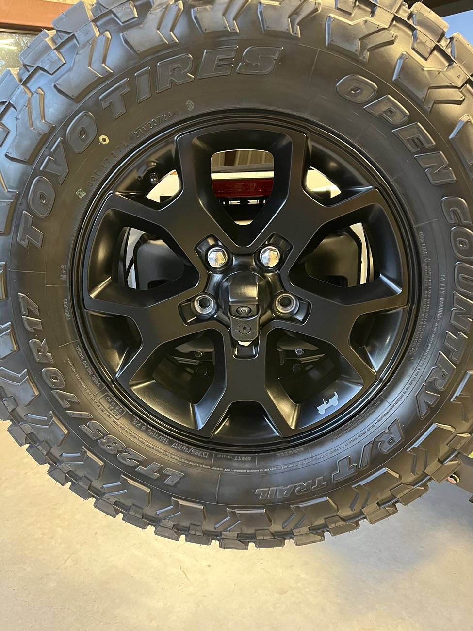

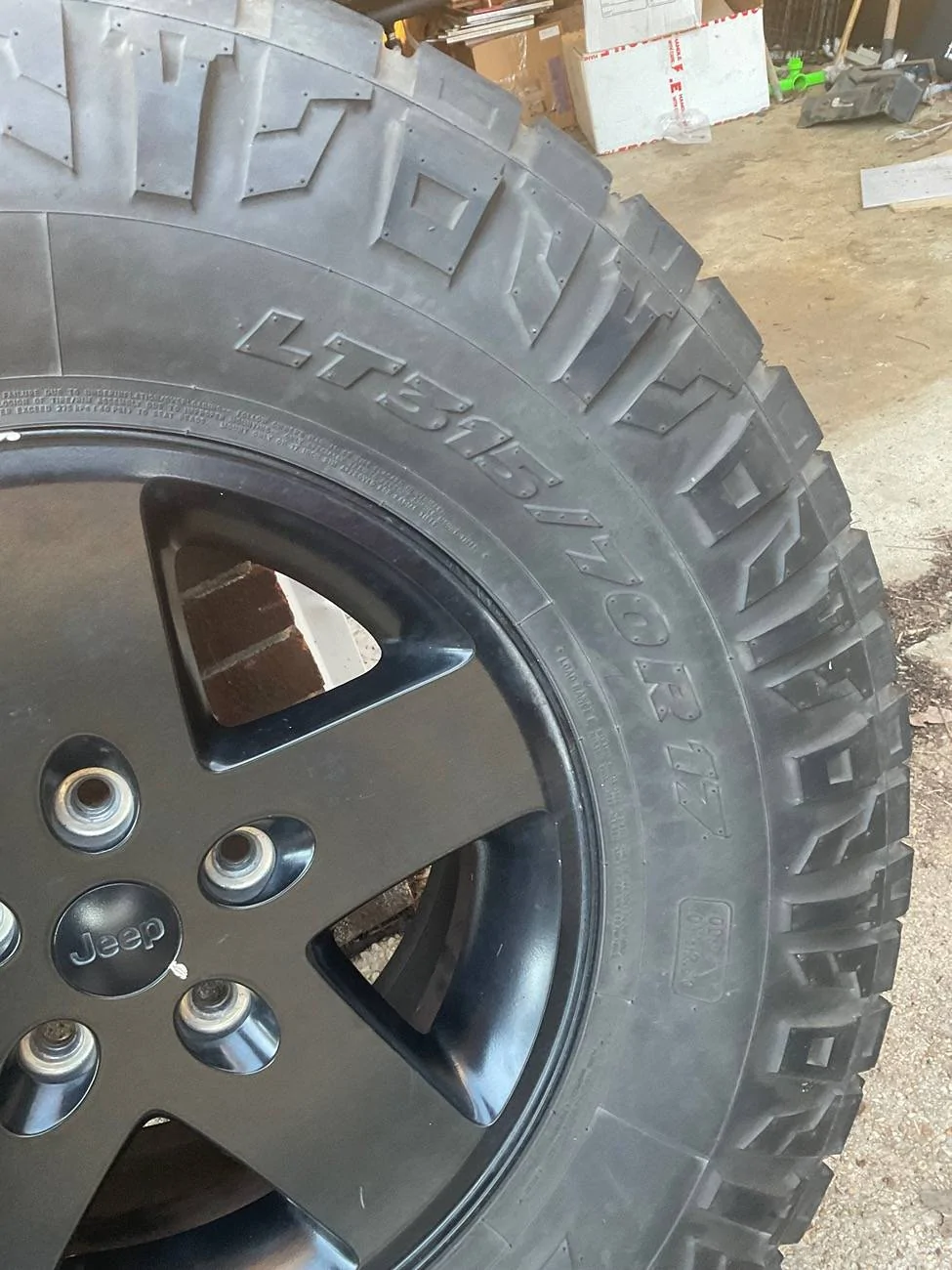

You would be the first person ever to need longer lugs, so something else has to be going on. Post a photo of the inside of your wheel where the part number is marked and there is a ET with a number.
Will do
This is almost certainly the problem, but is it a Sport or Rubicon? If it's a Sport, then there is a second problem -- that large of a tire will also rub on the factory rear bumper. You'll need a relocation bracket to move up the tire mounting point, like this: https://www.roughcountry.com/product/configurable/jeep-spare-tire-relocation-plate-10526c
Note that if you get that bracket, it also moves the mount point out, so you would also not have to trim the rubber stoppers as much. Thus, I'd check for rubbing on the bumper first, install whatever bracket, and then trim the rubber.

Aha. That is NOT a stock Jeep wheel. Not for a JL Wrangler. You have a JK wheel from the past generation (2007-18). Although all relevant dimensions (lug pattern, offset, etc.) are the same between the models, the center hole of JK wheels is smaller because they didn't have a backup camera to fit through. I believe it's just small enough that you are probably hitting the camera instead of being able to push the wheel all the way down onto the mount. The other possibility is you're hitting the bumper at the bottom of the tire.
Take that JK wheel back where you bought it and get an actual OEM wheel from the JL, and it'll fit. (You still may need to raise the mount to clear the bumper).
