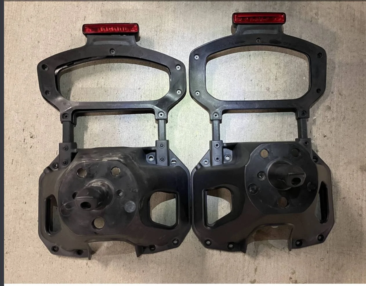

I could be wrong, but doesn't only the Rubicon brake light have additional holes to adjust up?
You can move the sport one up too. The rubicon brake light mount is actually taller then the sport one

Jeep Wrangler JL Oversized Spare Tire problem IMG_8945
this was in the link I posted on the first page of this thread. Sport on the left. Rubicon on the right.

the CHMSL on my ā€˜21 Willys was able to be moved up far enough to clear a 35x12.5 Mickey with a tiny bit of force.
Take both screws out third brake light bracket. You will need to trim some of covering from the brake light wire where it goes through the tailgate. Move the bracket up and only reinstall the top screw.
Moved mine to the top hole. The spare still hit the bracket.
