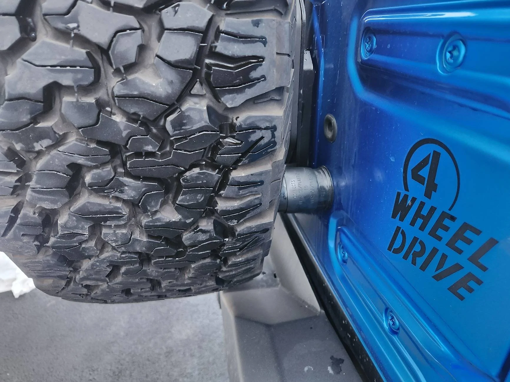

I’m going to try this again because I think I haven’t made my problem clear. I know I’m not the first Wrangler owner to have this problem. Here goes: I put 35’s on my 2021 Wrangler and wanted an oversized spare. I purchased a LT315/70R/17 on a stock Jeep 17” inch wheel. it will not fit. I’ve installed a RC adapter to lift the brake light another 2”. still no luck. The studs simply will not extend enough to get a lug nut on them. I’ve talked with two guys at mechanic/tires stores and a man at Autozone. No one knows. Any help?

Are you sure you are not hitting the spare tire bump stops? Might need trimming to get a 315 tire on a 44 offeset wheel to fit there.
This is almost certainly the problem, but is it a Sport or Rubicon? If it's a Sport, then there is a second problem -- that large of a tire will also rub on the factory rear bumper. You'll need a relocation bracket to move up the tire mounting point, like this: https://www.roughcountry.com/product/configurable/jeep-spare-tire-relocation-plate-10526c
Note that if you get that bracket, it also moves the mount point out, so you would also not have to trim the rubber stoppers as much. Thus, I'd check for rubbing on the bumper first, install whatever bracket, and then trim the rubber.
I’ve relocated it, I’ve lifter the brake light. It just seems that I need longer lugs.
You would be the first person ever to need longer lugs, so something else has to be going on. Post a photo of the inside of your wheel where the part number is marked and there is a ET with a number.

I put 33s on my ‘23 Willys and the spare hit the brake light mount. I had to remove it and ended up getting the mopar brake light relocation mount. The spare tire slightly rubs on the bumper but it fit the carrier. The wiper almost rubs on the spare. You might be able to get a rubicon spare carrier and get away with it. That one sits up a little higher and comes out a little further.
this shows you the difference between the sport carrier and the rubicon.
https://www.jlwranglerforums.com/forum/threads/oem-spare-tire-carrier-2-different-part-s.38640/
or get one of the relocation mounts for your existing carrier that others have suggested. Just remember if you do that you’ll probably still have an issue with your existing brake light mount.
