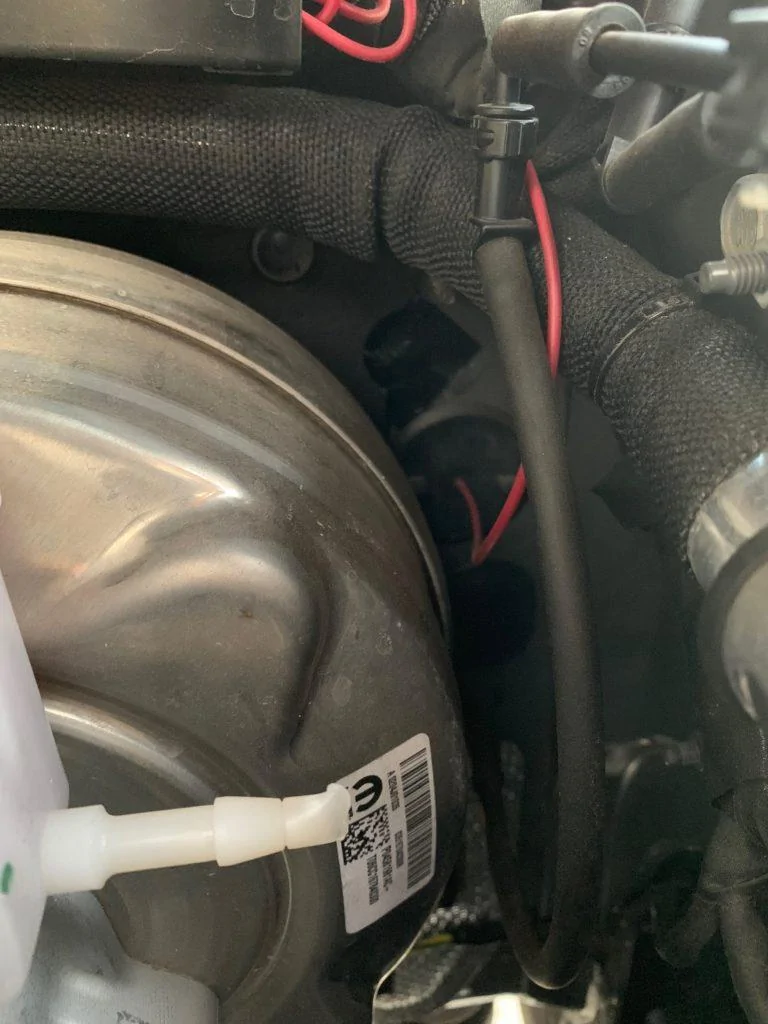

Jeep Wrangler JL Overlanding battery 63453AD7-3EE2-40BC-B305-BDD817BFFD61
Thanks, Ruben. That’s gonna help a lot.
Where did you pass the wires through the firewall?
Right behind brake booster in engine compartment on drivers side is a removable plug. 8 drilled a hole in that plug and passed them through.
