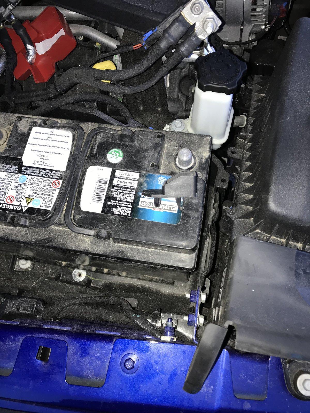

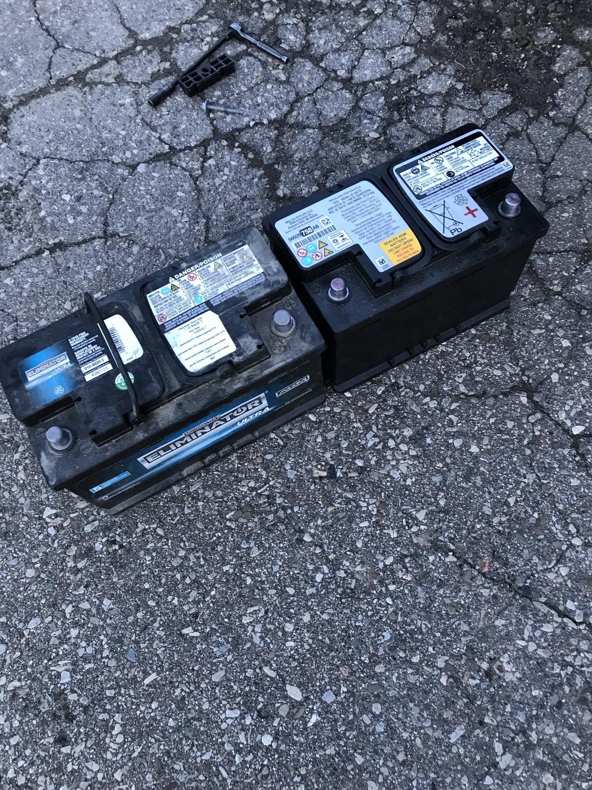

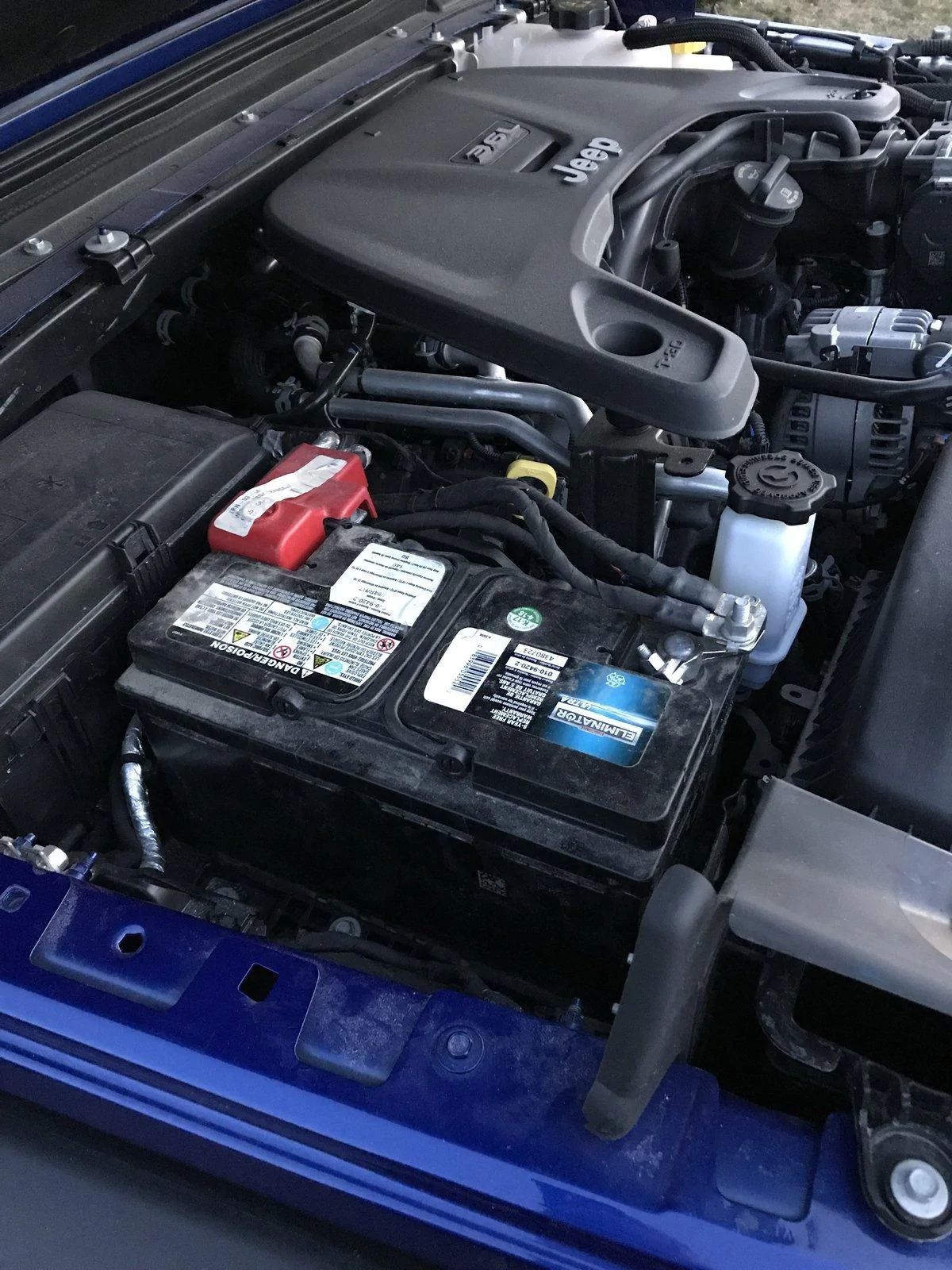

You can fit a larger battery in the stock tray, its a tight fit and perfect.
Group 94 AGM, ran fridge for about 44 hrs without turning jeep on. I have a whynter 45qt fridge
Edit, you have to remove the little battery stopper (second photo) Then I added a 1/4” piece of aluminum to make it a tight fit

Hard to tell from pictures but it looks like the height is the same correct? Does the battery tie down still fit?

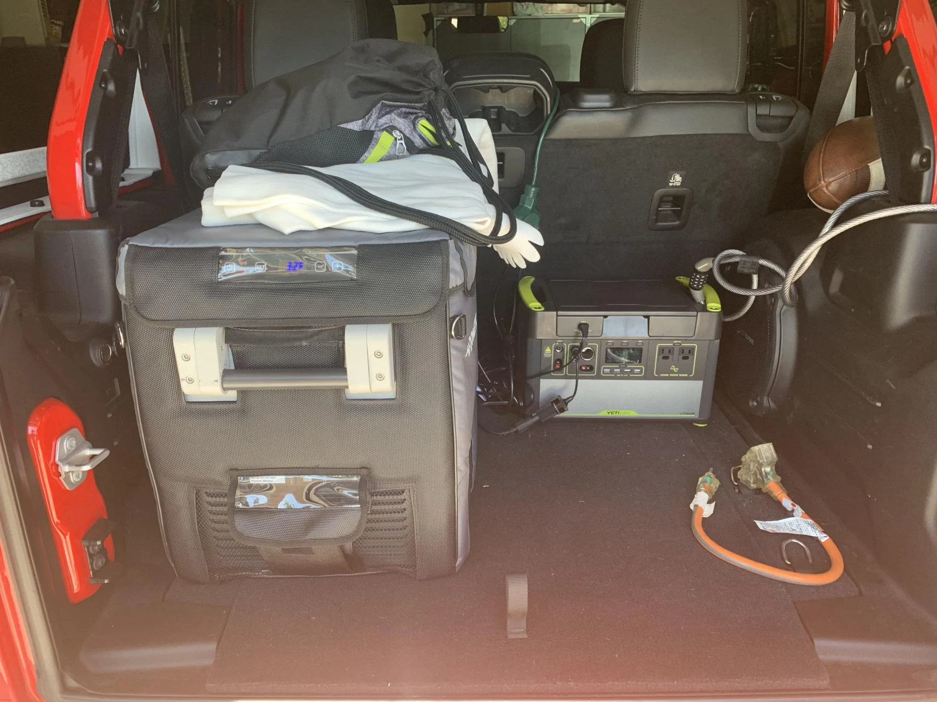

I have been watching this thread for a while as my current setup uses a Yeti 1000. I had been hoping to change it to a 2nd battery and freeing up some space. I am running a Dometic CFX 40 and this past holiday week was out and about. 5 days without charging..... it was on the 4th day mid way through that I lost DC power out of the Yeti as the voltage drop was below 10.1. Plugged the fridge's AC plug into the Yeti AC and was able to grab my last day. Approximately 114 hours with varying fridge load from full to nearly empty on last day. My question is to the group is if anyone is getting longer than 44 hours out of their second battery setup? Also wondering with remote start...has anyone programmed the system to auto start the Jeep to recharge the second battery since U-Connect will remote start?
