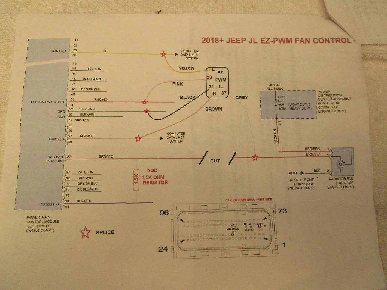

230 degrees is on the lower end of whats been happening with the jeeps 3.6 / 2.0 / 3.0
My 3.6 hit 235 last summer on a mild up hill clime and would have continued to clime if I did not hit the top of the hill
I have read people having hit 240 and above and going into limp mode
This is very pore designing on the part of the jeep engineers
With the fan controller I have solved the problem that the jeep engineers did not
Now what we need is to have someone Like Jon at RPM Extreme build some that will work on the 2.0/3.0 / 3.6 etongue
From what I have seen they all use the same radiator fan with the 3rd small wire that controls speed via the ECM
So it is possible to take control of fan speed and temperature at which the fan turns on
After installing the RPM fan controller I can see that it may be possible to hook up a device like this
https://www.summitracing.com/parts/...YZR8Z3ROoFXx_NIORjZYSwhvc1qHeijAaAiaVEALw_wcB
Installing the 1.5 resister tricks the ECM
The small wire that goes to the fan would be hooked up to the Derale PWM Adjustable Fan Controller
This may work
See picture
Jeep Wrangler JL Overheating issues 2023 JL IMG_1835
This may work
See picture
You have not solved any problem other than your own desire to have more control over the cooling fan. The fan would come on at high speed at the temperatures you are calling “overheating” and lower the temp back down. At highway speed, the fan is hardly doing anything at all.
