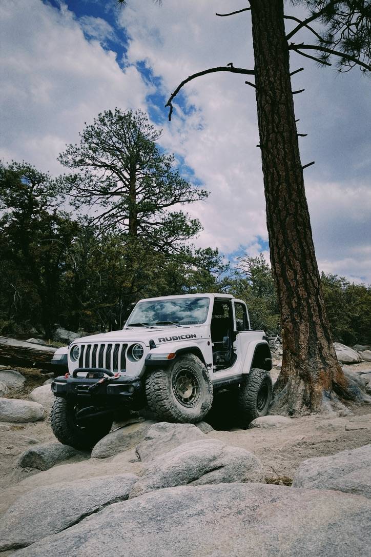

I'd recommend KM3s or possibly the Coopers you listed. KO2s are a nice AT but in my eyes they start to look weird like an oversized road tire when you get to the sizes over 37. I see you're in SoCal - we live in an incredible area for wheeling and I think you'd be more than justified in running a mean MT if you're planning on hitting trails somewhat often. As for Nittos, know that they and Toyos run the heaviest size-for-size compared to other ATs or MTs in the same class. I like to watch the total weight of my wheel/tire setup because it's less stress on the axle and better drivability and MPGs with a lower unsprung weight. The Patagonia in 35" load range D is only 67lbs and my Fifteen52 wheels are 29lbs so it's one of the lighter MT setups I could have gone with. A Nitto Trail Grappler in the same size is 79.9lbs.
There's mixed reviews on the tires I run but I really do recommend the Milestar Patagonia MT if you like the look. They're quieter on road than any other MT but look nice and aggressive - I've got like 23k miles of 50% highway and 50% hard wheeling on them and they have tons of tread left. Only downside is you must run them at above 37 psi on-road for proper wear which makes them a tad stiffer than other tires.
Mine are 35s on a 2 door but you get the idea:
Jeep Wrangler JL Only 3 Options for C Load in 37s? 9203C221-2A23-490A-B419-193C7EF646A6_1_105_c

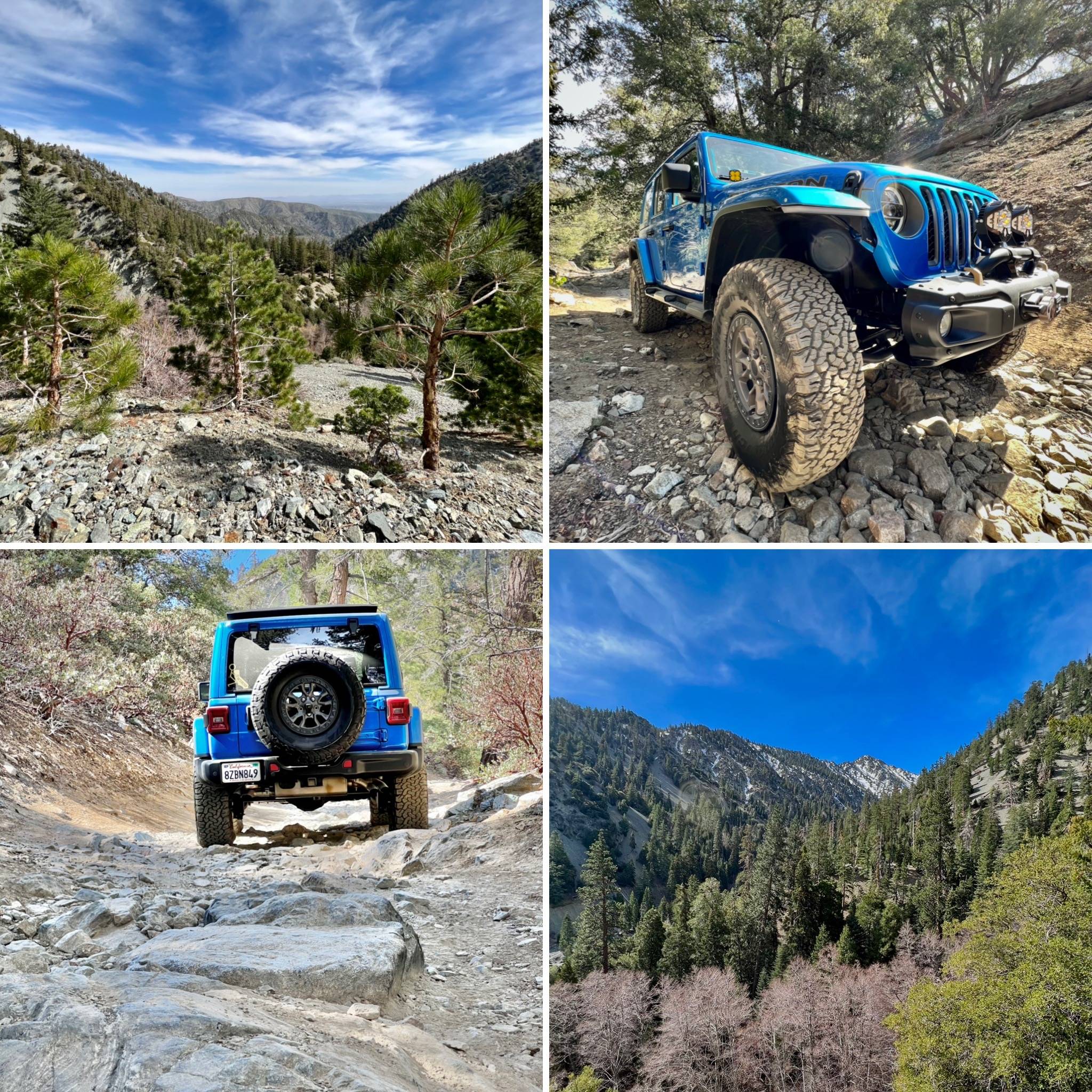

Yeah that’s the thing, for where I live the BFGs are perfect. I hit the Mountain snow a lot for snowboarding and do a lot of camping with my wife, which includes a lot of freeway driving, but with the lift I would like the more aggressive look and I’m trying to get out more on the weekends. Just went last Sunday. Doing Saturday morning Mountain biking and Sunday off-roading.
Jeep Wrangler JL Only 3 Options for C Load in 37s? 5CE2755A-BD51-479D-8A6D-FCCA8601BAF6

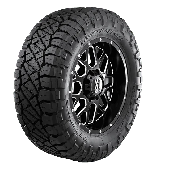

Do the Mickey Thompson Baja Boss MT`s have 2 different sidewalls?
One being aggressive and the other much less aggressive looking
The Nitto/Toyo same company has a Hybrid that is not to bad looking
37x12.50x17 is a D range
38x12.50x17 is a C range
The Trail Grappler 37x12.50x17 is a D range
The TG 38x13.50x17 is a D range
The TG 40x13.50x17 is a C range
https://www.nittotire.com/light-truck-tires/ridge-grappler-light-truck-tire/
OVERALL RATINGS
PERFORMANCE RATINGS
  • Jeep Wrangler JL Only 3 Options for C Load in 37s? off-road-ratings-icon
    OFF-ROAD PERFORMANCEIS A 4 OUT OF 5
  • Jeep Wrangler JL Only 3 Options for C Load in 37s? sun-icon
    DRY PERFORMANCEIS A 4.5 OUT OF 5
    4.5
  • Jeep Wrangler JL Only 3 Options for C Load in 37s? cloud-icon
    WET PERFORMANCEIS A 4.5 OUT OF 5
    4.5
  • Jeep Wrangler JL Only 3 Options for C Load in 37s? sound-icon
    QUIETNESSIS A 4 OUT OF 5
  • Jeep Wrangler JL Only 3 Options for C Load in 37s? comfort-icon
    RIDE COMFORTIS A 3 OUT OF 5
UTQG TIRE RATINGS
  • METRIC SIZES ONLY TREADWEAR:
    500
  • TRACTION:
    A
  • TEMPERATURE:
    B
Jeep Wrangler JL Only 3 Options for C Load in 37s? Ridge_Grappler_06
