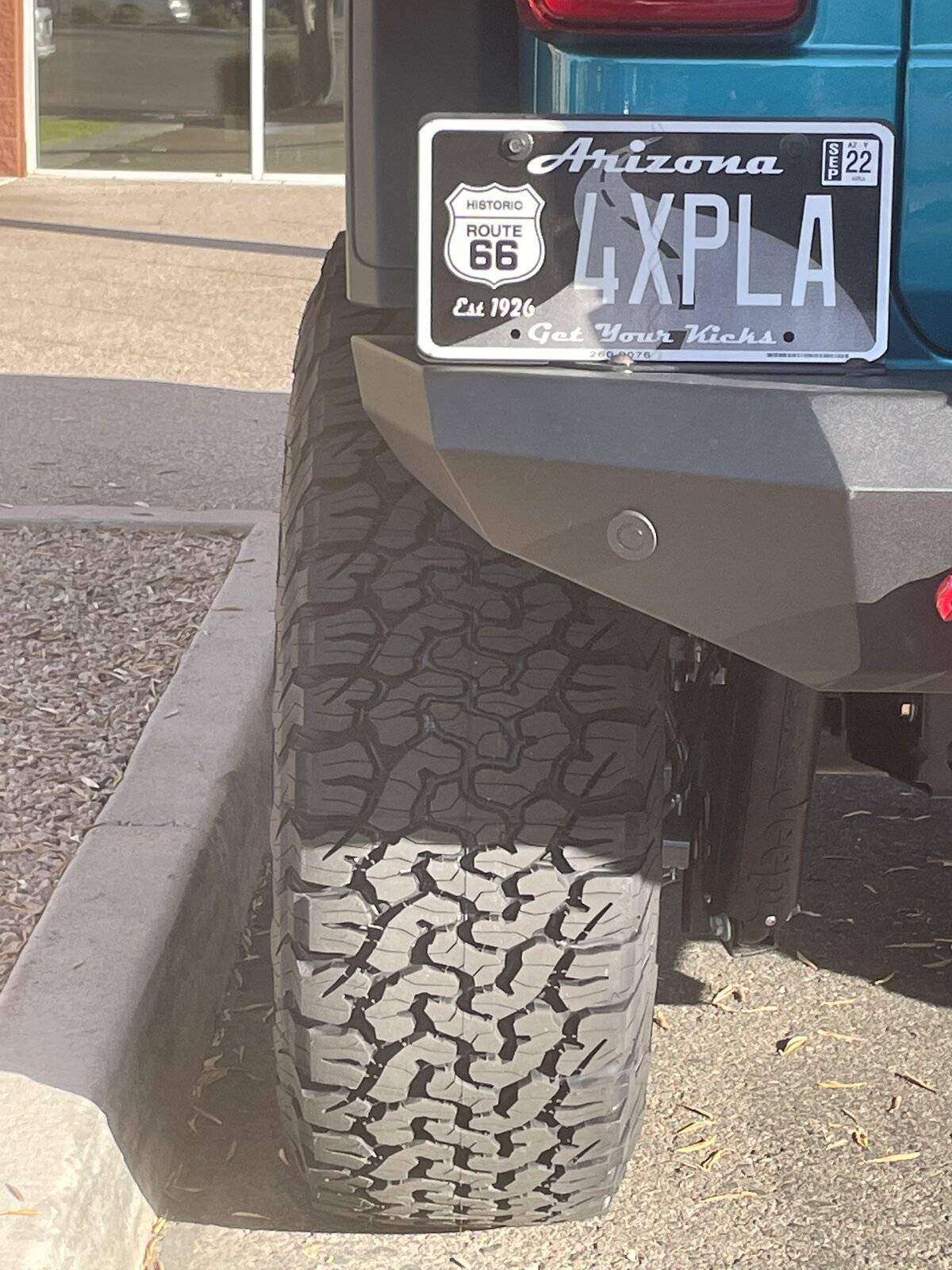

Well I have now put just under 100 miles on my 37x12.50R17 'C' KO2's...So far, I have to say this is the first (I have had BFG KO's on every truck since my first 2010 Raptor) BFG AT / KO2 that I have not been totally happy with...I put 35" KO2's (315/70R17) the day after taking delivery of my Rubi 2-door and loved them! My short term observations on these 37's: I like the added height, I do NOT like the fact they are about 3/4" narrower than the 35's and compared to the 35's, I do not like the way they respond after a quick moderate speed steering correction to avoid an obstacle. Also I am not crazy about their 'pizza cutter' look, again compared to the 35's... Not sure yet just how I will deal with this but unfortunately, right now, I am not thrilled. Maybe if I had not enjoyed and pushed the 35" KO2's over the last 11,500 miles, I might not know what I was missing...
For reference, I have included some pictures below of both tires, both new, same size 17"x8.5" rims with 5.2" backspace and both inflated to 27PSI. The 37" KO2 stands about 1.5" taller than the 35" KO2 but sadly, also has about 3/4" narrower tread.

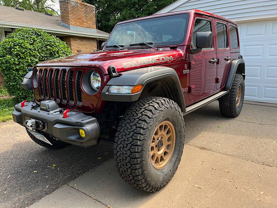

Bro I’m so glad I found this thread. I was going to pull the trigger on the load range C 37” KO2s, but after reading your comments and experience, I went load range D. Installed today.
So far the ride is GREAT! At around 29 psi right now. I’ll be tweaking it as I put more miles on.

Glad you like them and I also settled on 29psi cold, great looking Jeep by the way!
