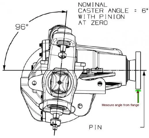

More caster is the best place to start. And the way to get there is to install adustable front LCA's. Shoot for a little over 6 degrees caster. Although the pic below is from a JKU forum, it applies to the JL as well. Contrary to what others say, you do need an alignment from a knowledgable shop. That's what the "adjustable" is for.
Jeep Wrangler JL On-Highway Compliance Jeep Caster
