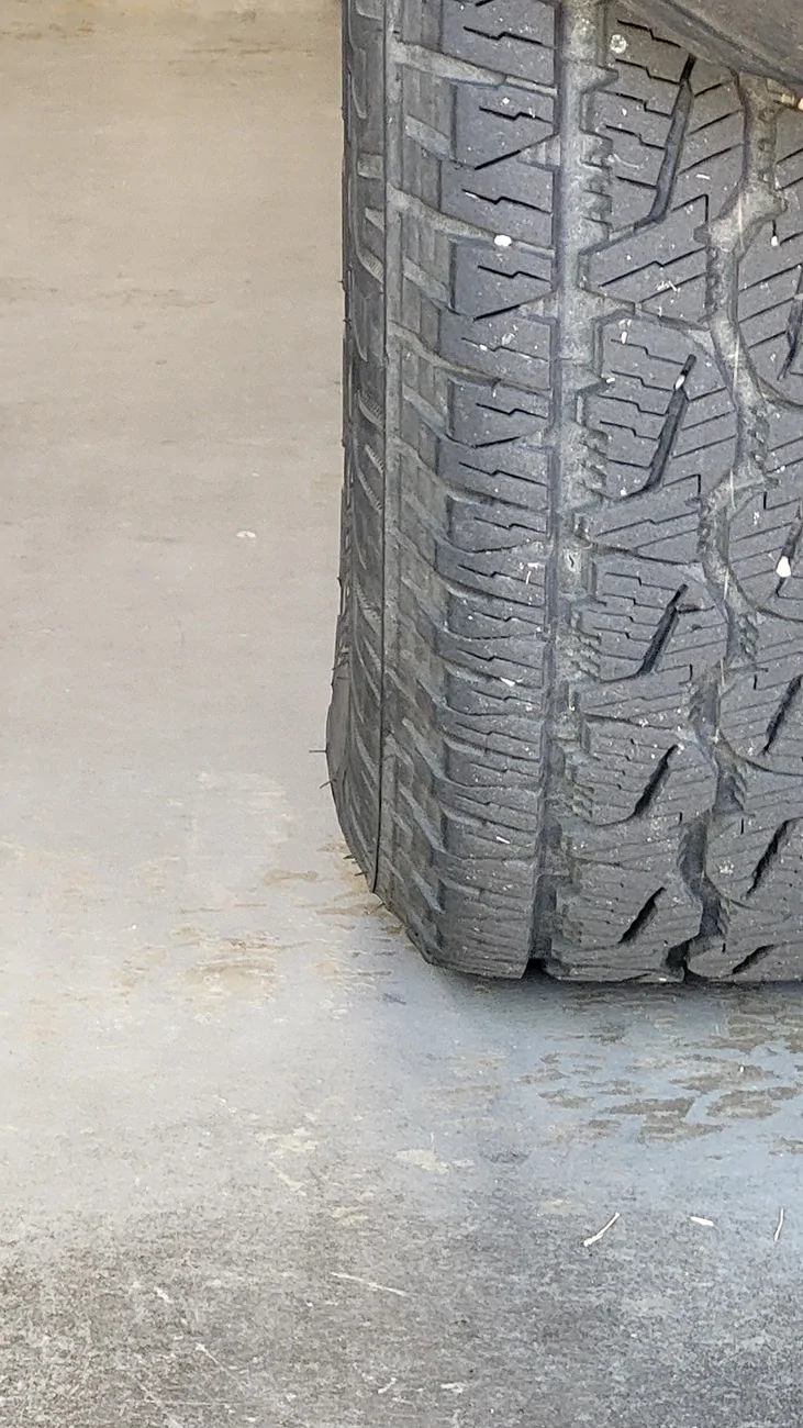

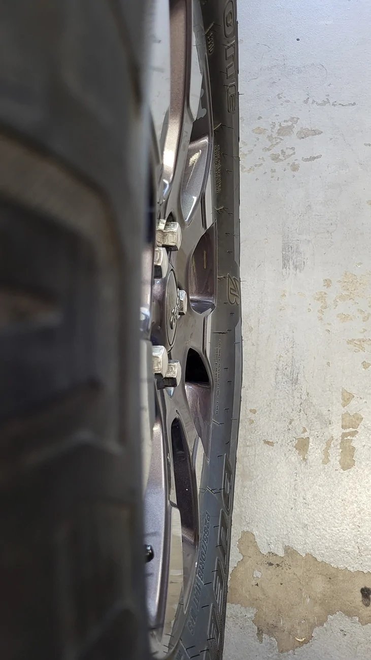

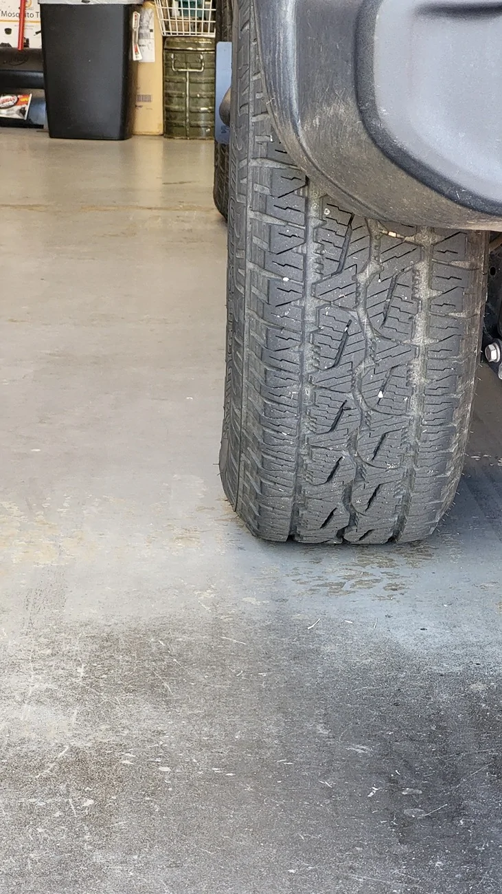

Speaking of tire pressure, what is an ideal on-road pressure for my tire? It’s a Load E.
Load E is not the ideal choice for your usage. E is a 1 ton heavy truck tire with a stiff sidewall and 55 - 65 lbs of dead weight. Try lowering your pressure to 30 psi or less. Looking at the sidewall, cold, there should be a little pooch, bubble, curvature just above the contact point. SL is the idea tire rating. Still 3500 lbs of load rating, less weight, a more compliant sidewall.
E rated!!!?!?! That's your problem right there. That is an extremely stiff sidewall. You should be running a C tire. D if you are getting up to the 37s and larger but even those you can find Cs in.

E-rated tires aren't that big a bugaboo. The studded Generals that my Jeep wears in the Winter are Load Range E. While the individual wheel/tire combo is 20 lbs. heavier when compared to the other wheelset, the ride quality is only mildly degraded...and Pennsylvania roads won't ever make the cover of Smooth Asphalt magazine.
More to the point, the Jeep's steering is fine when the Generals are installed. I do use the same tire pressure (+/- 1 PSI or so) as I do with the other tires. Granted, both sets of tires are identical in size.
In the OP's position, I'd experiment with different tire pressures. If No Joy, and the tires themselves are free of damage and wearing evenly, an alignment check might be in order.

Thank you for all your help. I’m going to take some PSI out and get those Mopar LCA’s and then an alignment by a shop that is familiar with Jeeps. After that, I’ll juat wait until I need new tires and look at Load C tires.
