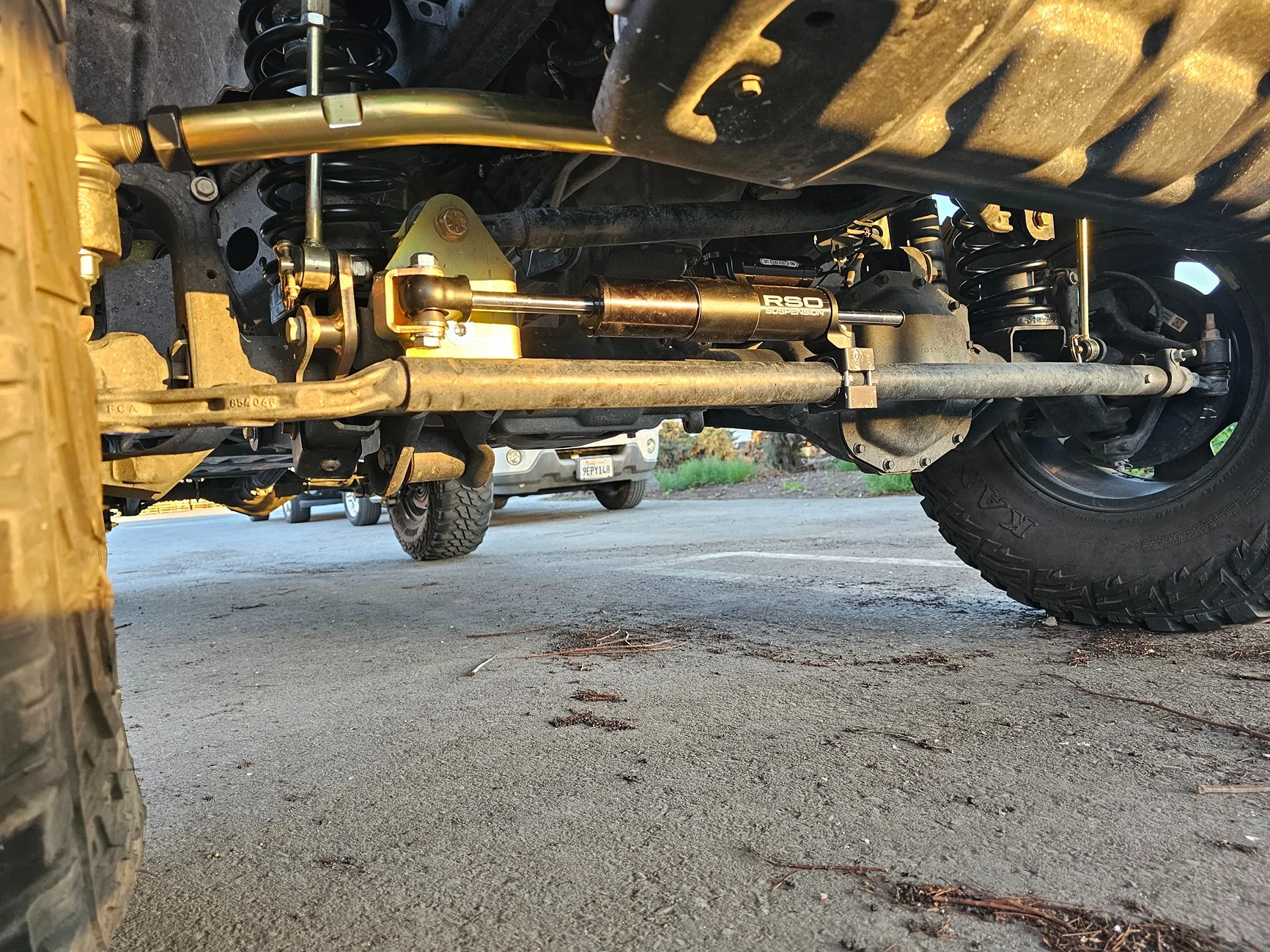

I went with the metalcloak flipped drag link and their bolt on bracket on the JT. We run the steersmarts yeti no drill flipped drag link on the wife's JLUR and their bracket also bolts on. No complaints about either and they've both been solid for tens of thousands of miles. No pics of the JLUR, but here's the JT. Both the xr and the JT mojave came with steel knuckles so I never even looked at any of the kits that replace them. Yes the tie rod is still stock because I'm cheap.

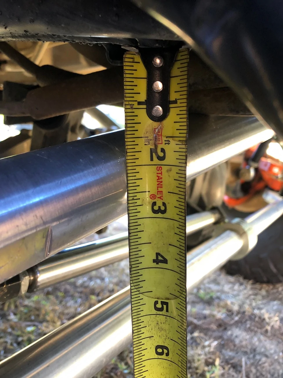

Had mine on a couple years now, no issues….The flipped drag link the juice wasn’t worth the squeeze for me…. I didn’t want to increase my bump stops to keep it from hitting the frame at full stuff like this….
Jeep Wrangler JL Ok how much to spend on Steering IMG_9290
..you can see in the pic I have 1-1/2ā€ before hitting the frame, the bar is 1-3/4ā€ so to maintain that separation I would have to add 2ā€ more bump.. I’m already running 3.5ā€ in front, which is perfect for my setup…..
Jeep Wrangler JL Ok how much to spend on Steering IMG_8482
Gods honest truth, I can drive 80 without any vibration, wandering, tracks dead straight, no bump steer etc, so I decided I’d rather keep my articulation…..

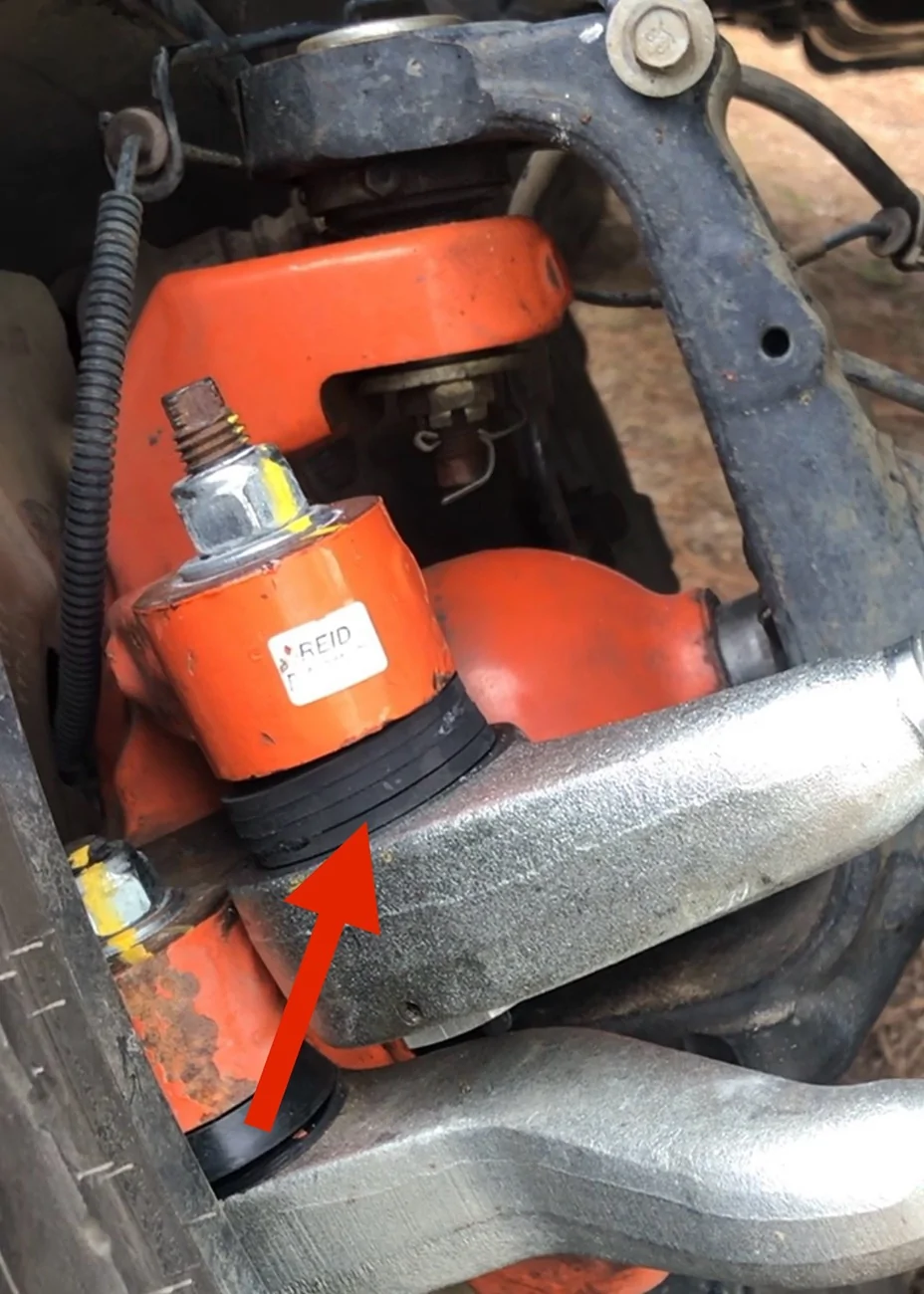

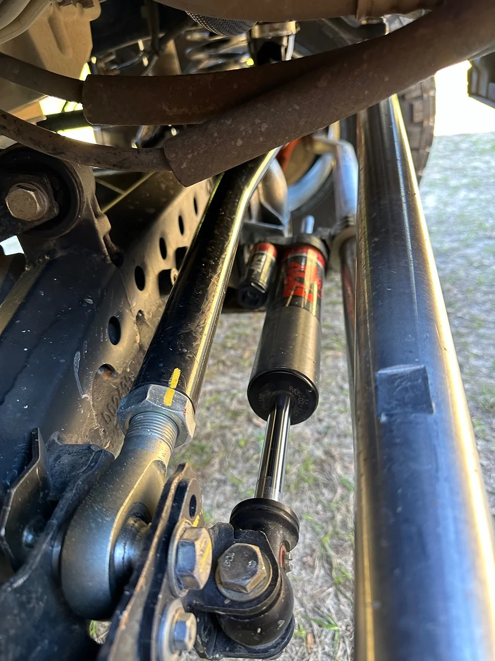

I’ve done a couple extra things to mine that isn’t necessary….. but I wanted to run my Fox ATS so I had to fab my own axle side bracket out of a MC bracket…. Also added a rubber bushing on the drag link …….pics of both…
Jeep Wrangler JL Ok how much to spend on Steering IMG_9758
Jeep Wrangler JL Ok how much to spend on Steering IMG_9281
Rock Jock is also a good company, and have good products… As far as aluminum vs steel, I really don’t have an opinion on which is better, when my yeti drag link shit the bed at 15k, I just wanted to try the pro x steering as it was just coming out about the same time……

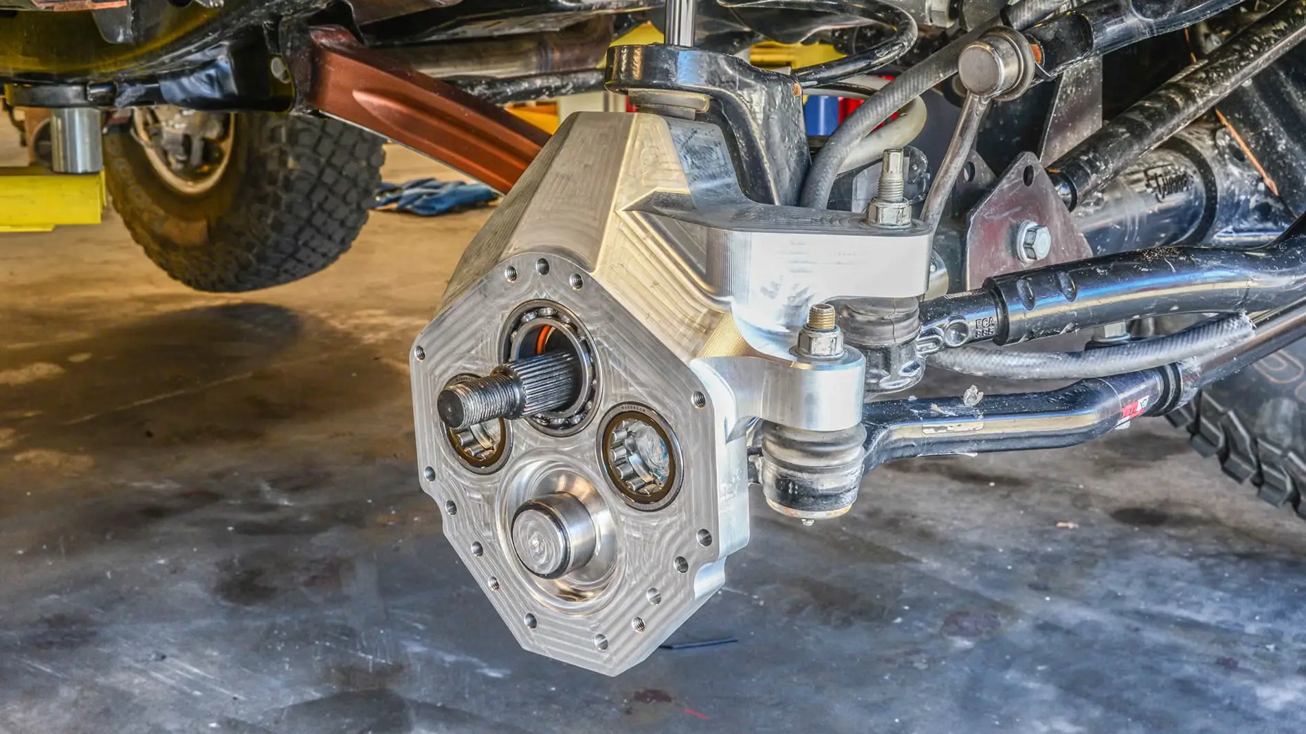

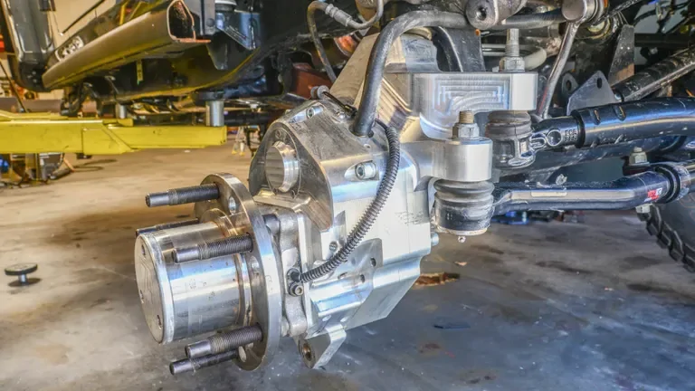

74 Welds knuckles should work.

I went with Reid’s , but that was before I knew you could get Mopar steel knuckles… So far I haven’t seen or heard of there being any difference, other than the Reid’s steering stops aren’t adjustable, but that hasn’t been an issue for me……
