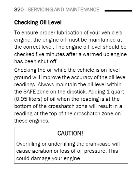

The oil *must* be checked per the directions in the owner's manual, no joke. While the engine is at operating temperature, shut it off, and check the dipstick at 5 minutes after shutoff. When I do this after an oil/filter change and putting exactly 5.0 quarts back in, the level is dead on "FULL".
If you check it after the engine has been sitting for a while, it will appear as if it's a quart overfilled. That's actually a false reading and you should not drain oil. Check the dipstick per the procedure outlined here:
