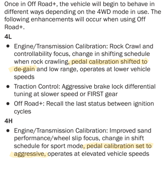

Off road + is for quicker throttle response in both 4Hi and 4Lo.
That's exactly the opposite of how it works on my '22JLUXR. For me in 4LO, it degains the throttle response, and takes more throttle pedal movement for power application, smoothing out the jerkiness when crawling. First time I used it it felt like a slipping transmission and I didn't care for it much, but after lots of use, I really love it. Wonder if it got recalibrated somehow in newer models.

By my read it should be slower throttle response in 4L and quicker throttle response in 4H.
Thank you. I missed that in the manual. It felt more snappy in 4Lo to me.

In 4lo it has the opposite effect allowing for smoother throttle inputs.

OffRoad+ is supposed to reduce throttle response in 4lo, right? In my JLURD it seems to increase it exactly like in 4hi.
I would imagine practicing on the coastal dunes definitely helps! And yeah…. Yours isn’t working right in 4low, it sounds like.
