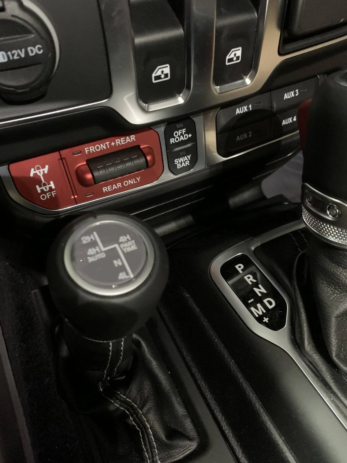

So when I ordered I knew what I was getting into with lockers, sway bar disconnect, and the 4wd I chose. But what on earth is this off road plus button?
