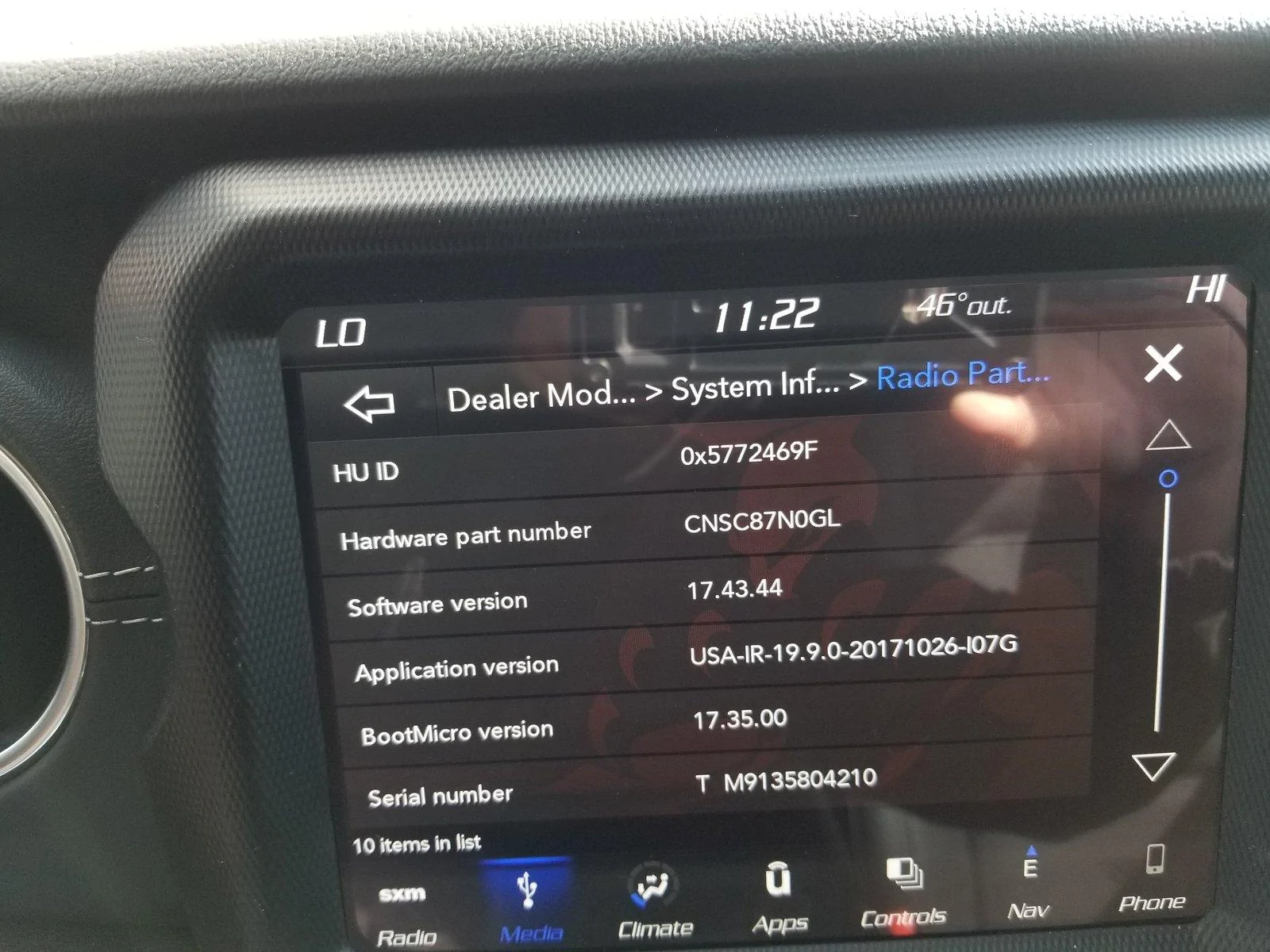

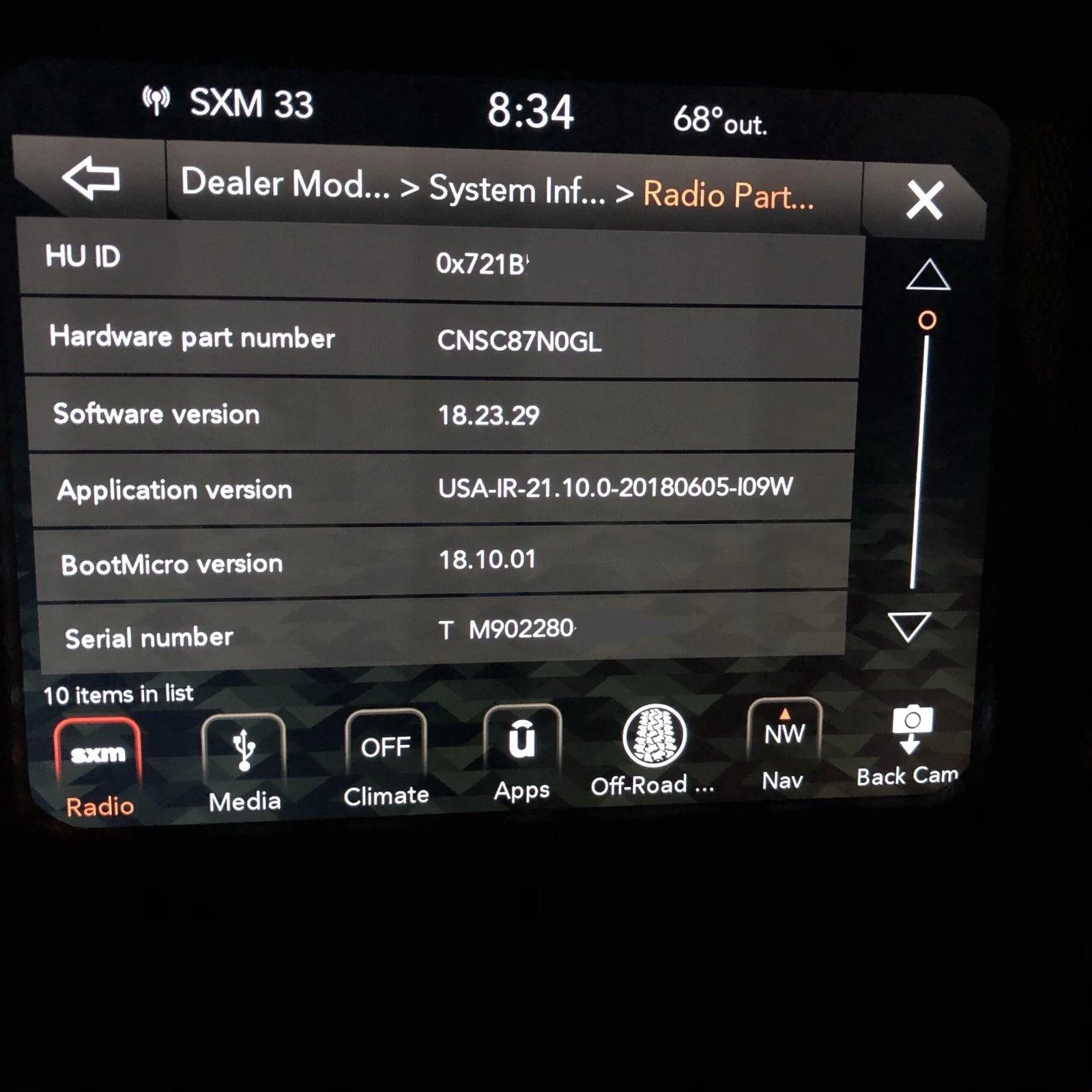

Thanks for posting that - looks like I have the same software version with the exception of USA vs Canada.
Time to call the dealer.
@Neanderthalman , Would you be kind enough to tell me how (or steer me) to enter dealer mode?
Confirm if it is simply pressing, Hot + Cold + Front Defrost together?
I know I've seen it somewhere but can't find it.
TIA
TIA
Exactly that. Press and hold the driver’s side hot, cold, and defrost for a few seconds.

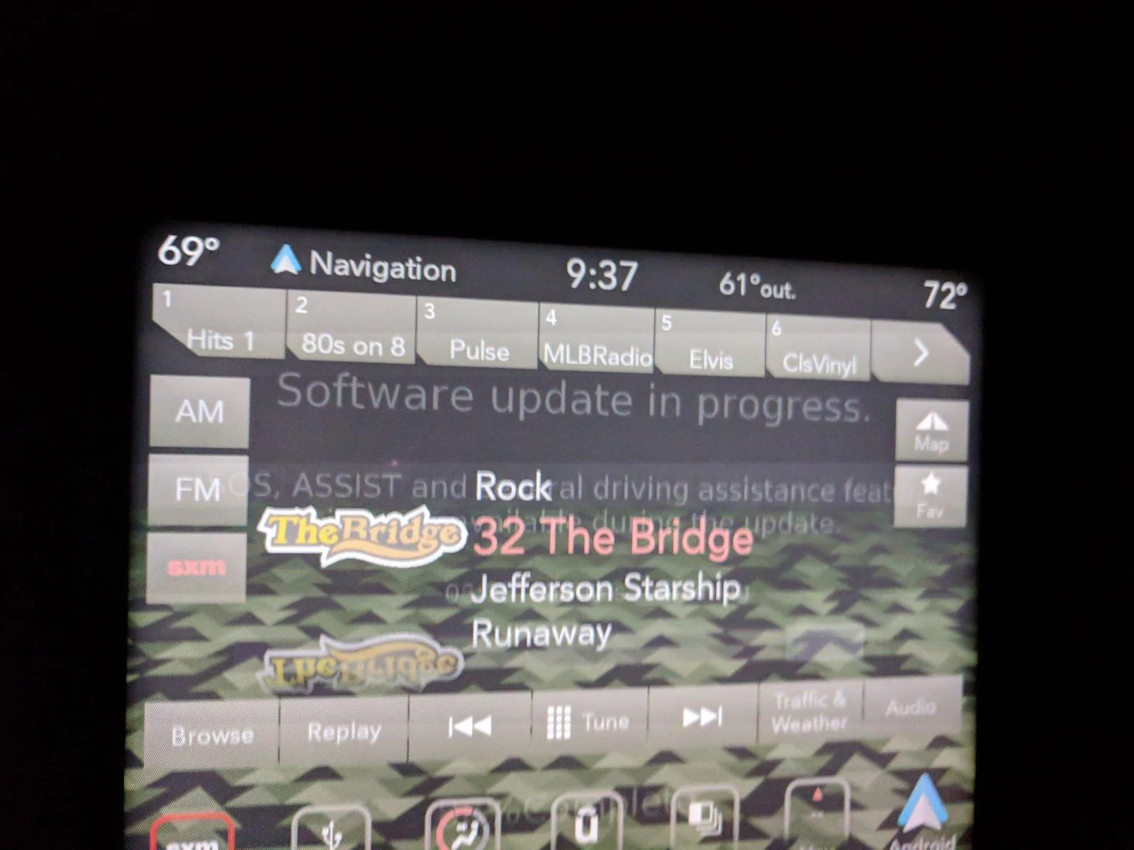

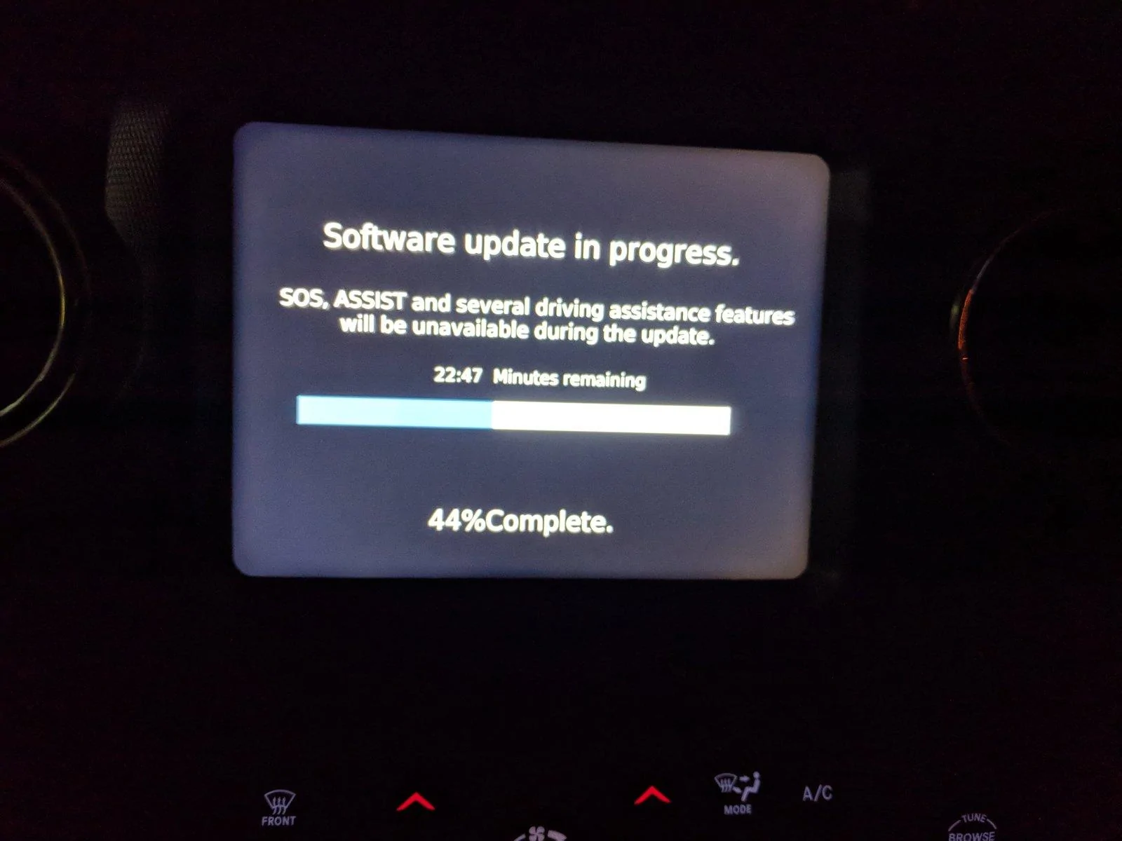

I had an interesting experience with the update. Radio started updated while I was filling with gas. There was a pop up asking to installed, I instinctively pressed it like I do the accept button on every car start., or worse the stupid advisory pop ups on every start. I need to find a way to quiet these. Then it locked me out for a half hour with the screen on full brightness (no ability to dim the screen or turn it off) while I was driving at night. SUCKS.
Then when it finished, after a half hour or so, the lettering bled through the screen and not all of my speakers were working. So I pulled over and restarted the car. The screen bleed was still there, but the speakers came back, but I think they broke android auto's audio. Every time the nav goes through the driver's speaker cuts out so the voice can come through, but then it never goes back to the music. That speaker just stays silent. until I press the radio power button off and back on.

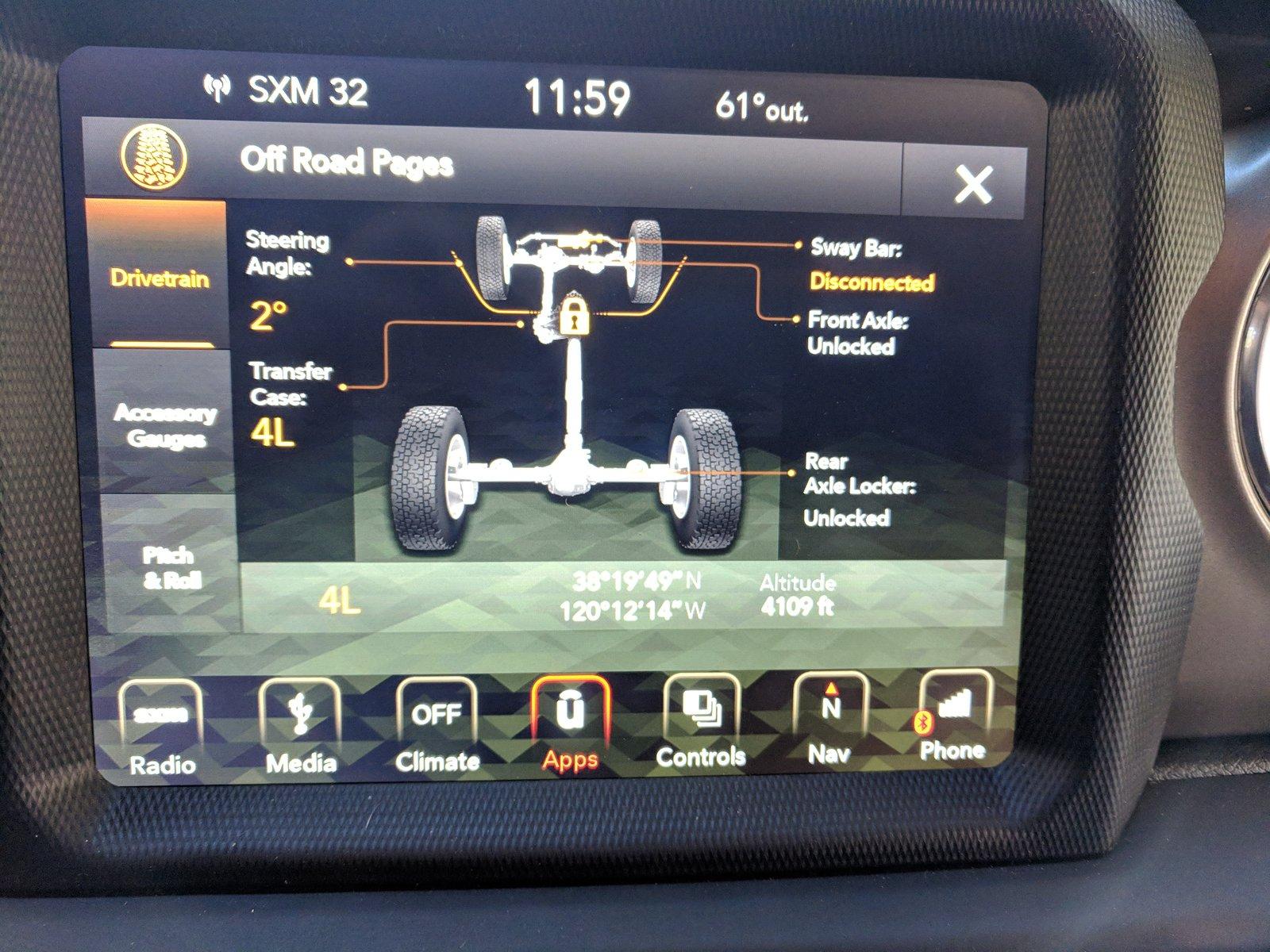

Good news, now I've got the offroad pages. The only thing available here not on the driver console is the steering angle, which is really useful. The bad news, it's not always there the moment I start the car. It takes a while (up to 5 minutes) to appear. Even if I'm already in the 4wd. I was wheeling under trees with terrible sat connection. I'm pretty sure the ORP app didn't appear until the music started. Which means it's somehow tied to the sat connection, which is a terrible design.
Does anybody else have experience with this?
