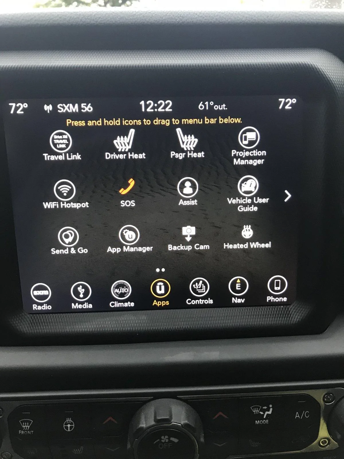

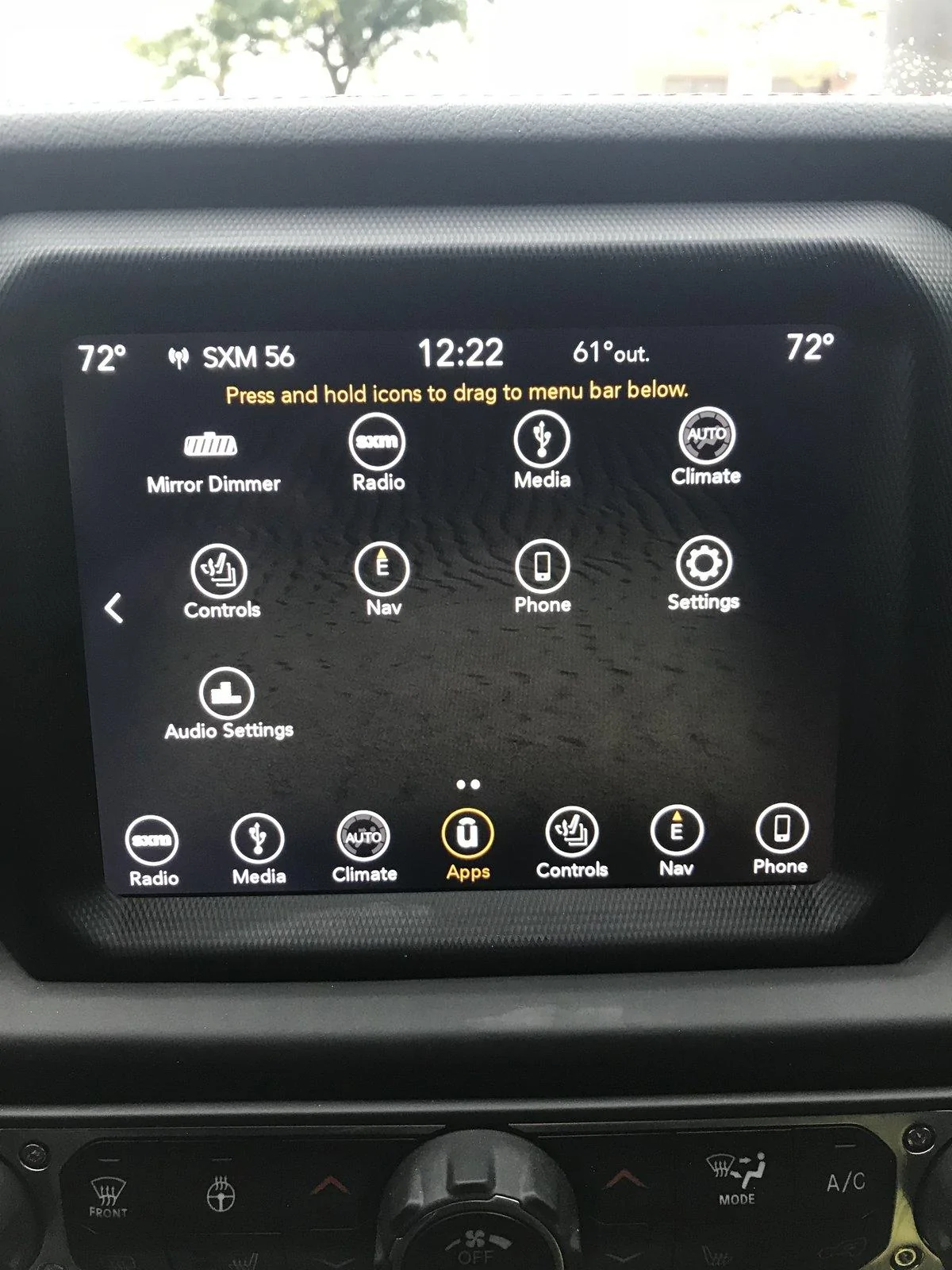

For whatever reason, likely bad software engineers, you have to wait a few minutes after the system boots up and it will appear again. Annoying and weird, but a fun quirk we have to deal with.
Nope!
Been in the Jeep for over an hour. No OR pages.
Jeep Wrangler JL Off Road Pages Update Status... 1E0B06D3-B3D2-4DDD-8212-426D30B91695
Jeep Wrangler JL Off Road Pages Update Status... F9969506-3CB6-4B8D-BCE0-9A56375D8483

Hi jmill012,
We have responded to your private message regarding this concern.
There may be another thread on here that I haven't found yet but in the event that there isn't, I'm starting this one.
I noticed over the weekend that the I've lost my Off Road Pages after the big OTA update that everyone was getting in the last week and a half ago or so. :angry: I've looked everywhere for them and haven't been able to find them. :movember: This is a bunch of horse-hockey as far as I'm concerned. What's up @JeepCares? The pages were working just fine after I received the OTA update and then, POOF...now they're gone! I thought we were good to go and that this was going to be a non-issue going forward but I guess I was wrong. Why push them out only to take them away??? I don't understand FCA's logic at all...but I do want my ORPs...I paid for them and I expect to have them! Has anyone else noticed that they've also lost the ORPs???
I lost my ORP's in may the day after I bought my jeep and haven't seen them yet. I've yet to get a update for jack shit and I believe there's been two OTA's so far.
Same here. Did the update, had ORP. Now, after a few days, gone. Sure would like to know what is going on.
Same here, got the update last week with ORP, and icon dissppeared again few days ago :(
Mine disappeared a day or 2 after the update which originally made it reappear.
