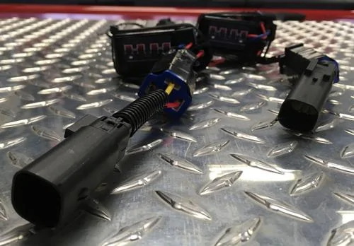

We have completed the first set of adapters that will successfully convert your halogens to Mopar LED. Plug- and - Play. No Tazer or re-flashing from the dealer is required. Simply plug in our adapters to correct your flickering, turning off, and high beam/low beam not working properly. we will include our fuse-taps as well so you can connect easily to your fuse box or you can tap into the parking lights so you control when the halos are on or off.
contact us for more details
Jeep Wrangler JL OEM LED headlights JL HL ADAPTER2
Jeep Wrangler JL OEM LED headlights JL HL ADAPTER3
Jeep Wrangler JL OEM LED headlights JL HL ADAPTER4

The factory computer doesn't like when we switch to OEM Mopar LED. Many times there are other issues when swapping the halogen headlights to LED. As mentioned in these posts, usually the high and low beams do not work correctly ( the low beam shuts off when you turn of high beams) and after a little while the headlights shut off. Our adapter harness will fix these issues and your halos can be wired easily.
The whole conversion should only take 2-3 hours for everything. You can do everything in a day. I would swap the headlights and leave the halo wire in the 'area' make sure the headlights work properly then move onto the turn signals. We are authorized dealers for Morimoto and The Retrofit Source as well and can beat most prices.
Also the bulb on factory halogen is H13, but the factory connector into the bucket is not an H13 on the JL.
