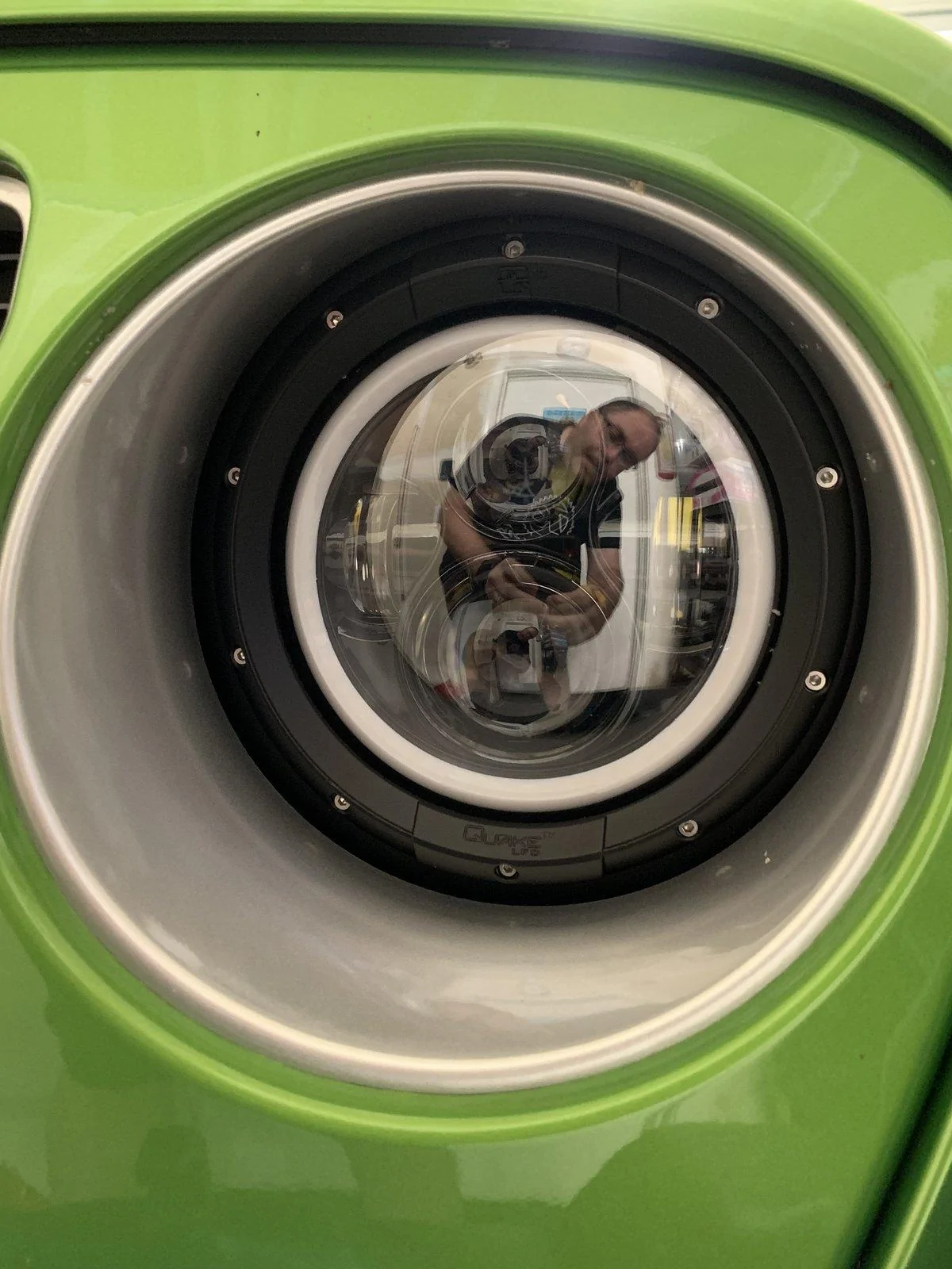

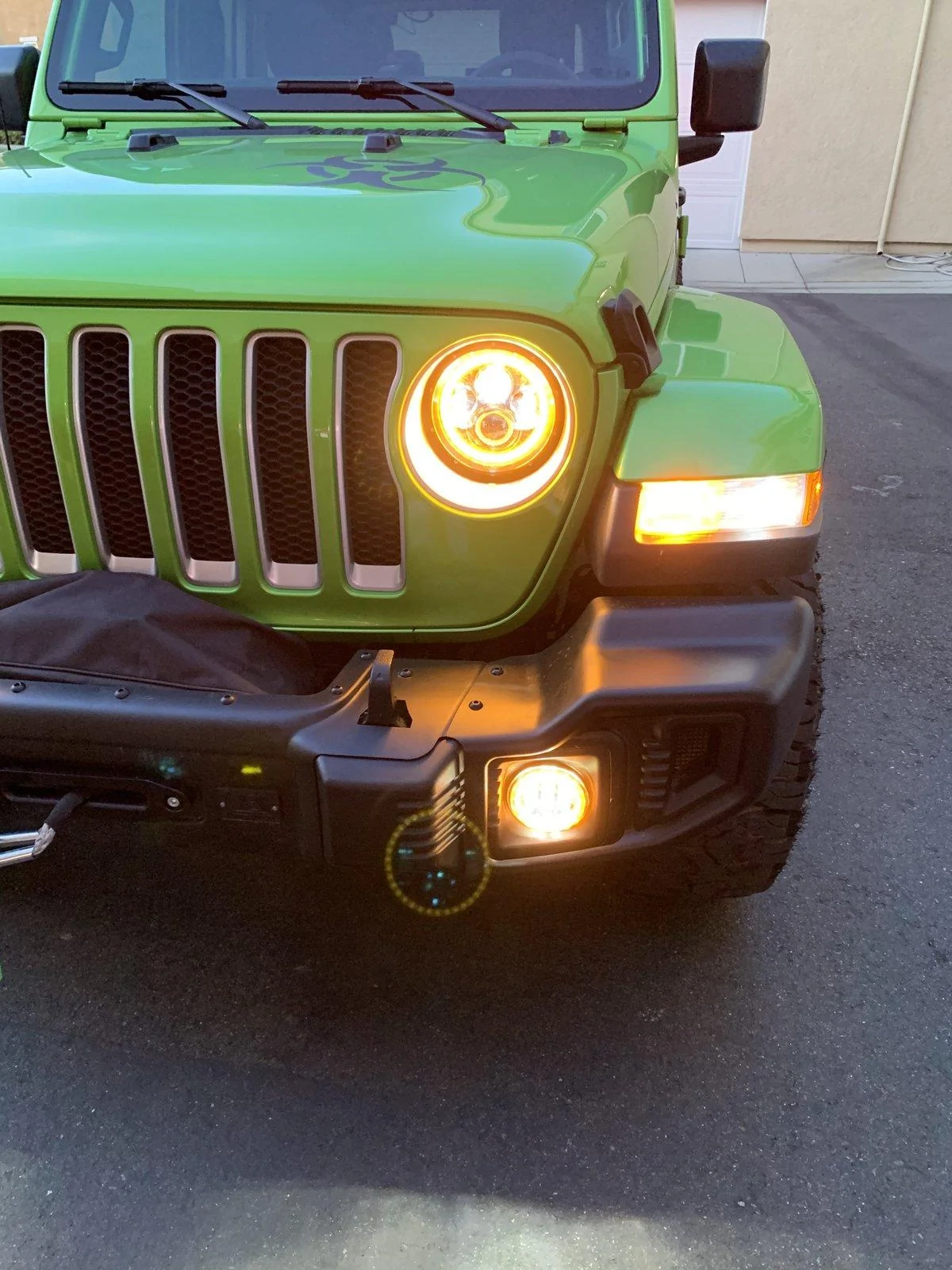

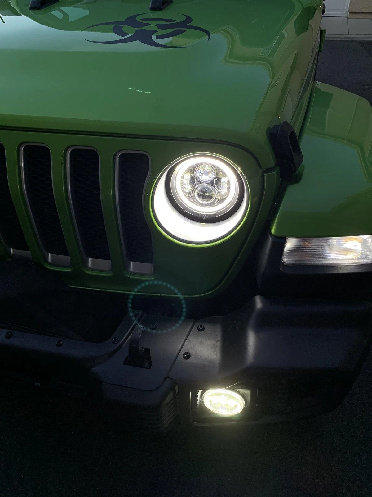

I ordered mine from jeepsareus.com on Thursday and they arrived Saturday for $760ish. Already installed them and flashed with Tazer. I believe the low beam and high beam work, but halos won't come on even if I selected enable halo on Tazer.
Didn't they come with a new wiring harness that had a 4th wire for the halos?

Yes the kit had a fourth wire that plugs directly from the light molex connector all the way to bcm c1 bus pin 5 and 7. And an update, I was able to play with Tazer by switching the option to enable halo on and off 3-4 times. The last attempt turned my halos on completely and they stayed on since.
