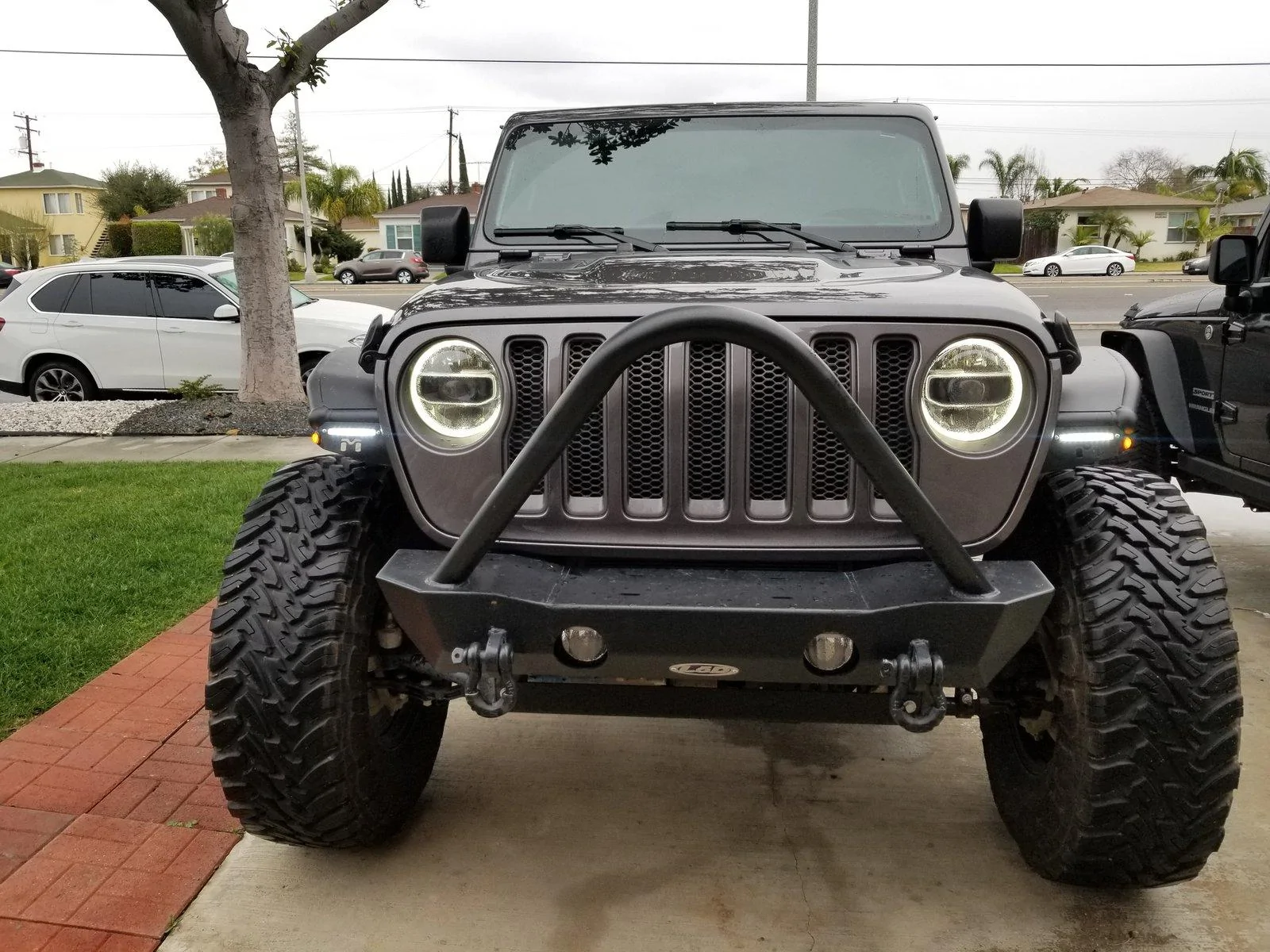

First off Huge Shoutout to @EgGreg for the wiring adapter, second @dcdanny for the help and pictures to power the halo wire. Dealership flash was $175 not $95 but still worth it everything works flawlessly!

Sheesh. I sorry about that. Out here in cerritos dodge it was 95.. but on another note. Looks BEAUTIFUL!!!

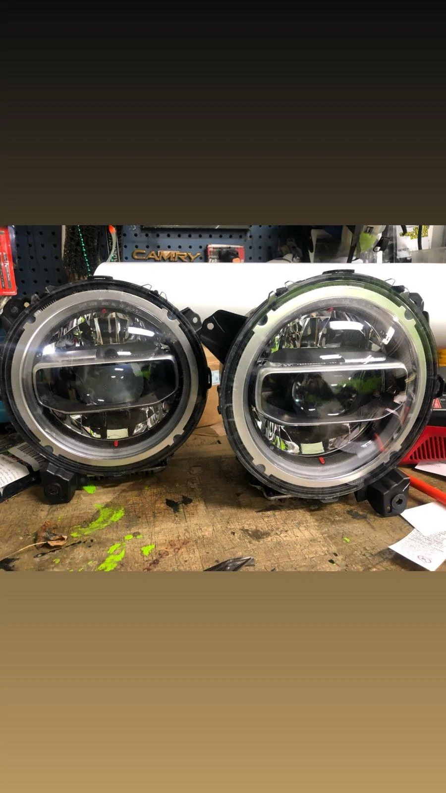

Do the OEM LED housings have a reflector or projector?
I've been reading about this snow problem not melting from the stock LED lights. I was thinking of putting in HIDs into the housings, but read you shouldn't do that with reflector housings.
And that's what's listed on Jeep.com price/build, LED reflector

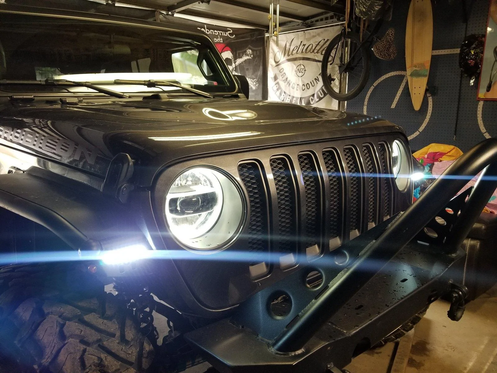

SUCCESS!!!!!!
Greg YOU ARE A GENIUS!!!
So you just took an oem LED housing, and put beamtech LED bulbs into them off of Amazon? Do you have that "the snow won't melt" problem?
