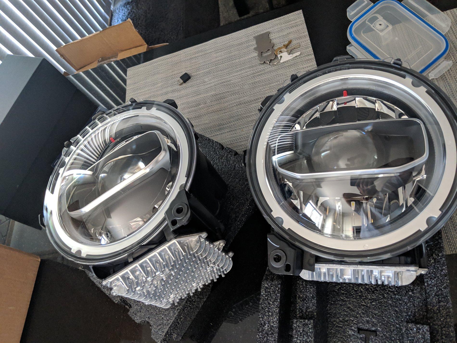

Same thing I did. Wired right into the cigarette lighter fuse. Works perfect. Haven't done the tazer yet. But the dealership fixed the low/high for meFrom factory, the JL halos turn on when you start the vehicle. For this build, I wired the halos to the cigarette lighter fuse so they operate as they should. I will be tapping into the BCM with this next JL and plan to activate using the Tazer. Just be aware you will need a module to make the low beam/ high beam operate correctly. You can contact me for adapters and modules. Everything is plug and play
What's your adapter like for tapping into the BCM? I thought with a flash or tazer we would no longer need a module to make low/high beams work properly.From factory, the JL halos turn on when you start the vehicle. For this build, I wired the halos to the cigarette lighter fuse so they operate as they should. I will be tapping into the BCM with this next JL and plan to activate using the Tazer. Just be aware you will need a module to make the low beam/ high beam operate correctly. You can contact me for adapters and modules. Everything is plug and play
I much prefer having the halos hooked up to the BCM like factory but for now our only solution is a fuse tap.to make the high beams work properly, you don't need a flash or Tazer. I have a module to fix that issue.
Yes, If you tap into the fuse panel, that works perfectly but is not to factory specs. In my opinion, I would prefer to wire the halos right as if they came from the dealership. Then working with Tazer, we can enable through the BCM. I have not tapped into the BCM yet, I plan to work on that next week when I get another JL to play with. I have a shop in NY
Looking forward to your findings.to make the high beams work properly, you don't need a flash or Tazer. I have a module to fix that issue.
