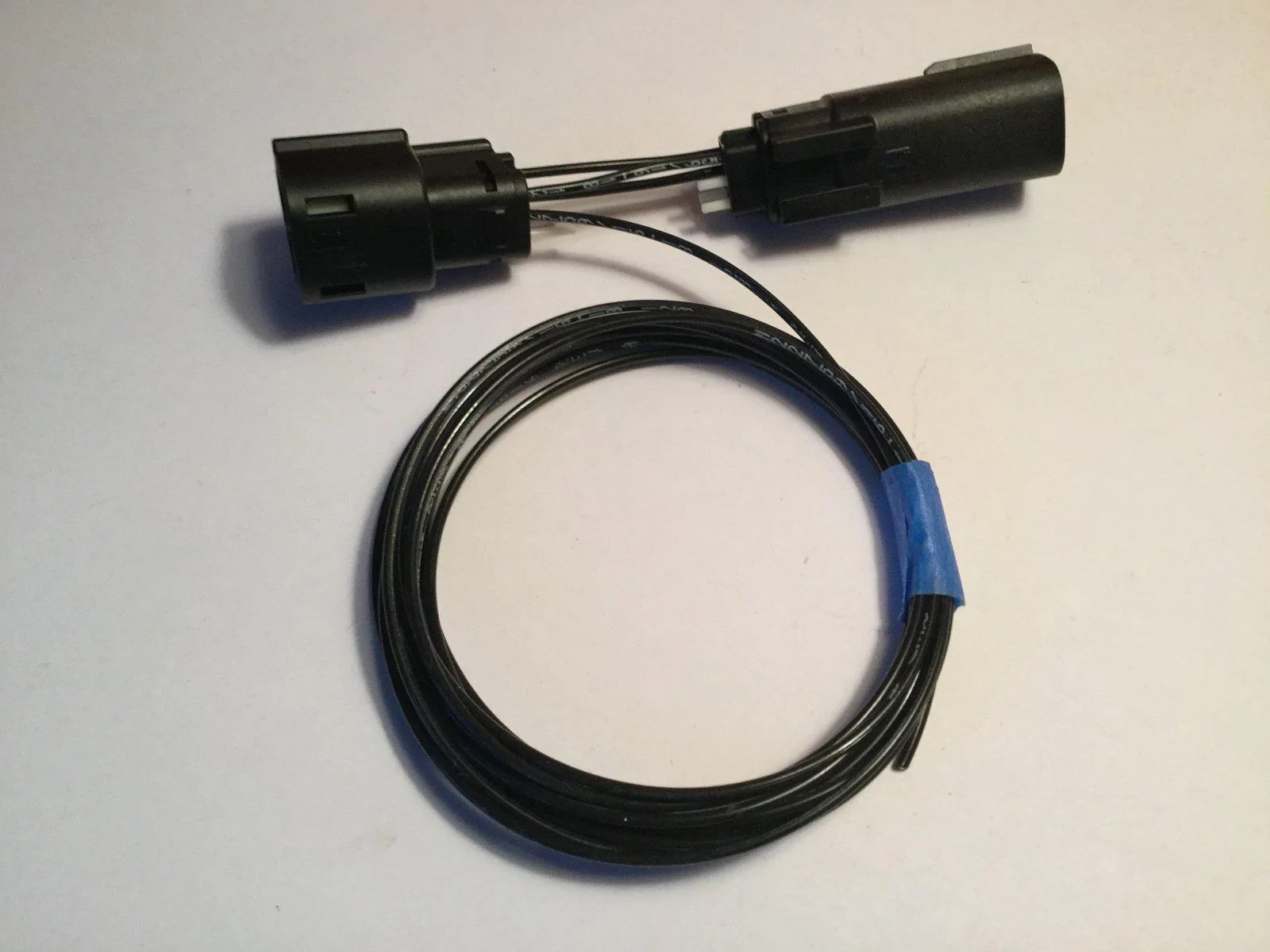

Thank you. If you want to hold off on the 4th install for a couple of days, this might make it easier. Just tell me wire lengths you want.
Hey Greg,
Am I correct that this is for the head lamps?
EgGreg
Jan 25, 2019
Upstate NY
2003 Jeep
Hey Greg,
These are for Just for getting power to halo. I was working on a pnp adapter harness but it turned out to be a good amount of work to make it nice. Plus it incorporates anti flicker modules, that could eventually go bad. So do you make the harnesses with extra connections so the flicker modules can be removed/replaced.

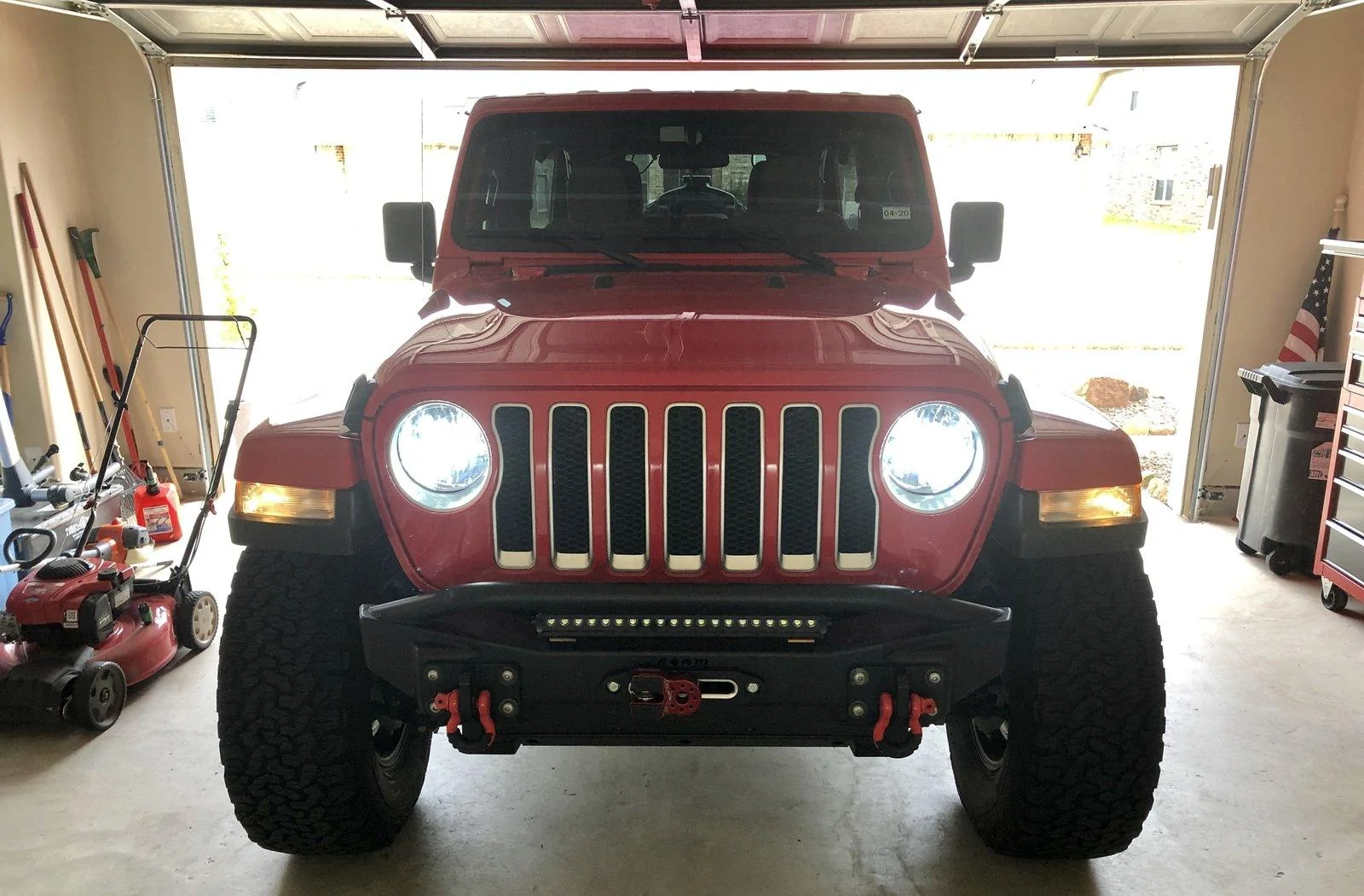

Then Danny and a few others confirmed that a reflash solved all the issues with installing these headlights (in regards to flickering and the low beams staying on with the highs) which is definitely the way to go.
crothrock2000
May 21, 2018
88
30
Northern Virginia
2018 Jeep JL Sahara
I can confirm as well - went to the dealer for a reflash to LED and the hi - low issue has been fixed.
