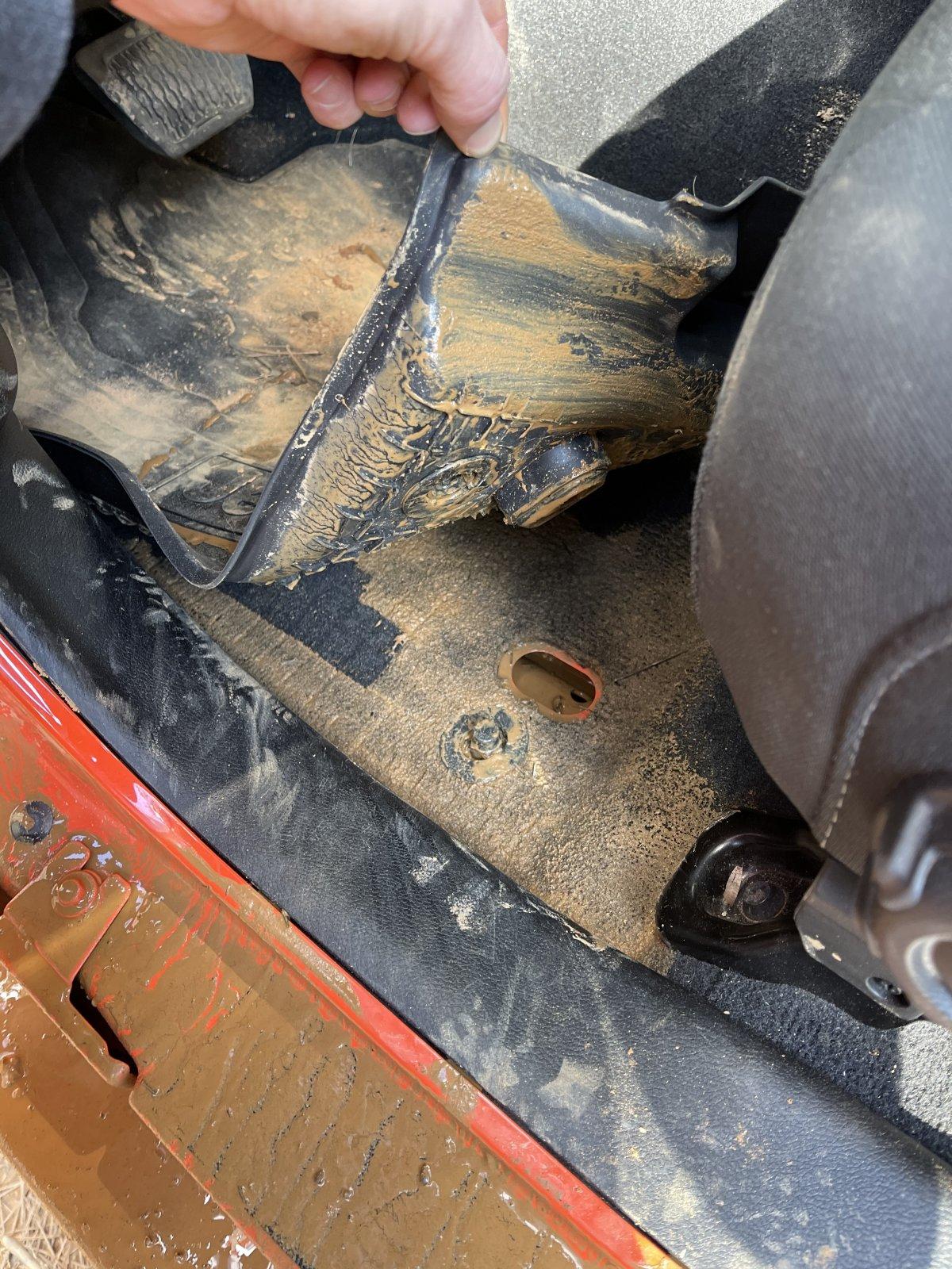

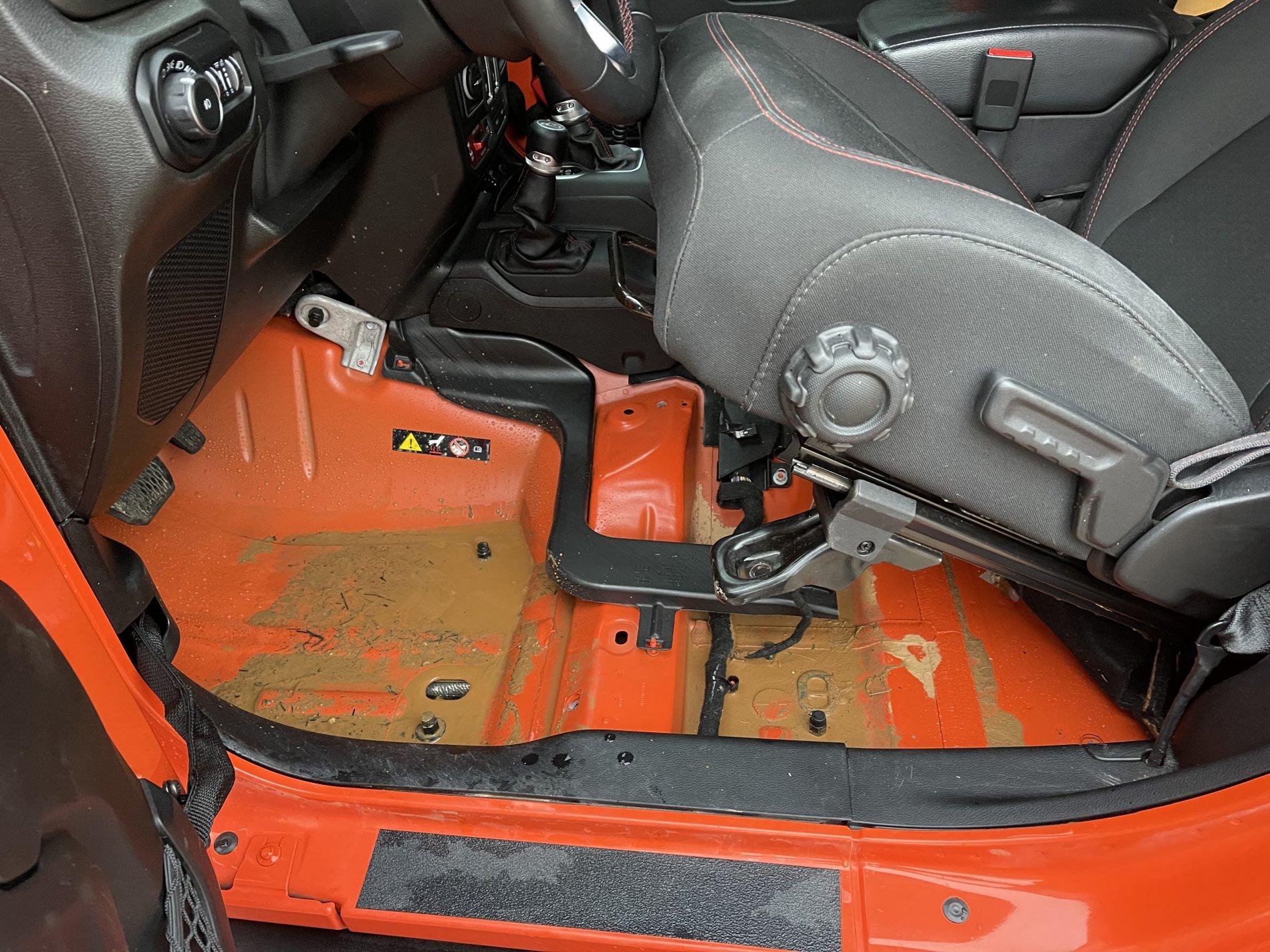

So if you happen to go mudding, and you think you can just have the all weather mats drain plug in to the stock drain plug, and then have the mats plug plugged... think again. I hit some big holes and wish I had the drain plugs just in the drain holes and the mats on top of that, having the mat between the floor plan and drain plug failed and I took in mud.

I wasn't comfortable with the design myself. I carefully used a razor knife to trim off the bottom socket so it was flush with the mat. Then I purchased 2 more drain plugs for the mats, which I put in from the top and they perfectly hide the hole. I just left the factory plugs in place for water protection. 2 more plugs would save you money vs buying new mats.

Not a bad idea!

I was thinking of sealing the plugs to the sheet metal floor pan with something semi-permanent but possible to remove if needed. Next came the thought of plugging the rubber mat itself so I’d need to order an extra set. Mine originally came with just the mat itself plugged. I looked underneath the plug and noticed the ā€œfunnelā€ for getting the water from the floorboards out didn’t even reach far enough down to clear the floorpan. It would definitely let water in like that.
