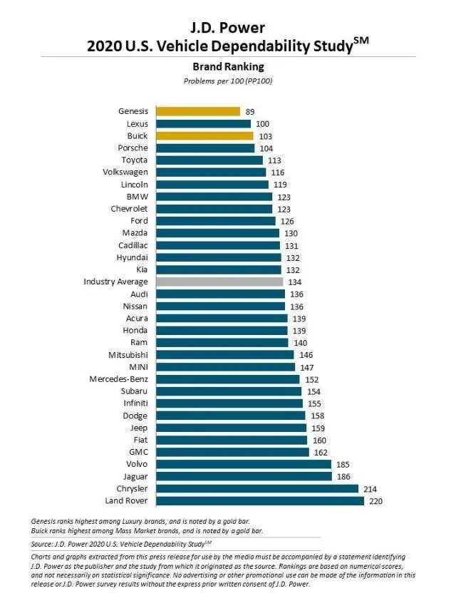

The Takata airbag scandal —and ensuing bankruptcy— has hit Japanese automakers hard, and Honda in particular. Honda has had to pay out of pocket for most of those very expensive retrofits. And there’s growing evidence that Honda has cut corners elsewhere to recoup some of that money.
Between those faulty airbags, the trouble-prone ZF 9-speed automatic transmission it uses on Acuras and high-end Hondas, and Honda’s never-ending issues with its infotainment system, Honda’s standing on the reliability charts has fallen dramatically from its former glory.
Jeep Wrangler JL Not Starting Jeep "THING" 1600882387141
