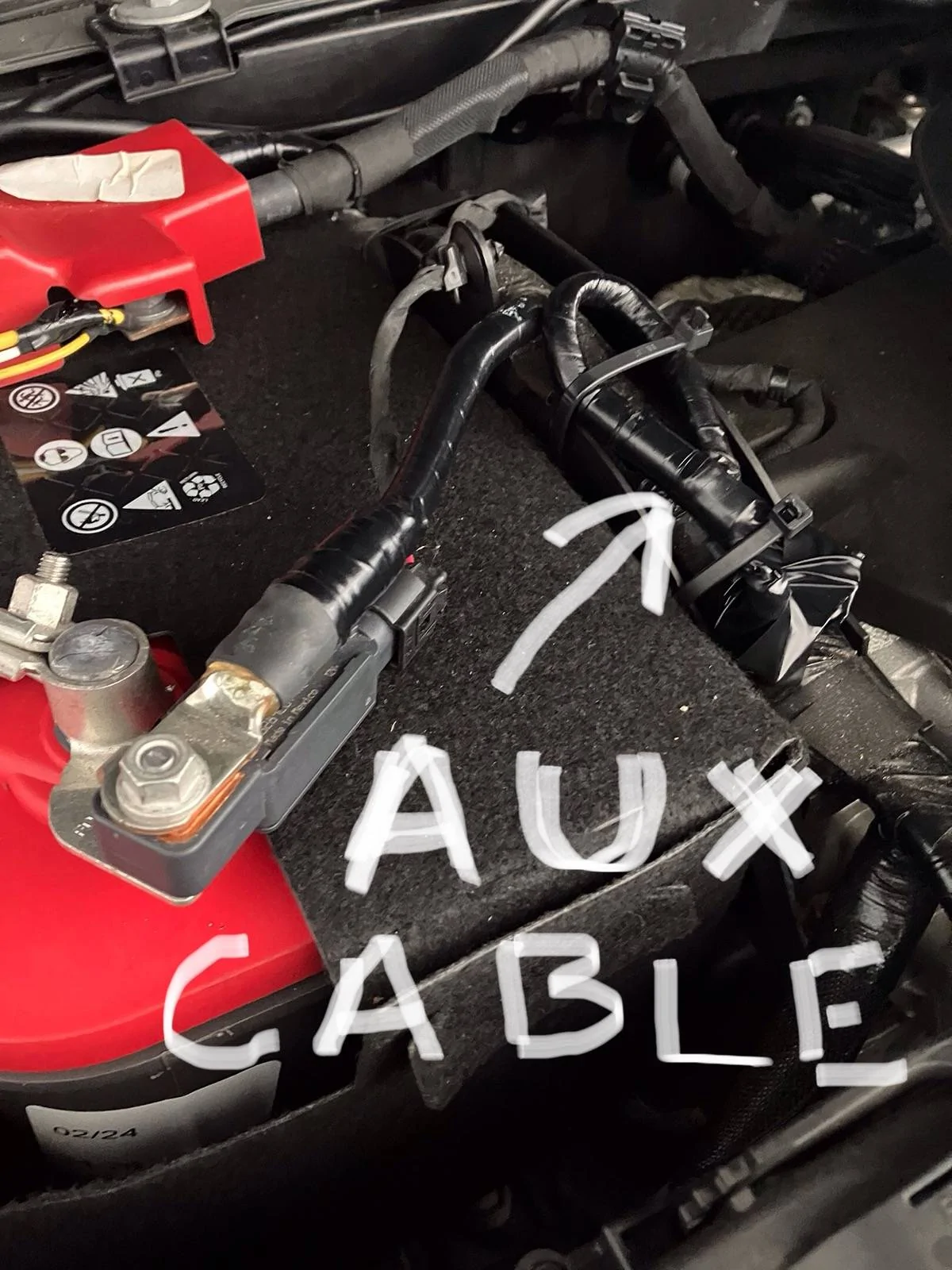

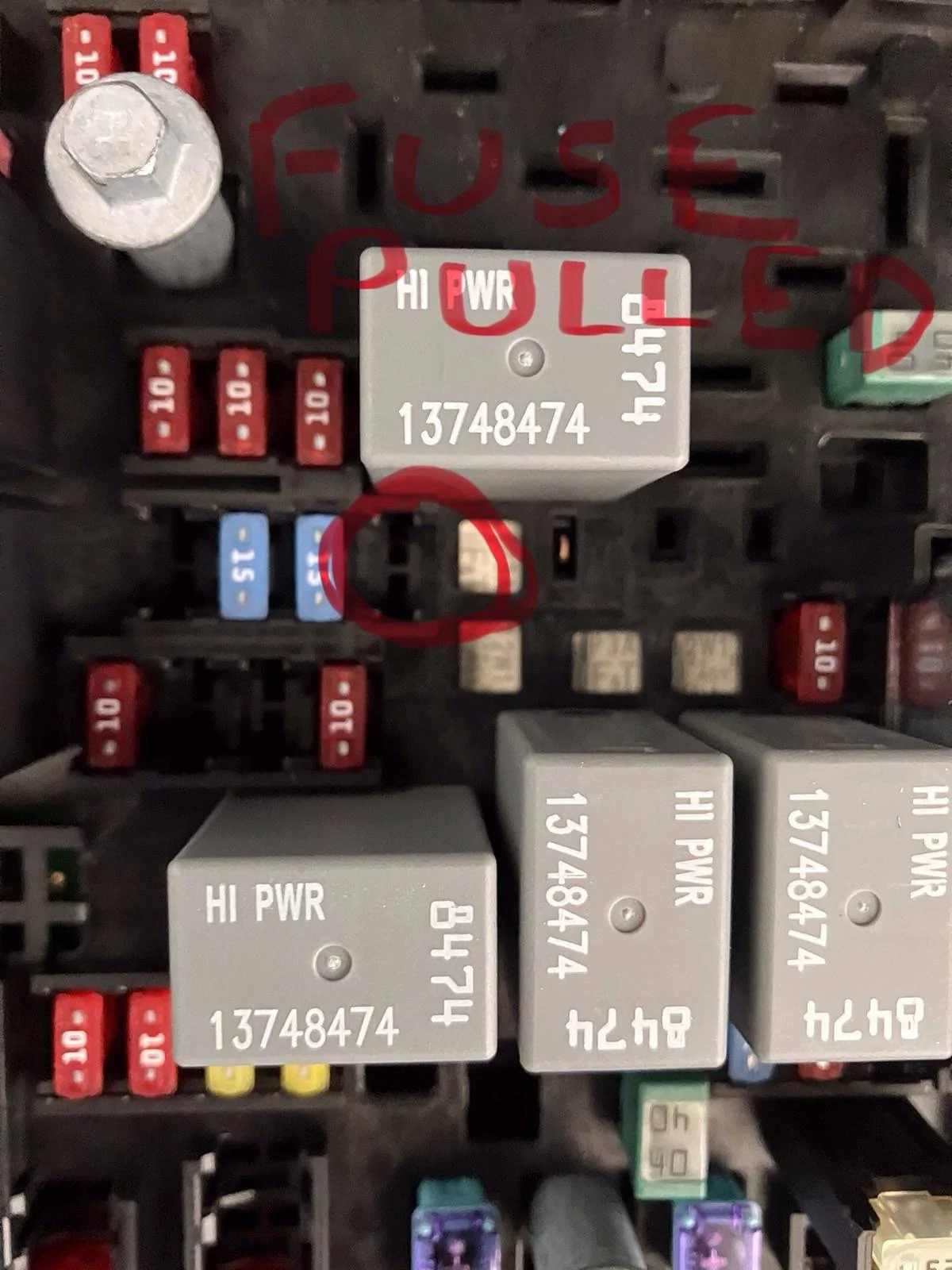

By-Pass done. 20 minute test drive showed no ill side effects, no warning lights or messages. Should be good to go.
Jeep Wrangler JL NOCO and dead battery IMG_2013
Jeep Wrangler JL NOCO and dead battery IMG_2014
