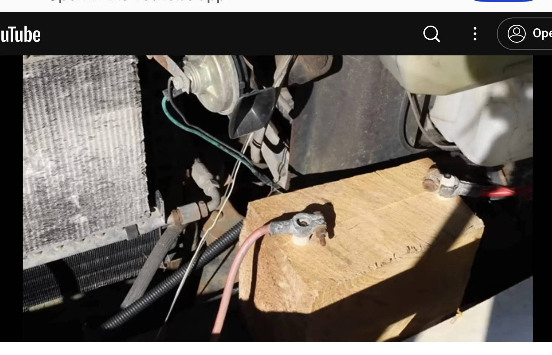

I have the Noco GBX155 with 4250 amps. It will start a commercial box truck no problem with a dead battery that will not take a charge. It is a beast. I spent the money to not worry about jumping a passenger vehicle.
Project Farm started a RV without a battery. He drilled two holes in a wooden block, put the terminals in it, then put it in the RV and this Noco started it.
