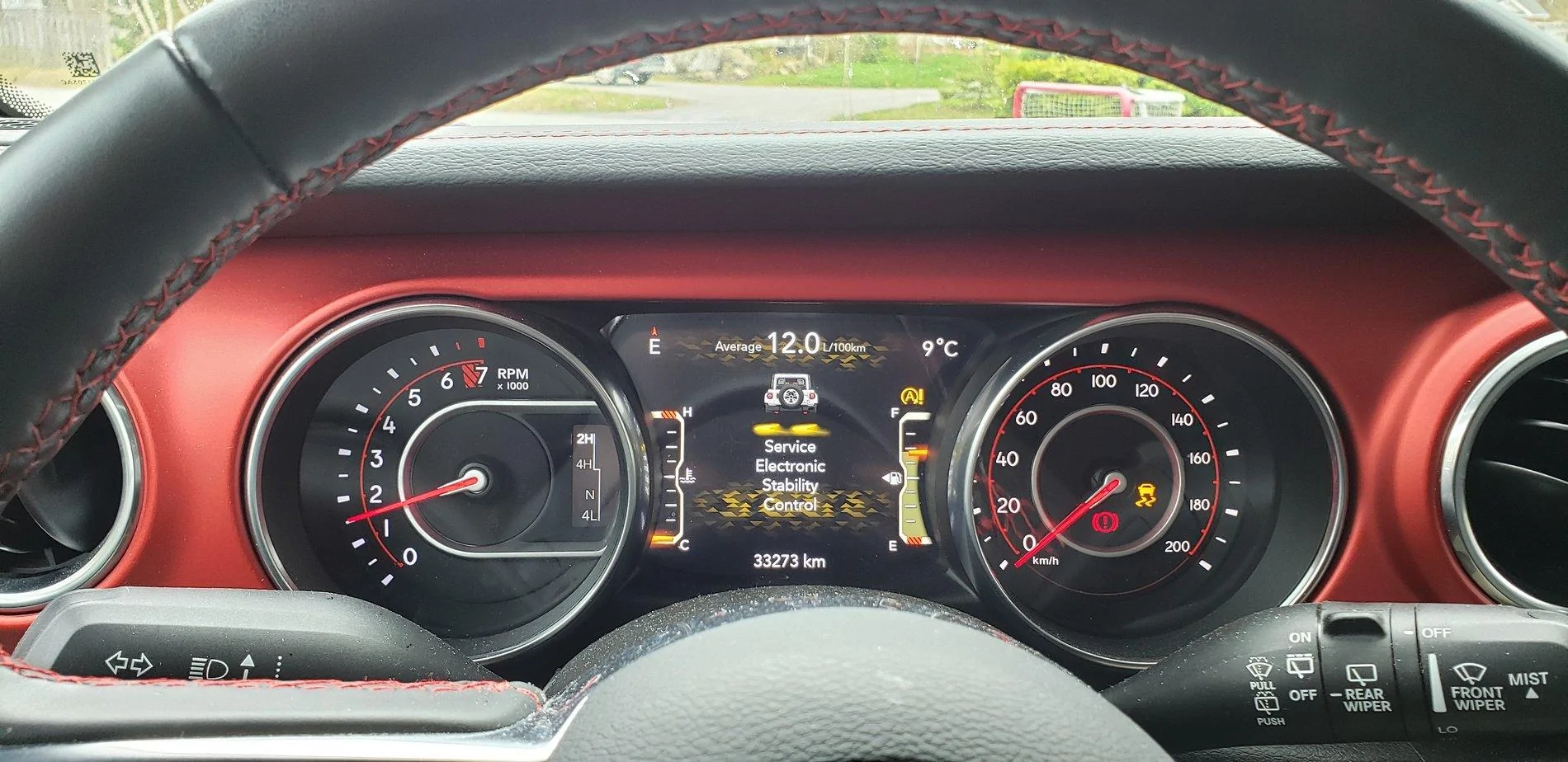

CRZYCDN
Matthew
Dec 14, 2018
272
106
St-Lazare
2024 JL XR Unlimited
Jeep Wrangler JL ESS battery dead 20200511_165638
By chance will the ESS battery cause the Electronic Stability Control to disable as well?
Jeep is at the dealer to get figured out but this had happened twice over a couple days ....after the check engine light and electronic sway bar disconnect ...and auto start...and ESC waring all came on...
Thoughts?
Thoughts?
it could - once you get into a low battery situation all those things start playing up
