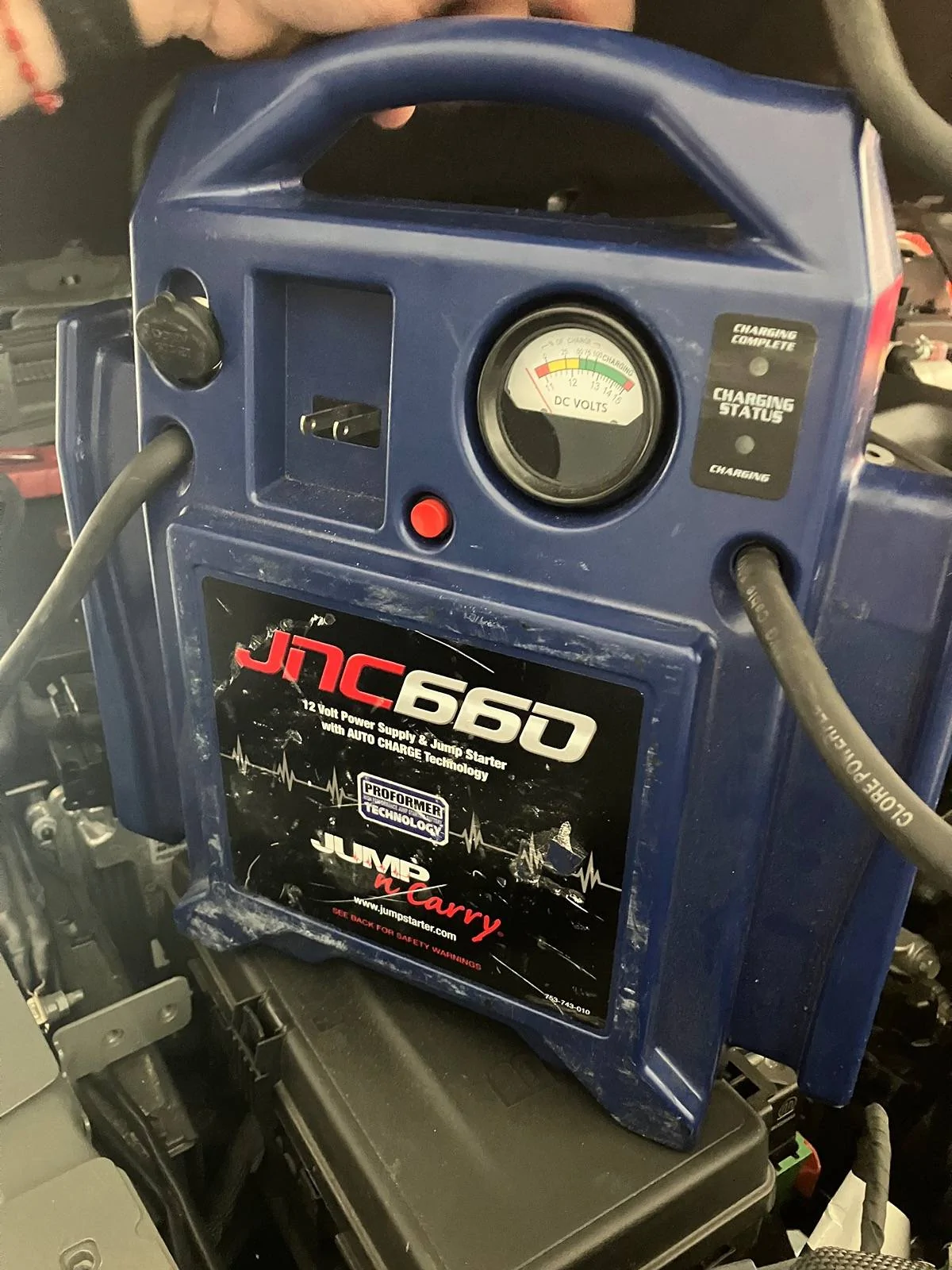

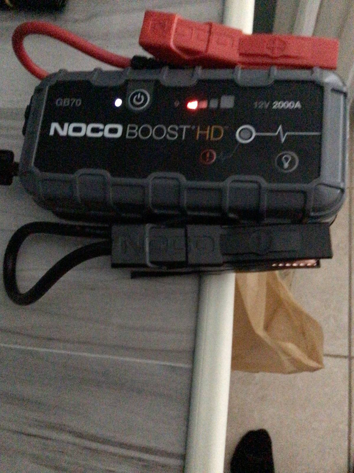

Attached is a picture of AAA guy's pack he used. Also attached, my NOCO currently charging.

You know I trust a tow truck guy to operate a tow truck maybe but as far as anything else no. He got lucky his had enough juice to do the job that's all.
For what it's worth my sister runs a repo company and the number of tow truck drivers that she's had to fire because they did something so incredibly stupid as to defy all logic is pretty high.

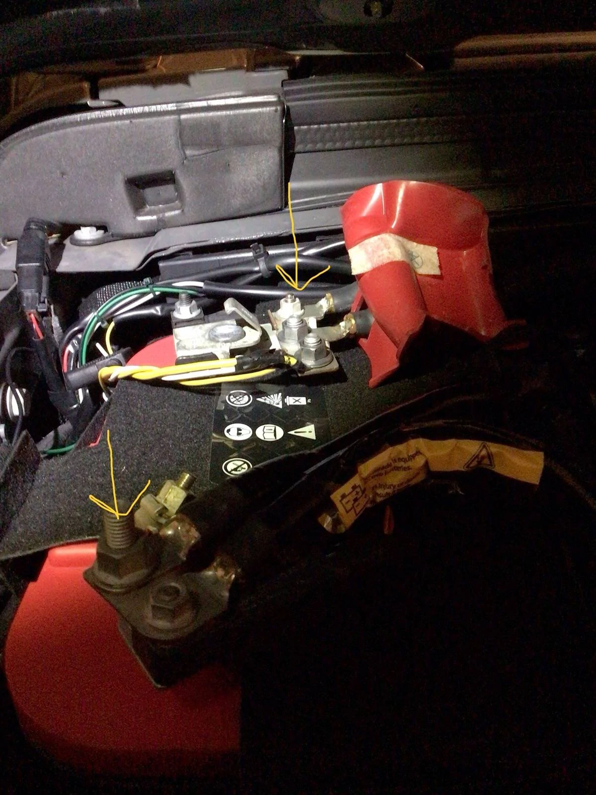

Not sure why my unit did not do the job. I am positive it had 4 bars of power and green light illuminated. Only thing I can think of is, not connected properly, somehow, but while it was connected, the battery took in juice from the NOCO lowering it to 1 bar.
Now that I think of it, first time using NOCO may have been my operating error. I connected NOCO clamps onto the nuts pointed to in yellow. Perhaps using those nuts was not right? I did have positive clamp on positive side and negative clamp on negative side.

Your NOCO was competing with a dead battery to power the starter. By the time the tow truck driver got to it, you had less dead battery.
Ever try to open a jar and can't get it to budge, then a kid asks to try and you humor them only to watch the lid come right off?
It's like that.
