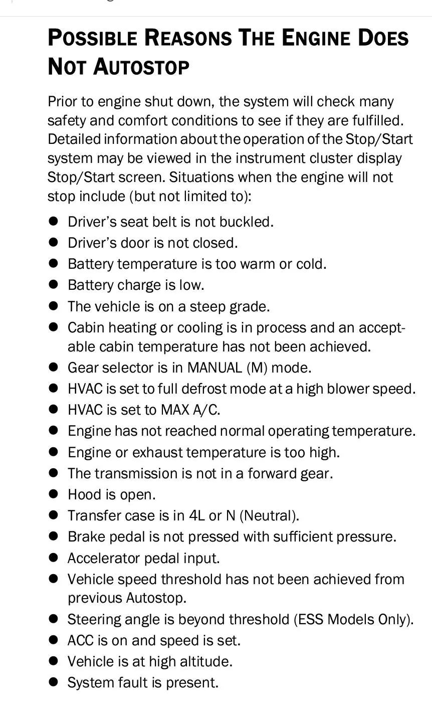

If ESS on a JL is not working after an Aux battery bypass or Aux battery delete, then something is a muck with the JL.
Without question: When you bypass the Aux battery or delete the Aux battery, ESS still works on a JL or JT. No, you do not need "to do some wiring tricks to make it still work."
I just pulled the cable off of the terminal. That was about 3 years ago, ESS has never worked since then. I looked at the posted list and none of those apply however that's a lot of individual sensor inputs to check and any one of those sensors could be bad. I never wanted ESS so I have no incentive to troubleshoot it.
