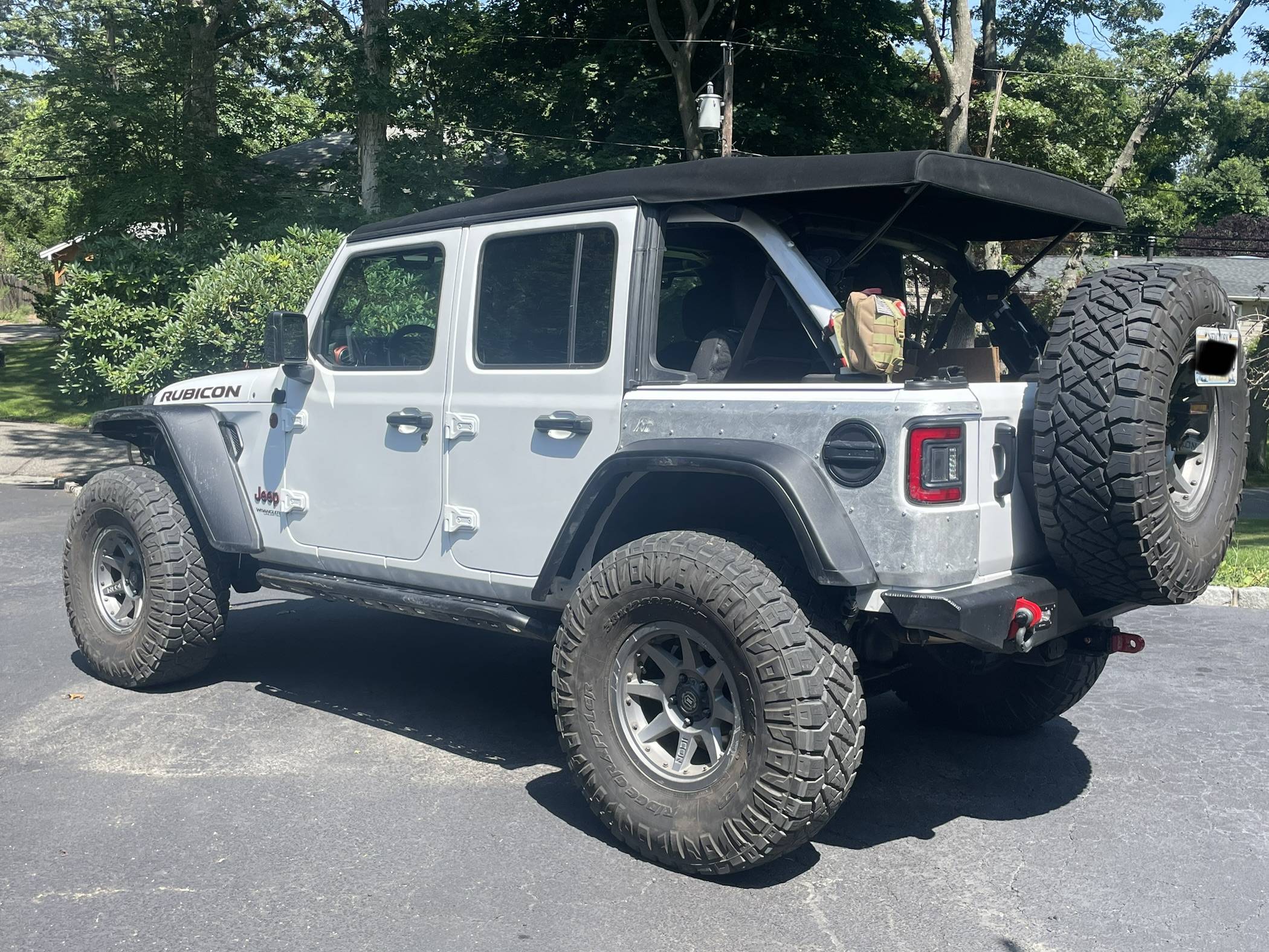

Just finished up getting the corner armor installed. Went with Aluminum. Definitely not a fun project. Drilling 44 holes through the body had my anxiety through the roof. Tomorrow they go in for paint.
Im on the east coast - so I want to seal the corner armor from allowing dirt and water behind them and potentially down into the the rivnuts. What does everyone recommend to use as a sealant that is removable and wont damage the paint?

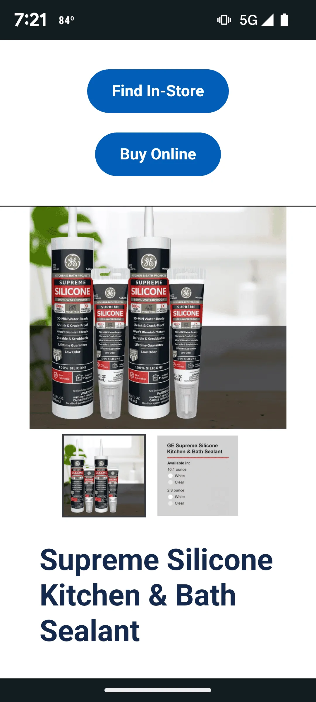

I like GEs best 100 percent silicone calking. They say it will hold up for 50 years. Resistance to mold a mildew etc.
I used it on my gutter on back of the house where the pool was. 20 years later the aluminum gutter was corroded but GEs best was still perfectly in tack, no mold nothing and still water tight.

No, I believe they have changed the name. It now says "supreme" on it.
Of course they don't advertise it for the use you are wanting to use it for. I have just had really good luck with it. After my first use, I continued to use it over the years and it has never let me down.

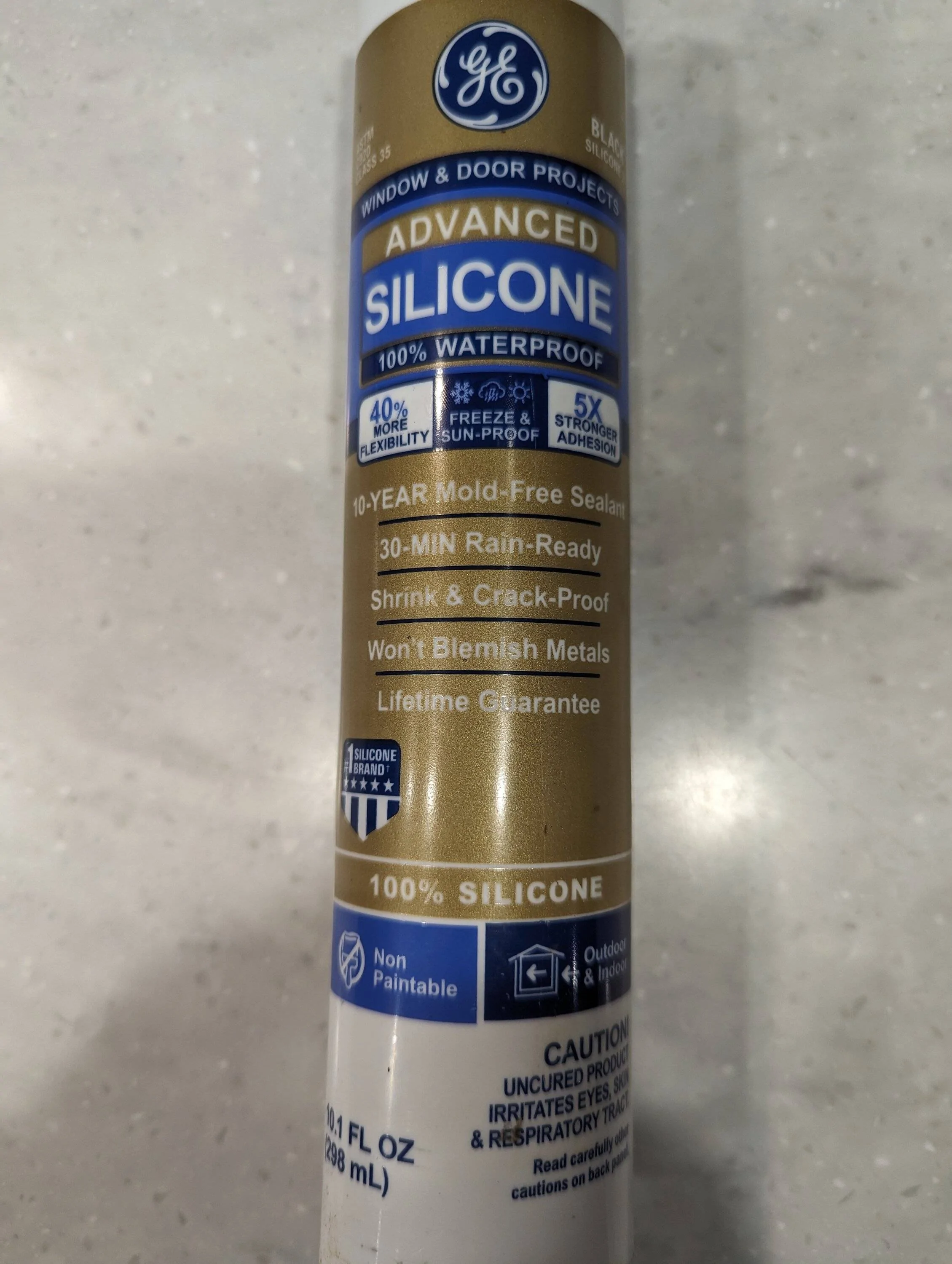

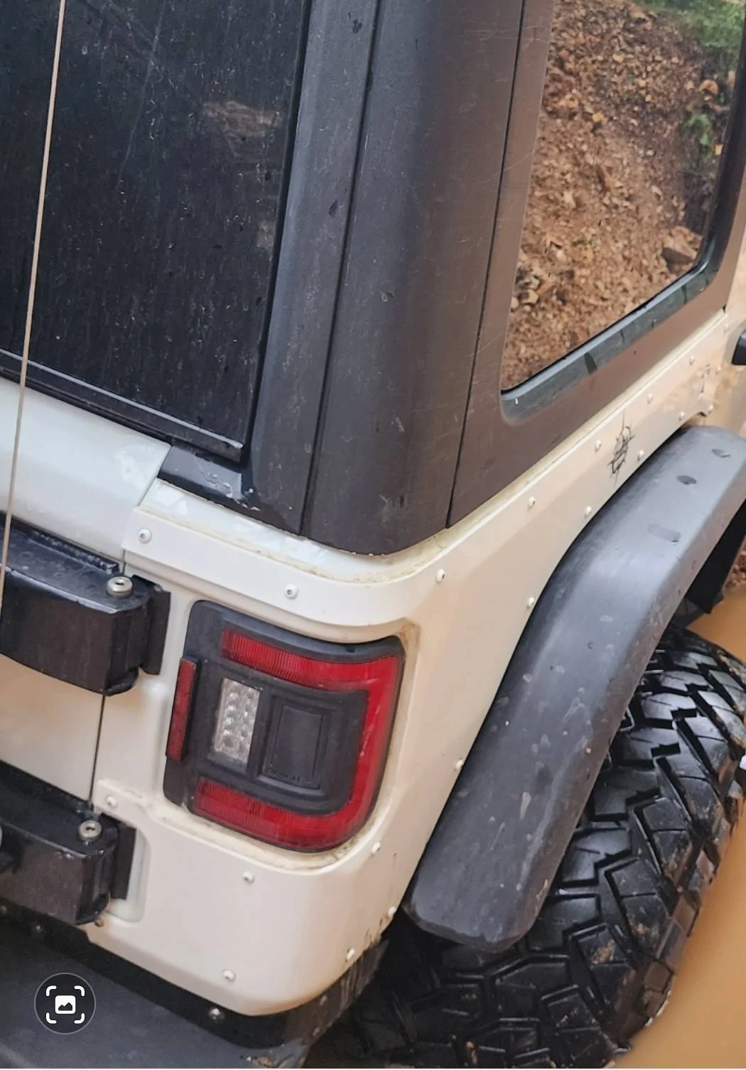

I used the white advanced GE Silicone...
I did the top, sides/corners and left the bottom side open...
Jeep Wrangler JL Next Venture Corner Armor install 20230823_085238

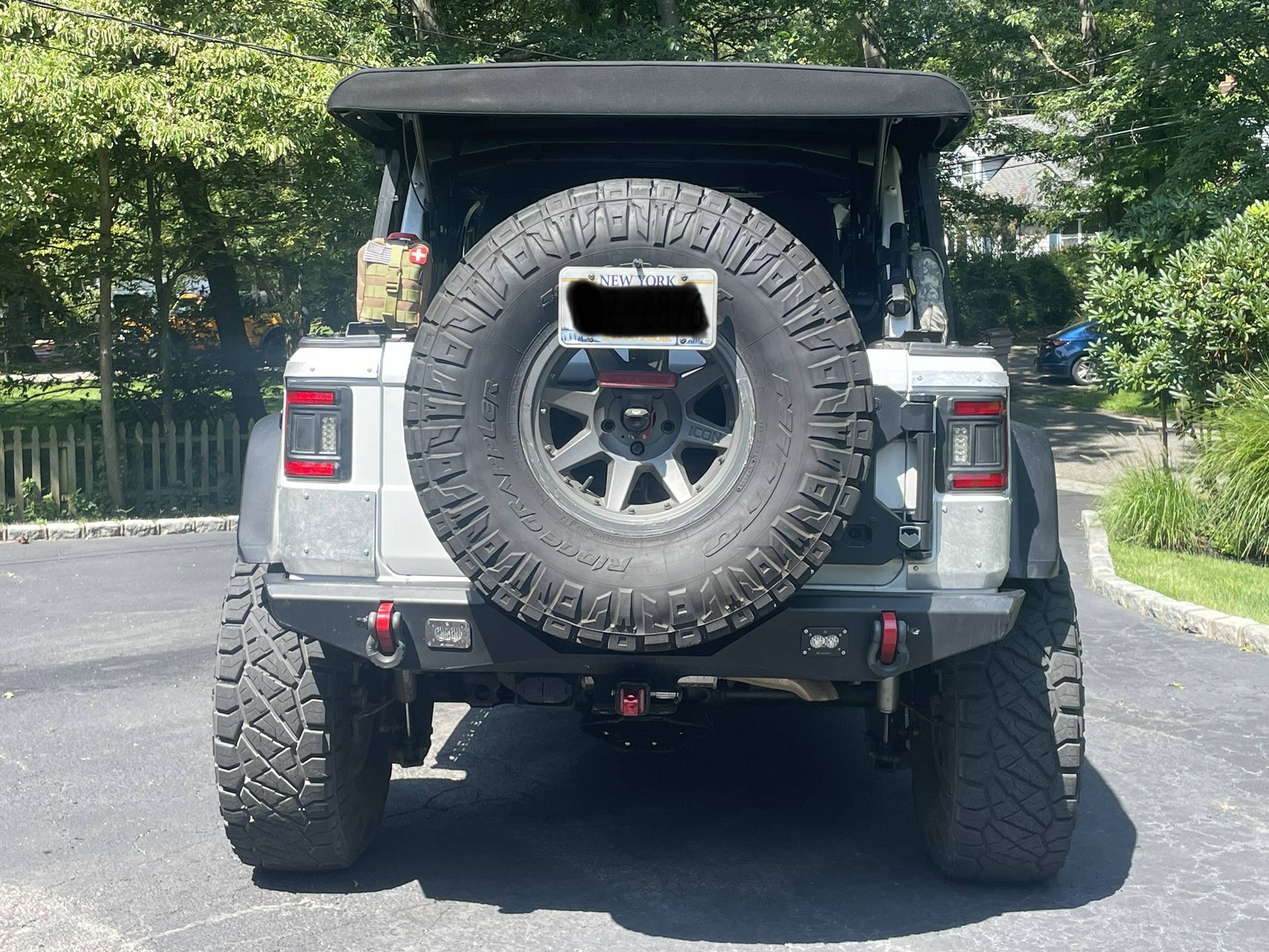

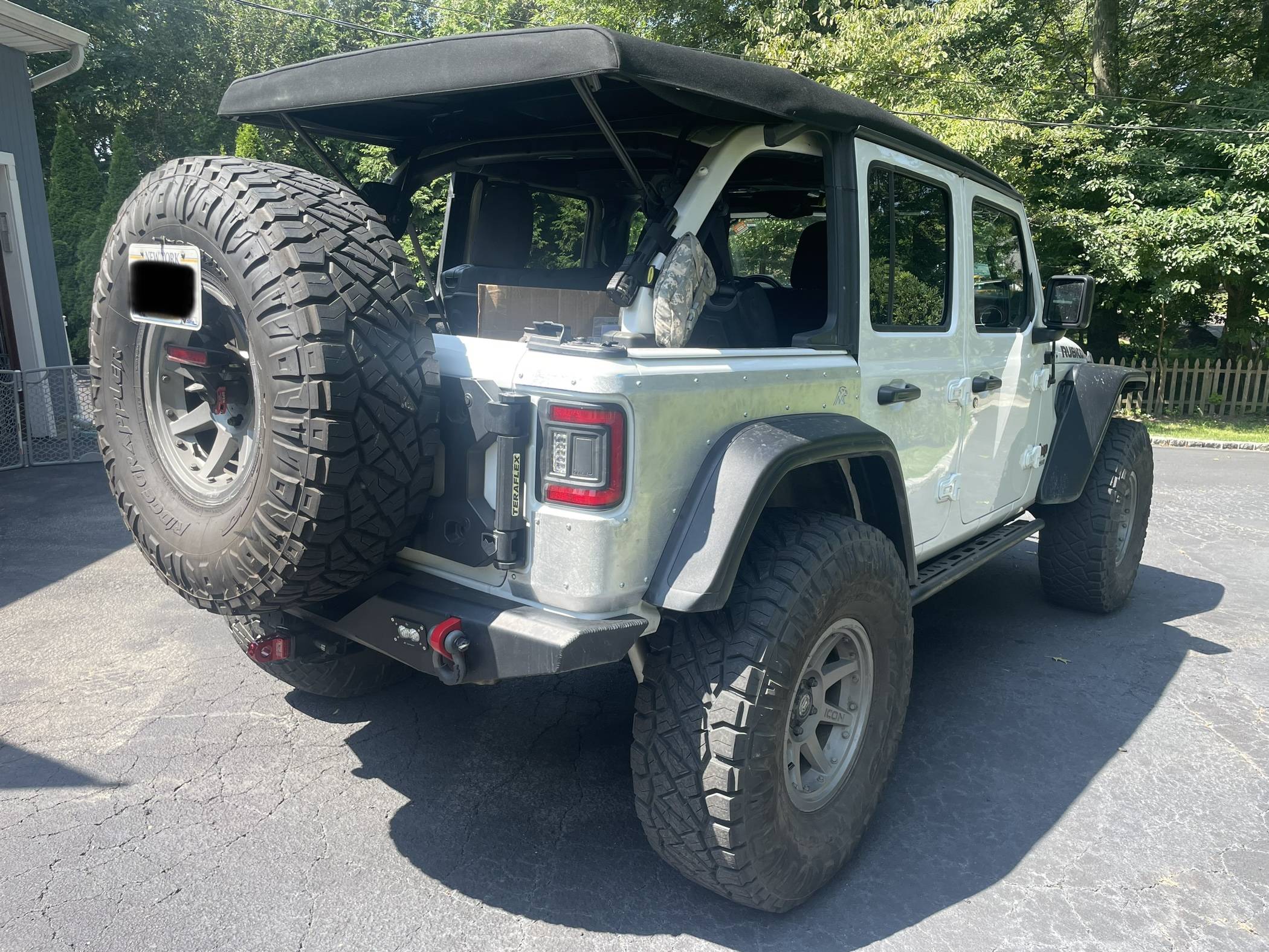

feel like im looking at my jeep! lol. I have the teraflex tire carrier which has a crossbar between the hinges. if you look at my pick from the back, youll see I had to cut that tab above the hinge from the corner armor and then tap a new hole. no way was I remove the whole carrier.
