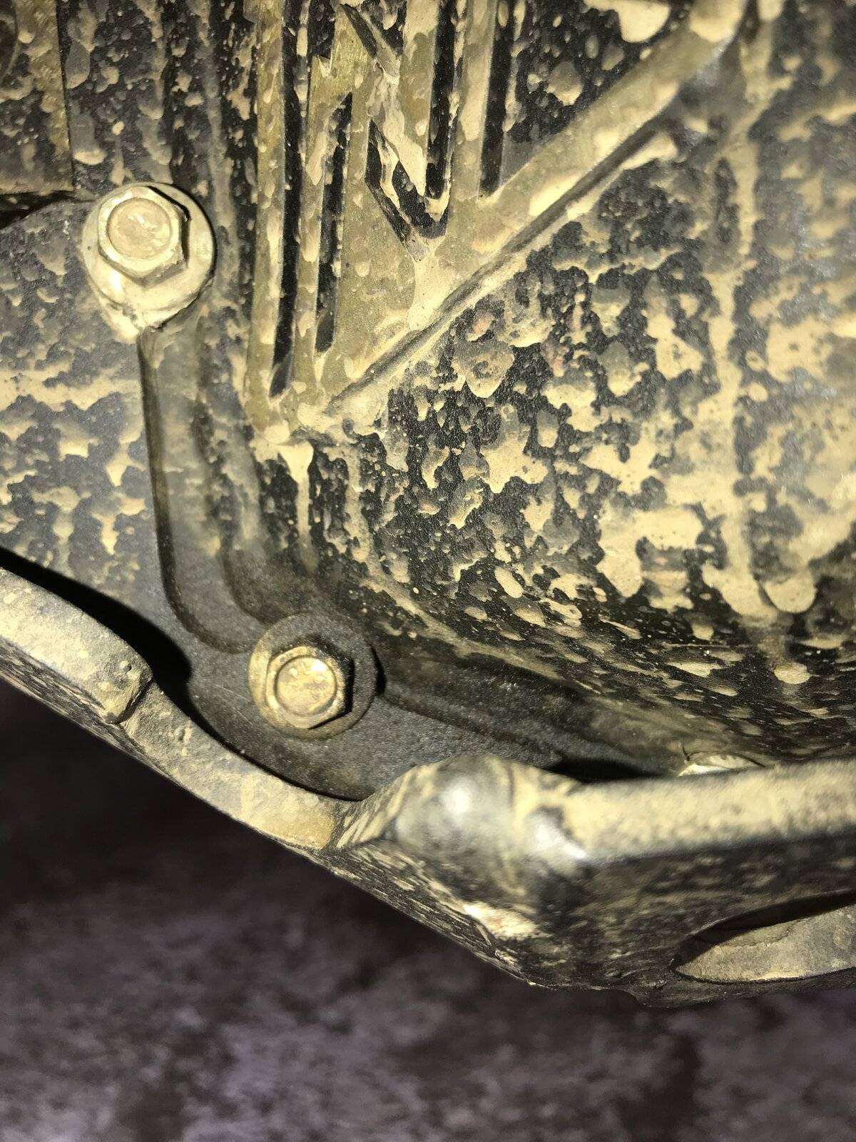

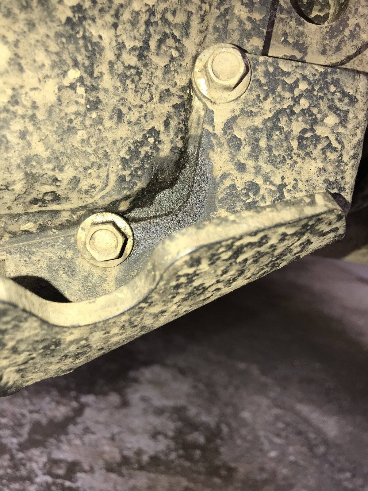

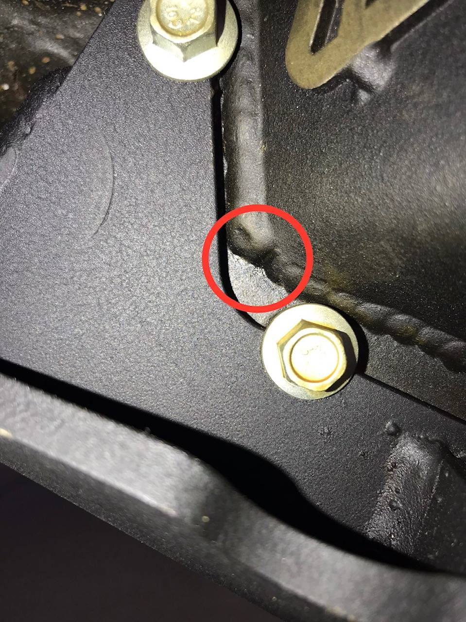

Check your NV Diff Covers!
Both my front & rear covers leaking oil through the powder coating. Poor quality welds, or lack of proper overlapping at the corners. Warranty replacements on the way.
