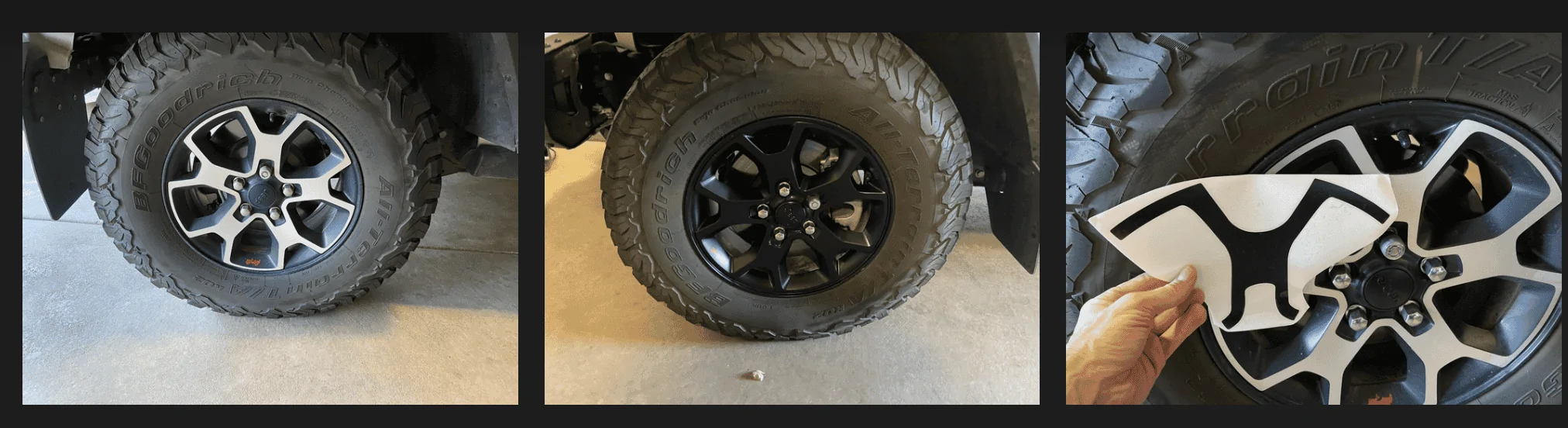

I tried stickers and actually I am very happy with them. Let me live with an all black look to see if I liked it for about $60 off eBay. My 2021 still has them on and I don't plan to change any time soon

I used black stickers to cover the machined areas of my Rubicon wheels and it turned out nice and has been on 3 years no issues. $60 for the kit.
