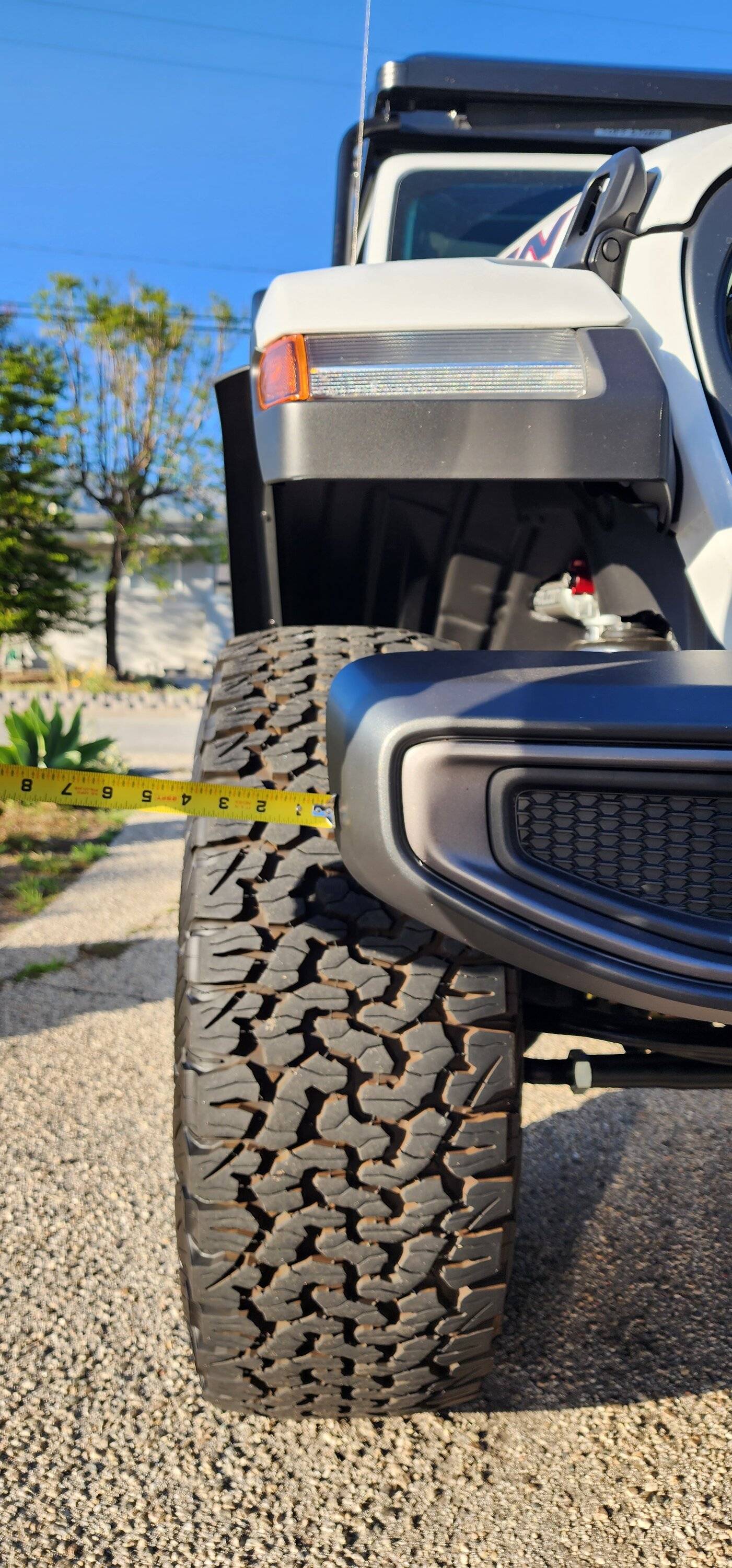

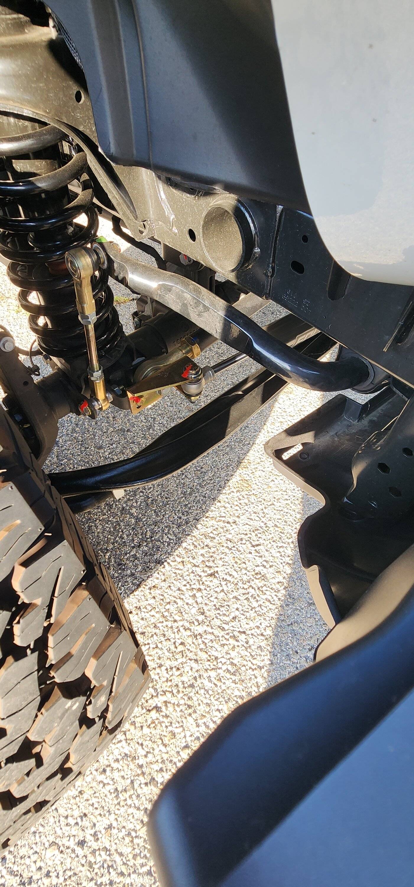

Here's a video I got. Track bar the culprit? Also attached some photos of the wheels and it seems to be off, may be causing the floating/wandering feeling?

Just my 2 cents worth, with tie rod flop rarely does the tie rod actually jump unless the ends are smoked. Like you mentioned, I would check the steering stabilizer and look for any witness marks on all of the steering components. Why would a shop that did an alignment let it leave with the axle fo far from being centered. Take something like a long level or scrap metal and let that hit the top and bottom of tire and measure to the same place on both sides to get an accurate measurement, at least you don`t have to get under the Jeep to measure it

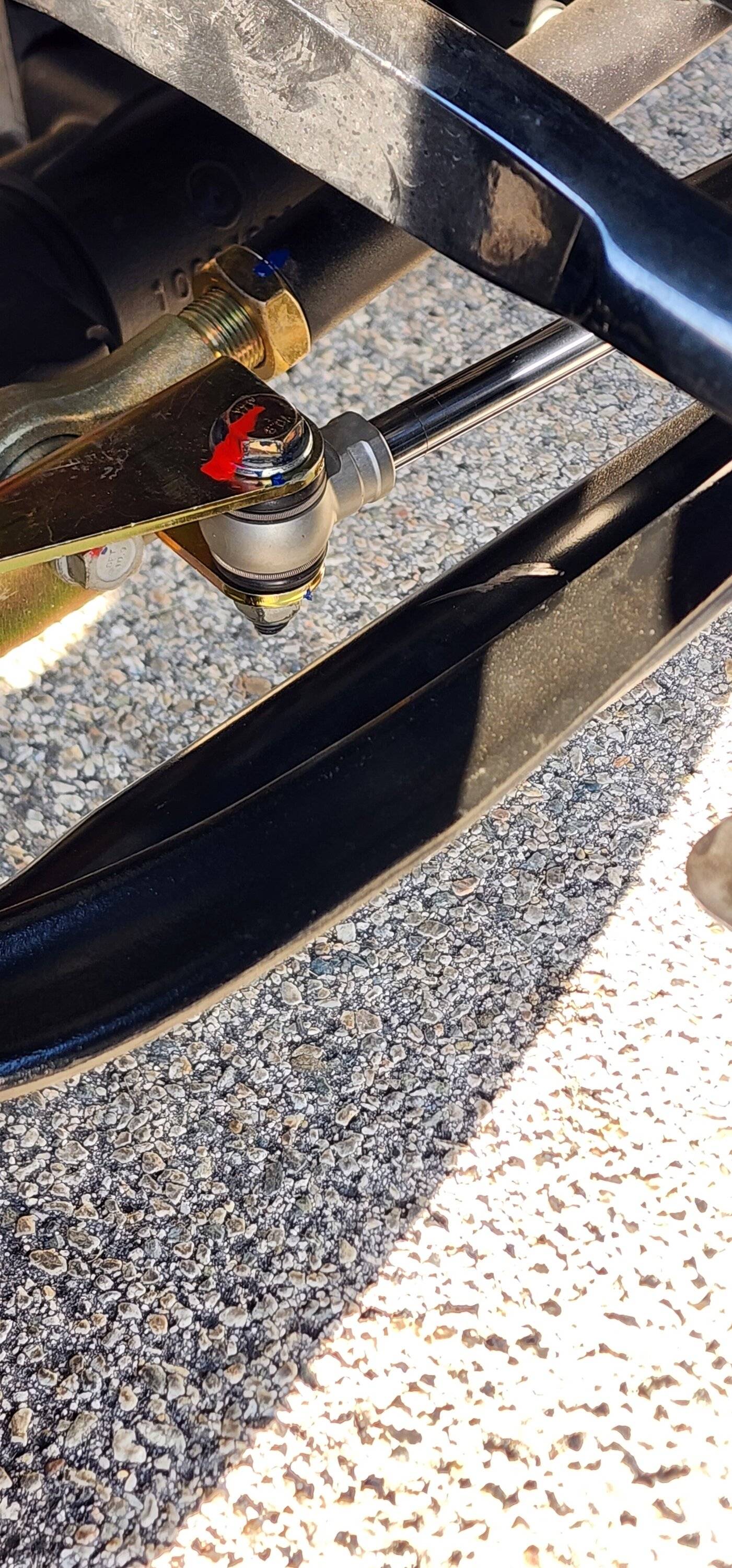

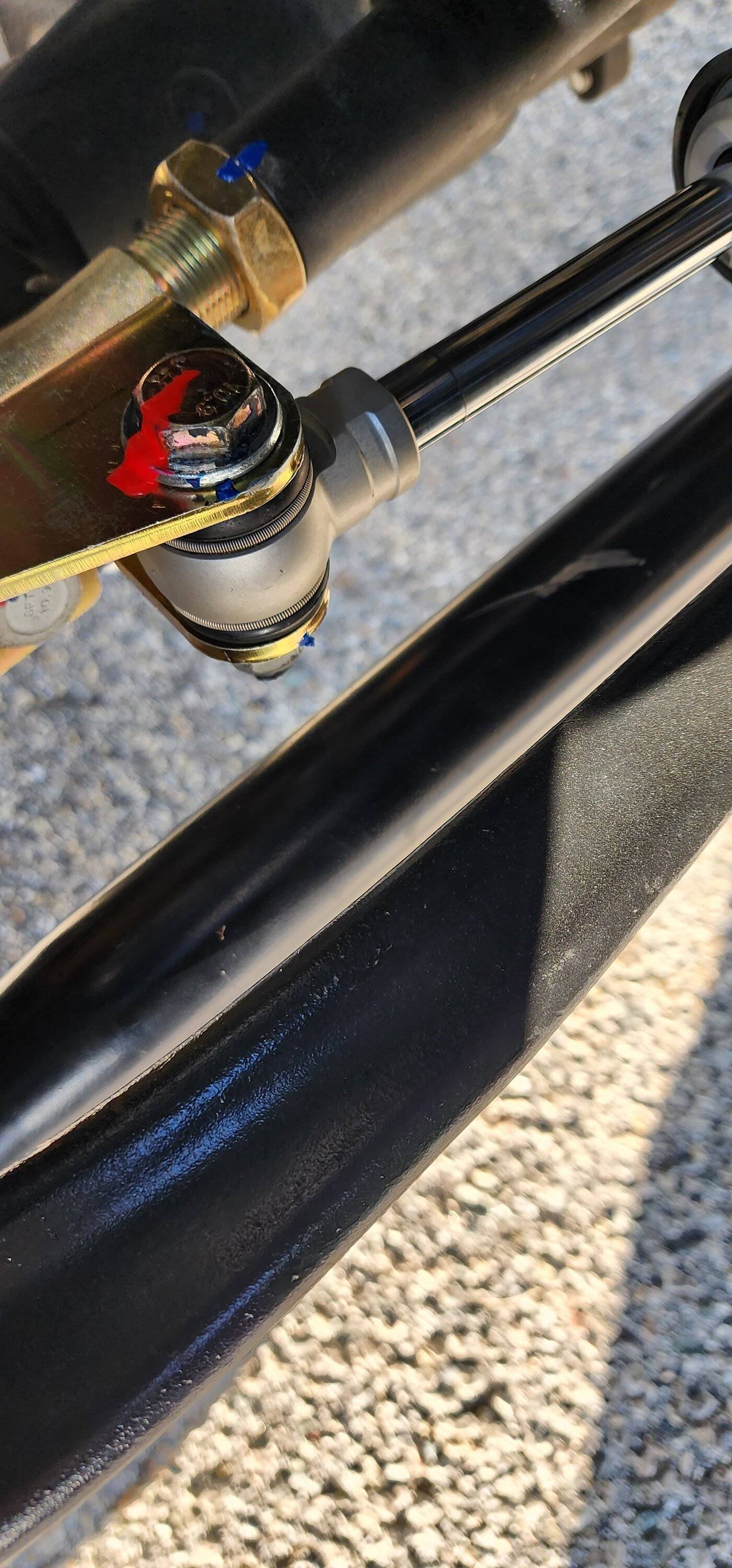

I just noticed these scuff marks. Looks like that one bolt is scraping it. ??

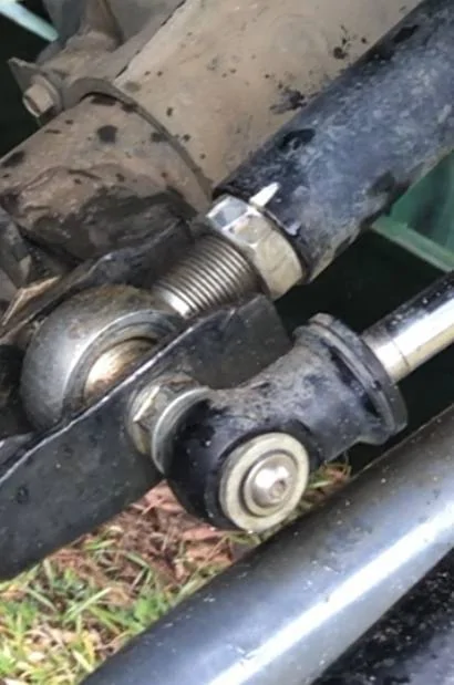

Try putting the bolt in the ss the other way ( the head of the bolt on the bottom) and see if it clears…..if it still hits, then consider using the synergy track bar/ss bolt like this……
