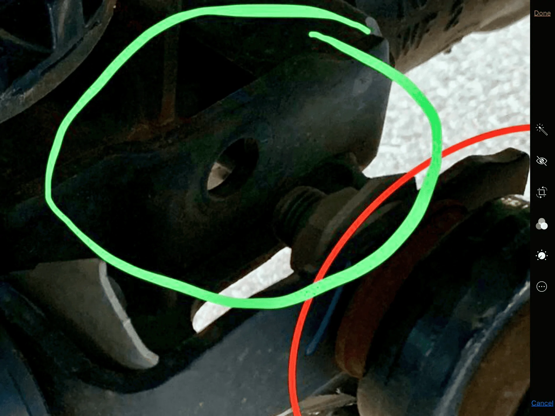

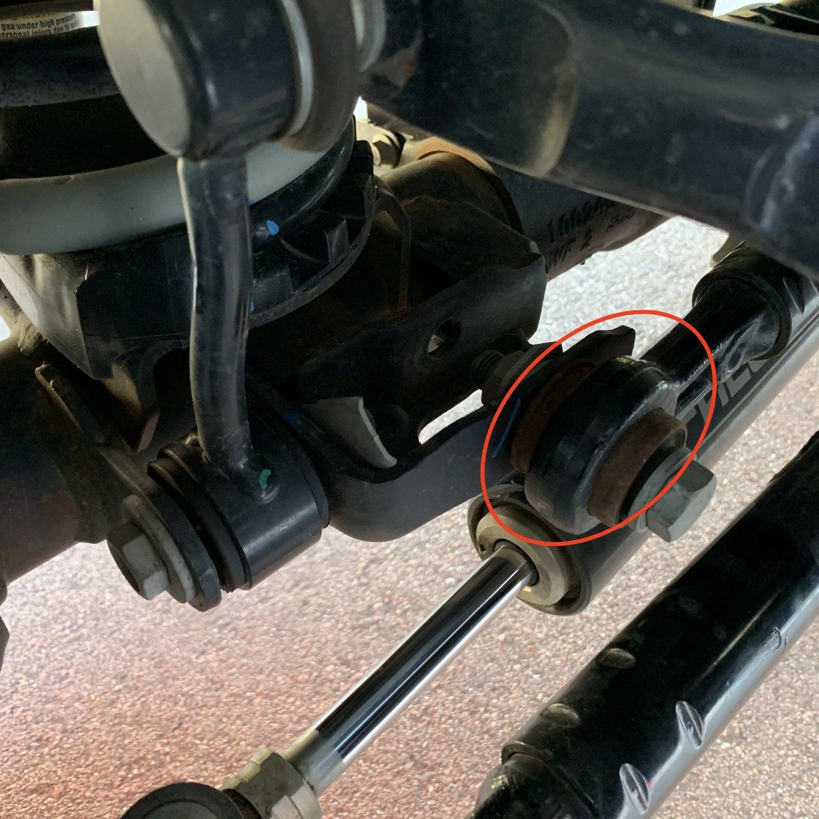

    It's not mounted in double shear....i.e., the joint should be BETWEEN the two ears. Good God...how in the fuck did that leave the factory OR multiple dealers like that?????

    You sure it wasn’t moved when the steering stabilizer swapped?
    I can’t see it leaving the factory like this but that might just be giving FCA too much credit....

    Yeah on the stabilizer install I didn't have move the trackbar. If I had screwed it up I would have swallowed my pride and just not posted anything about it.
    What irritates me is getting it inspected by the dealership and nobody seeing it. Seems like they are used to writing off the steering stuff because it is a common complaint that doesn’t seem to have a definitive solution. Then they come up with bs to give customers about how mt models have looser steering.. I know dealers are hit and miss but I think they wanted me out the door and didn’t give it the time of day.

    Evidently the assembler that normally does the front steering components was obviously absent or on vacation and had fill in .

    Normally the next assembler installing components checks previous installer work and so on .

    The first dealership said it drove normally without inspecting it, the second one said they did a full inspection on it and even re-torqued some components down.

    This does not surprise me at all. My JL's loose steering problems were fixed by tightening the finger tight ball joint nuts and 50% loose track bar bolts, drag link bolts, etc. Several people have reported this exact same loose steering component fasteners in the other main steering thread on this website. Even one of of the Star Bulletins says to check steering component torque specs, so FCA is aware of the loose parts issue, but no mention about the track bar being installed outside of the bracket. There are two different videos of Chrysler factory employees smoking weed and drinking beer at lunch on YouTube. Search YouTube and you will find the video evidence provided by a news station. This would explain the lack of quality on the factory line.
