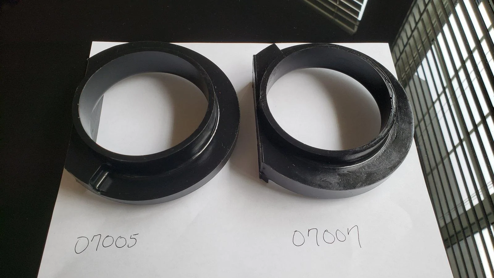

I got the pads and I wish I could say it has been a positive experience but it has not. So I ordered part# 61003 "Alloy Front Spring Isolators Mopar". Now to my understanding these should replace the isolators that come with the Mopar 2.5" JL lift kit. However, one pad has the correct index point and the other does not. The spring orientation for the mopar coils is the same on both the left and right side, so the index point must be the same on both isolators.
One of them fits both sides (07005) and the other is useless. I've put a ticket in with Alloy USA and hopefully they send me the right one. The one below has the wrong index orientation (yes no matter which side its installed on) . Also, they have no left/right identification that I can see.
I'm glad I checked before I dropped my suspension!

Interesting. I noticed that as well in the pictures and wondered if it was correct or not. Is the thickness the same on both of them? Sorry you have to deal with that!
