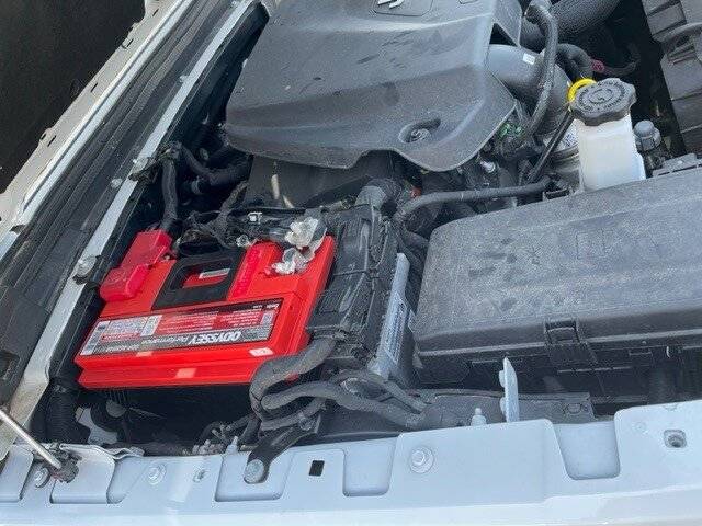

I replaced the factory battery with an Odyssey ODP AGM94R H7 L4 ( https://www.odysseybatteries.com/odyssey/ps94r_850.html ), and the auxiliary battery with an Interstate MTX-AUX12 Premium ( https://www.interstatebatteries.com/products/mtx-aux12/2021-jeep-wrangler-v630l ).

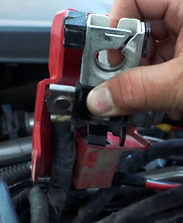

Absolute breeze with the only snag being the pesky plastic clip on the positive main terminal, and a medium flat head screw driver made for an easy release. I definitely recommend this setup as replacements, as they blow the factory specs out of the water. $500 total investment, in my driveway.

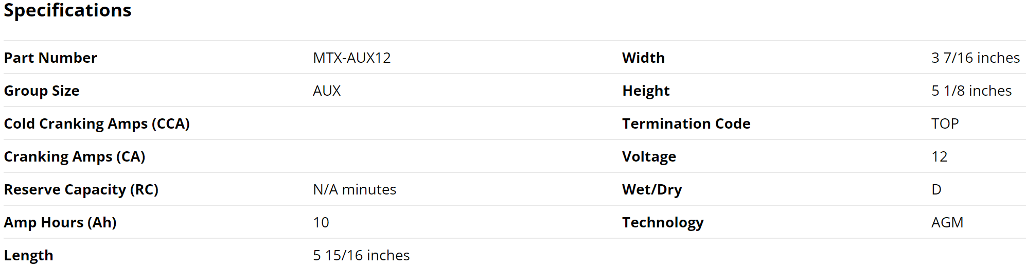

Interstate auxiliary specs:
Jeep Wrangler JL New Odyssey Main & Interstate Auxiliary Batteries 1687633786101

It serves no useful purpose. I broke mine off intentionally. Makes maintenance a lot easier.
For one's own JL/JT, to bastardize something on the vehicle is the owner's preference.. Many prefer not to bastardize unless there is no other way.
Working on someone else's JL /JT, I would never bastardize unless getting the OK from the owner.
Also when I instruct/teach other's, I encourage the right way.
That clip, if you know it is there.... how it clips... takes all of 2 seconds to deal with.... to release.

The clip serves no useful purpose in a mixed use Jeep, I put it back on only because it didn't break when removed. I think most of them do get brittle and break very easily.

Question: Did you have any issue with the extra length of the AGM94R vs the factory battery? According to Odyssey, the replacement battery should be a AGM48. Total length difference looks to be about 1.5", with the 94R being the longer. With the ECM being there, it seems like it could be tight. Thanks....

I think the only issue was you cannot use that factory battery cover

Fit perfect, and so did the battery cover. It actually wasn't tight at all, they leave extra room in the tray for "sliding the battery into place".
