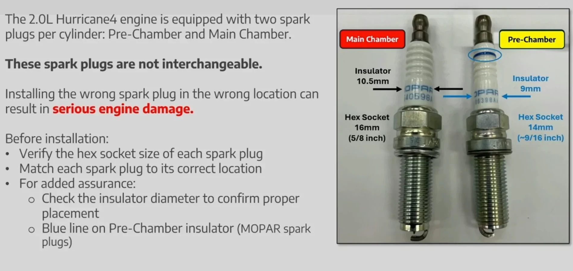

The engineers did everything except the one simple thing that should have been done: a different thread pitch for each plug.
Those look like different thread pitches to me. Also, you could only remove and replace the main chamber before removing/replacing the pre-chamber plugs to avoid inadvertently mixing them up.
Jeep Wrangler JL New Jeep 2.0T Hurricane 4 has complex tech [Engineering Explained] 1774271129374-86
Are we looking at two different pictures? Those are the exact same size and pitch of threads. And it's a matter of when, not if, for even a dealer technician to put 8 pre-chamber plugs in an engine.

I could see it being a 12mm, good call, especially when you see the size of the pre-chamber.
If this is a doctored photo the sonofabitch that did it was successful in stirring up a lot of shite.
No, it's not doctored.
Do you have the plug in front of you so you can definitely make sure of the difference?
Does anyone?
The one on the right looks like a slightly shorter pitch between threads to me. Either way there are procedures that can be used to mitigate the chance of error.
