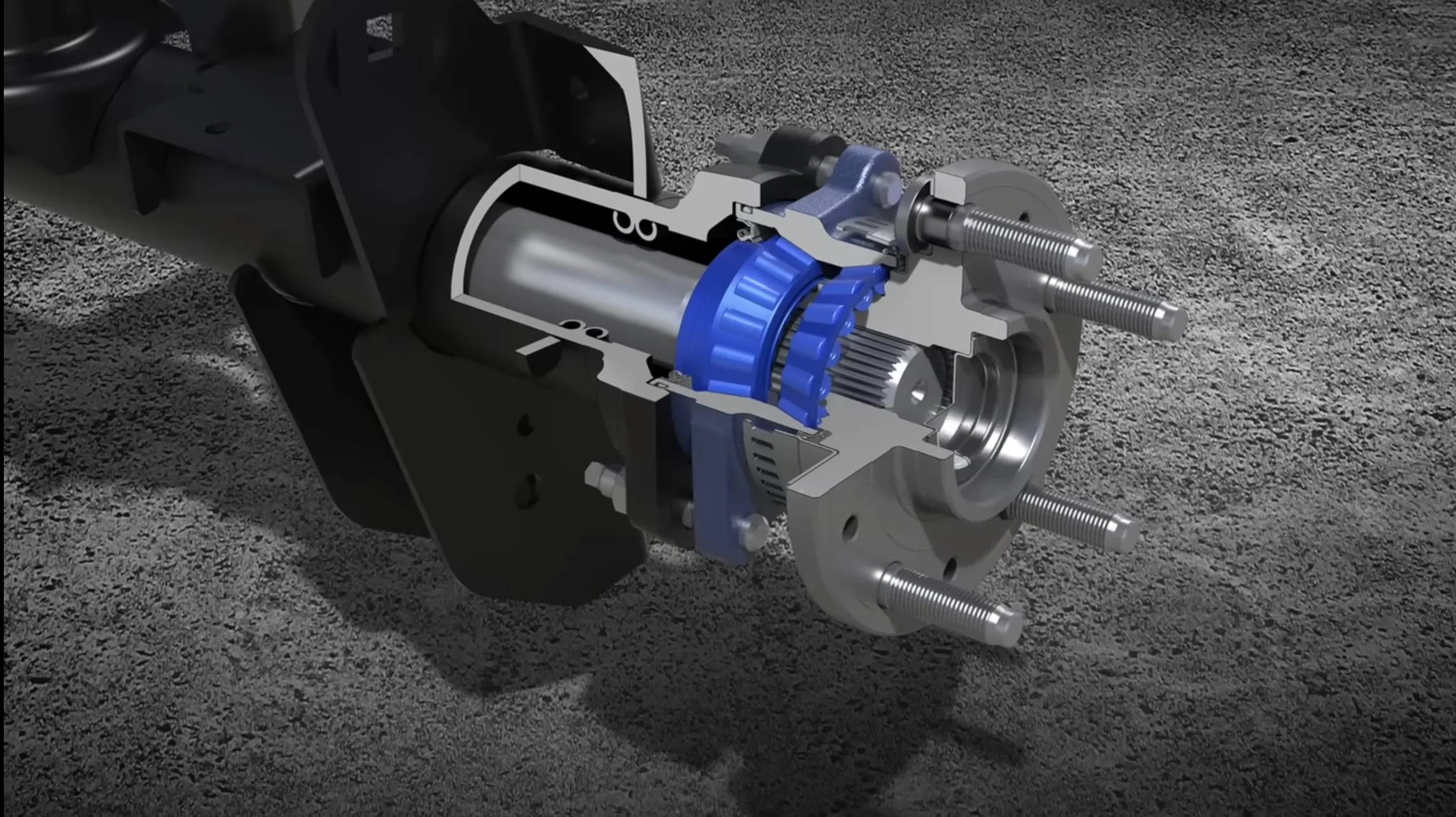

Screenshot from one of the youtubers giving details on the '24s.
Jeep Wrangler JL New HD Dana 44 full float axles IMG_5875

From the cross sectional view, it looks possible.
