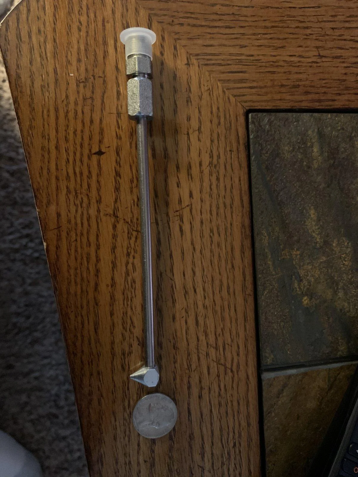

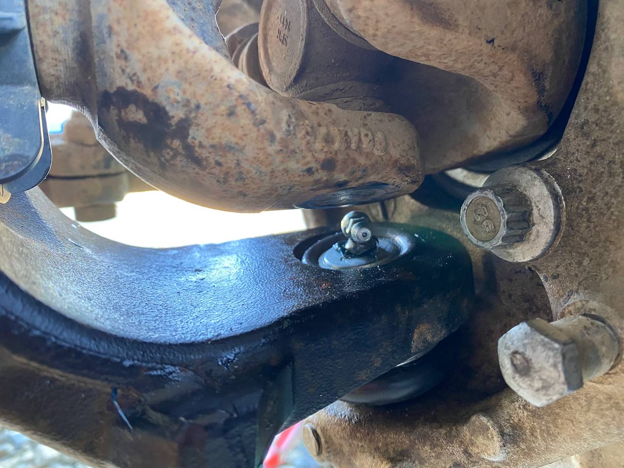

I know a few people have replaced the ball joints with the new Dana HD joints. You can grease them but the lower is difficult to get with the shaft in. I found this grease gun adapter at a airplane mechanical supply shop. It fits in between the shaft and lower joint. I will try to post a link to the site later. It was about $20.
