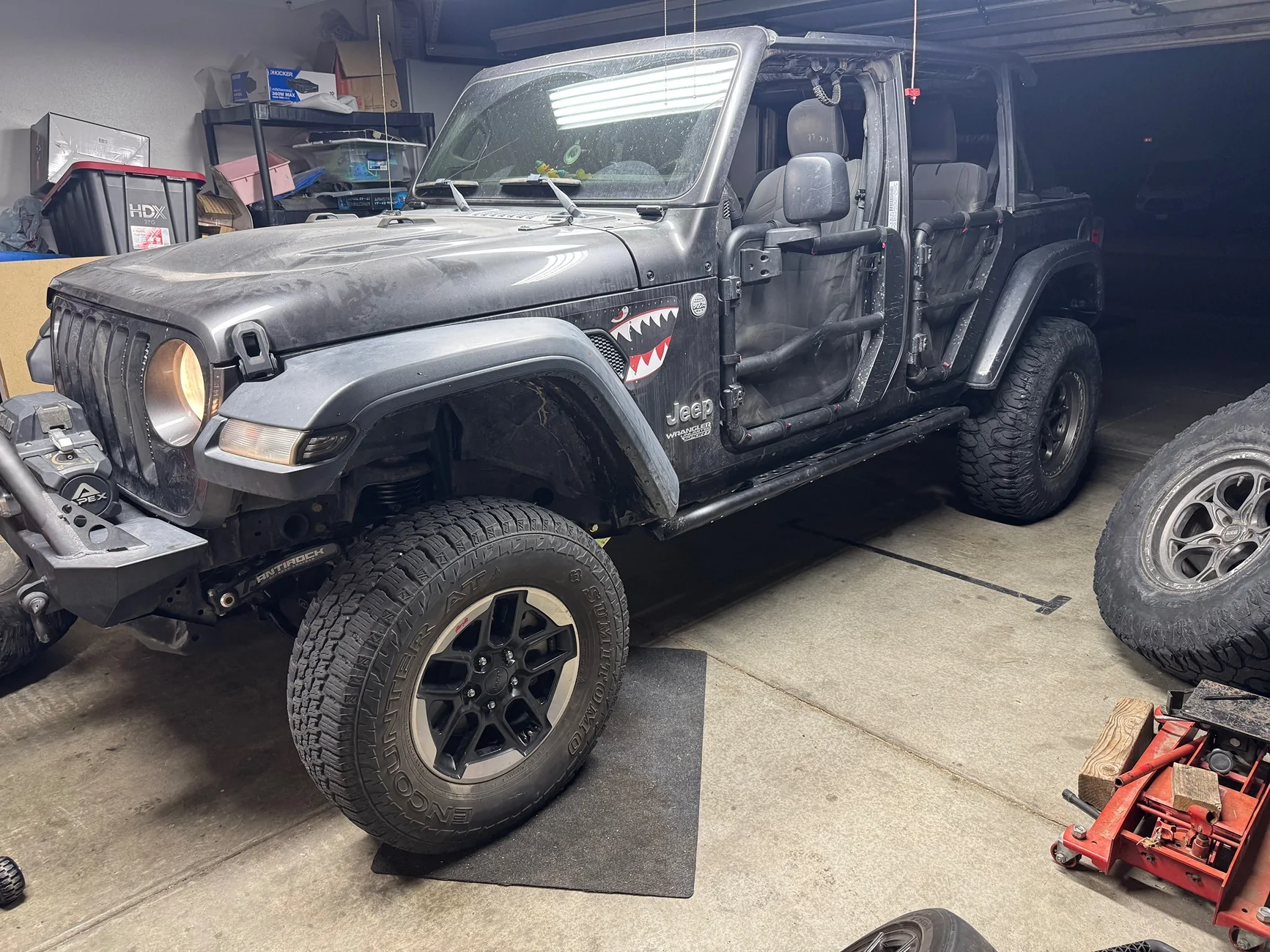

Well, i didnt have available help this evening to test the ball joints. I did grab a 2’ pry bar and try to see if i could feel any movement by myself, no such luck.
so….. i decided to give chat gpt’s advice a try lol. I had loaded up some pics of my front tires (very well worn Patagonias). Chat got said it believes that to be the most likely cause. So i grabbed a oair of still decent 33s i have in the backyard and tossed them on the front. I proceeded to drive to the nearby DW bridge looking like some kind of Hot Wheels jeep dragster to see what happens……and…….nothing happened. No death wobble lol. Nice and smooth.
i gotta get off my ass and go gave my new 37” tires put on and try it again.
Tomorrow ill have to pull the jerp out and take a pic of the jerpster in the daylight lol

Measure your caster at the case spreader holes . Minus the floor. Odd your floor would be 0.0 flat .
Get the angle up to 6 degrees. Your steering wheel should center itself after making a turn if you caster is right . If center feels vague then you likely dont have enough angle back. 3.5 springs requir longer lower arms. Top ones can remain stock. Mopar ones arent enough. You need 3/16 to a 1/4” more length. If you jeep drifts one way or the other when braking you may need to adjust that lower arm out one full turn. ( 16th of an inch)
After all this you can almost drive without a steering stabilizer . Adding brackets can add bumpsteer. Throuws off the geometry in other ways. Try reducing steering stabilizer dampening to reduce the steering wheel from bumping so hard. .

That angle finder pic i posted is sitting on the case spreader. Ill put the angle on the floor but i doubt it is much. I wont be able to make any real adjustments till i get my new MC control arms after Memorial Day. My steering stabilizer is the non-adjustable fox ts.
The jeep doesnt drift at all. Never has.
thank you for your input. I do appreciate it.
ill put my new tires on this weekend and see how it is.
im just glad i can pilut off of the balljoints for a while, maybe BF. Right now i need to get the front control arms and rcv axles (leaking cv boot). Eventually an MC tie rod…
By next week, i will have put as much into this jeep as carvana says my jeep is worth :facepalm:
