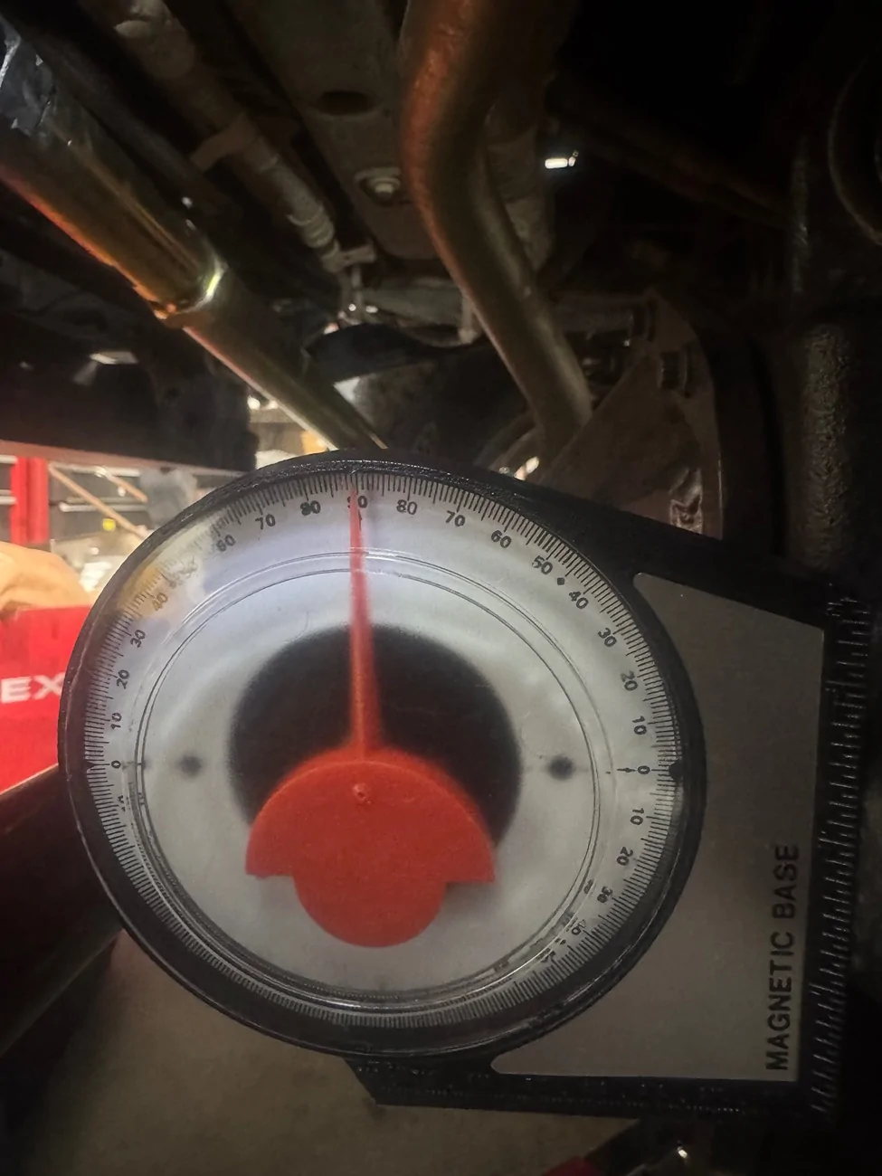

Measure your caster at the case spreader holes . Minus the floor. Odd your floor would be 0.0 flat .
Get the angle up to 6 degrees. Your steering wheel should center itself after making a turn if you caster is right . If center feels vague then you likely dont have enough angle back. 3.5 springs requir longer lower arms. Top ones can remain stock. Mopar ones arent enough. You need 3/16 to a 1/4” more length. If you jeep drifts one way or the other when braking you may need to adjust that lower arm out one full turn. ( 16th of an inch)
After all this you can almost drive without a steering stabilizer . Adding brackets can add bumpsteer. Throuws off the geometry in other ways. Try reducing steering stabilizer dampening to reduce the steering wheel from bumping so hard. .

That angle finder pic i posted is sitting on the case spreader. Ill put the angle on the floor but i doubt it is much. I wont be able to make any real adjustments till i get my new MC control arms after Memorial Day. My steering stabilizer is the non-adjustable fox ts.
