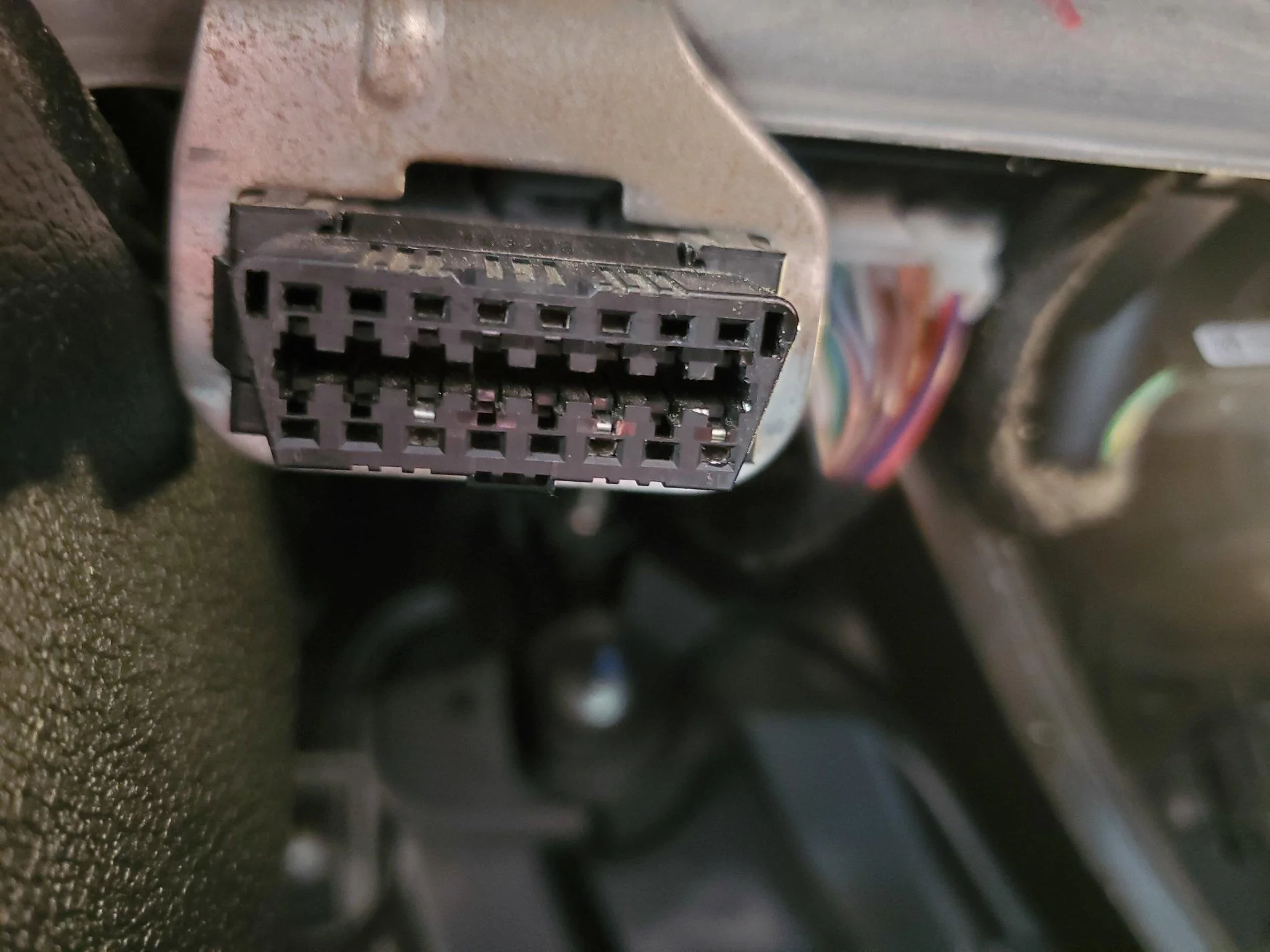

Ok, I removed the tracker and the Jeep was fine going back and forth a few feet. The tracker wasn't connected to anything else, just the OBD2 port. They hid the main body of the tracker behind the kick panel, that's where the blue sheath was going.
I just unplugged the tracker from the OBD2 port, and put the stock port back in its bracket.
My question now is this: looking at the stock OBD2 port, I see only a few metal pins shining there. Is this normal? Shouldn't they all have metal pins?

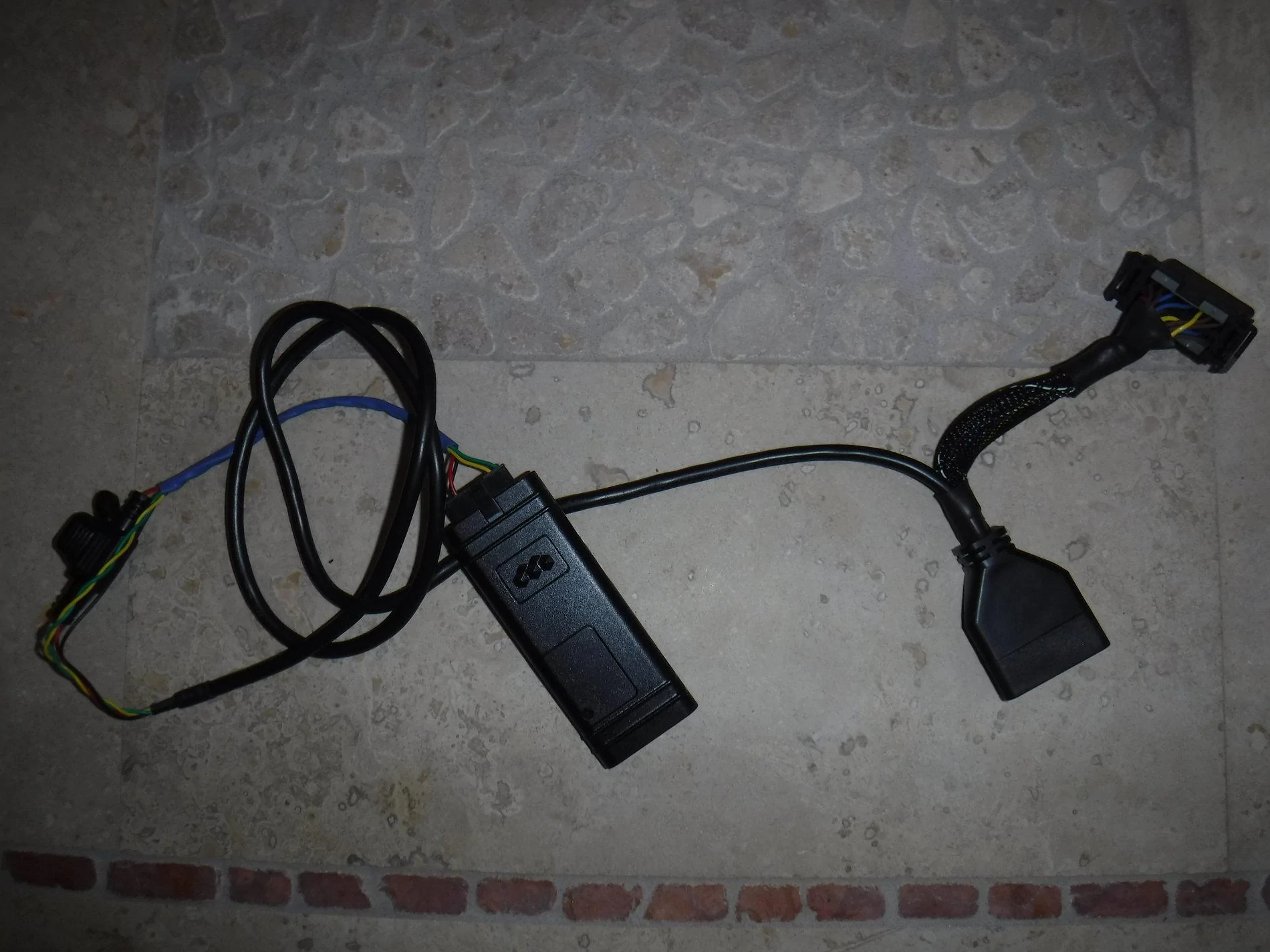

And this is the tracker I removed

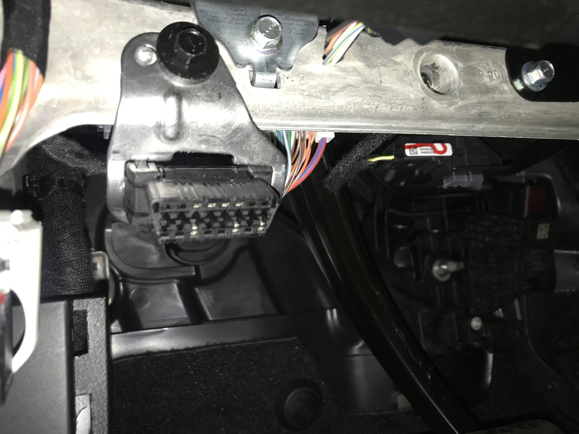

Mine looks the same
Thanks! I was getting paranoid that the dealer did something with that as well...
Just drove the Jeep 50 miles with no issues. I'm extremely happy I don't have to go back to the friendly dealer.
